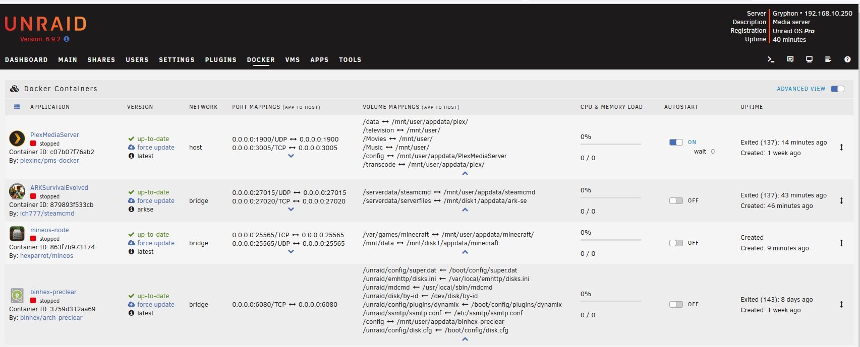

As for dockers paths specifying cache, i don't think i have any that are pointing to the cache. All of the options appear to be pointing to
/mnt/user/appdata/plex
/mnt/user/appdata/steamcmd
/mnt/user
/mnt/disk1/appdata/ark-se
the Mineos is pointing to /mnt/cache/minecraft, but it was stopped when the issues happened.

Make sure you check all the host paths. Turn on Advanced View on the Docker page and click the down arrow of each of the Volume Mappings listings to expand them.
I have already directed that one to a disk location. Including image. wont know for a couple days if the rootfs issue is solved.
