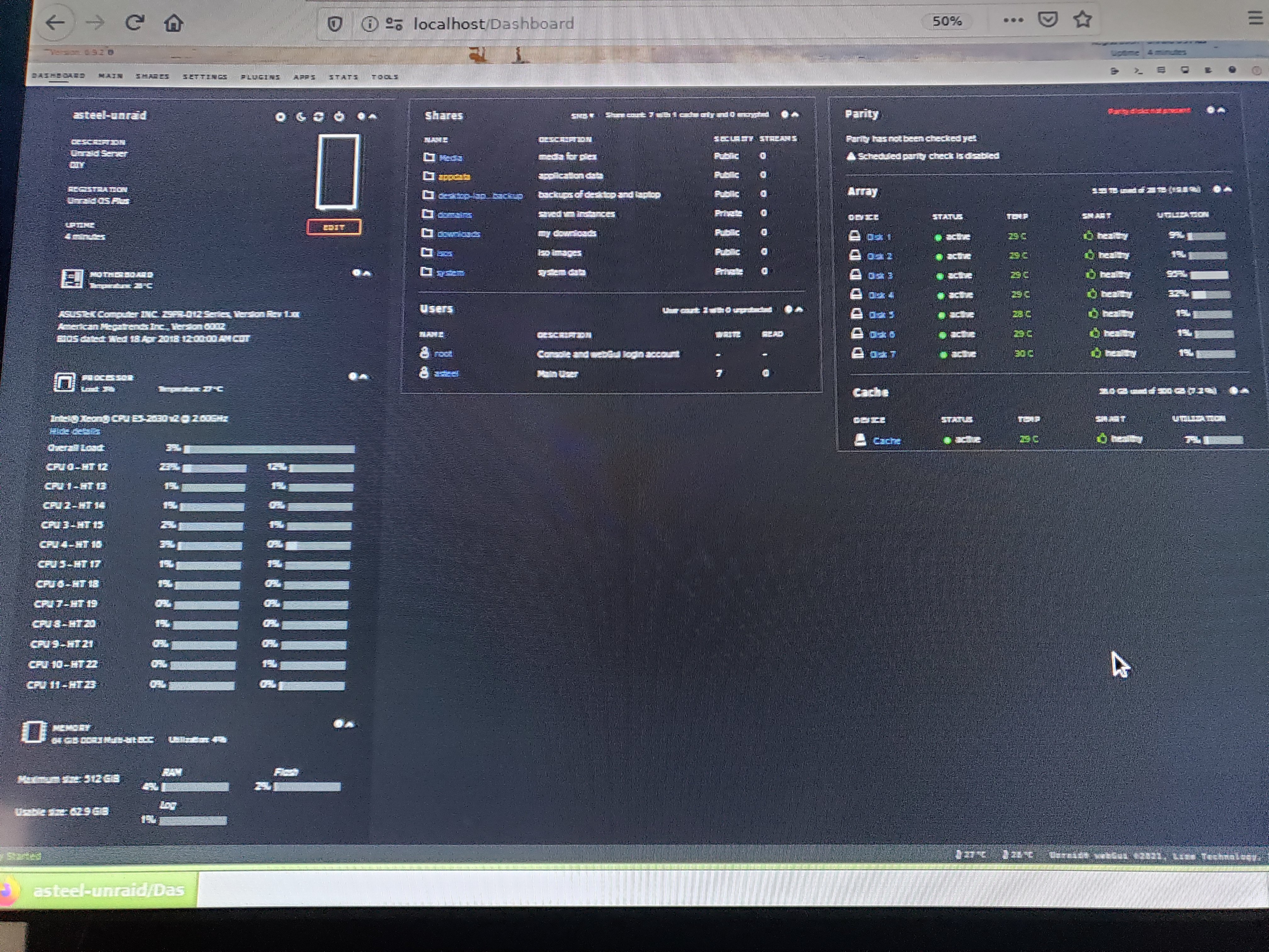

September 11, 20215 yr Author The only way I can access my unraid is via unraid os gui mode. So... I do have some access to it and it does run via this method... but I cannot do anything since it has no network connection. FYI this was all working perfectly until about 3 weeks ago. I have no idea what changed but I just tried to log in one day and it didn't work.

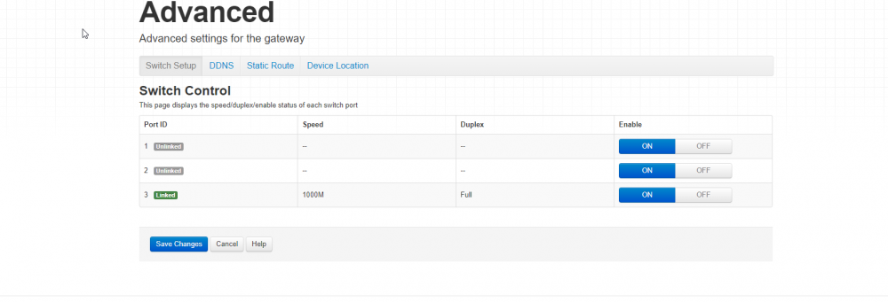

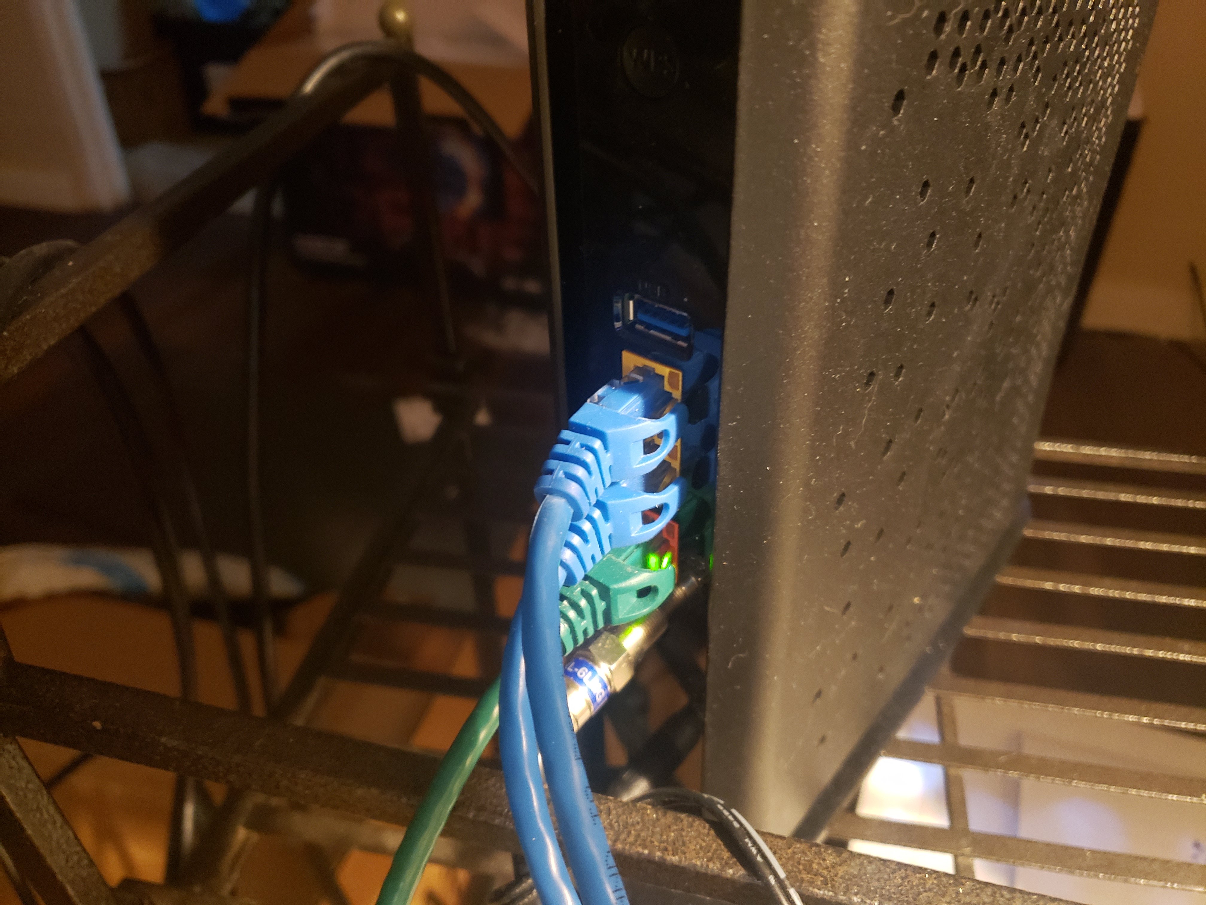

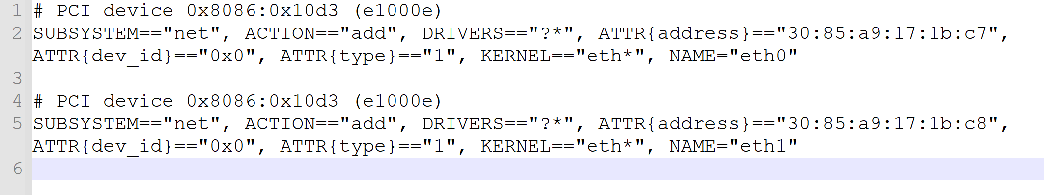

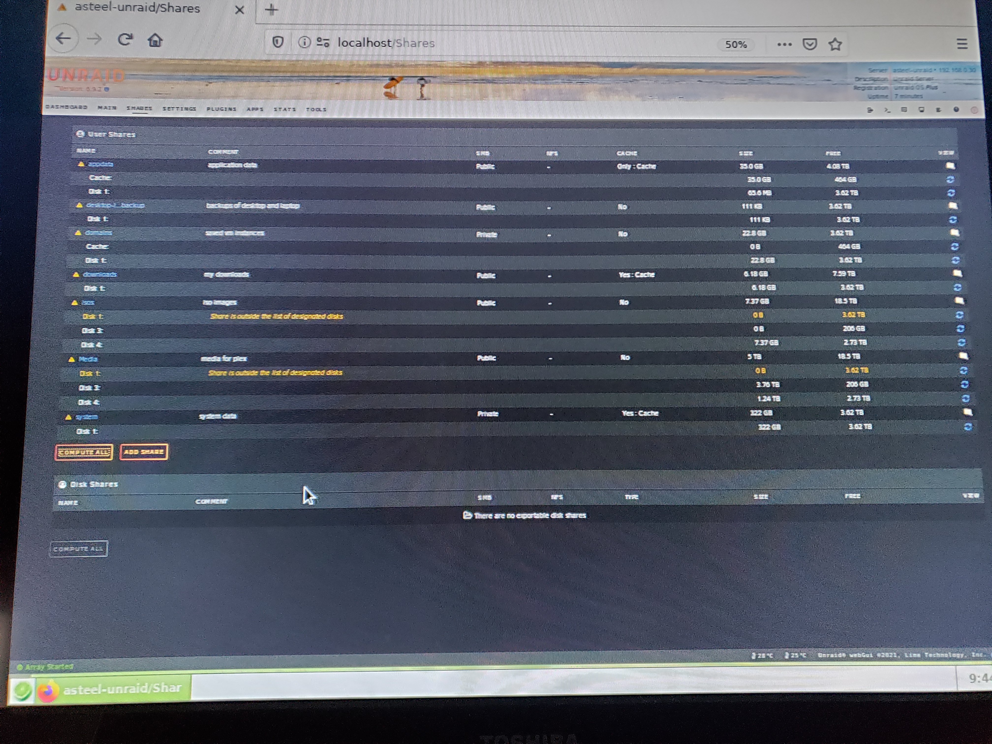

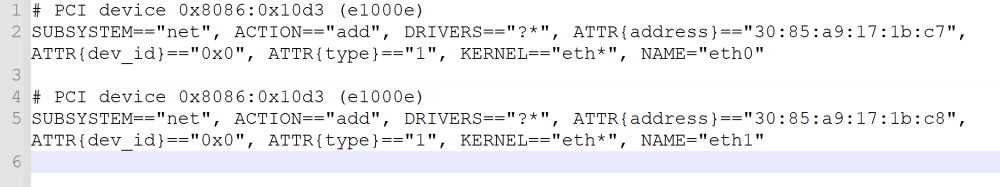

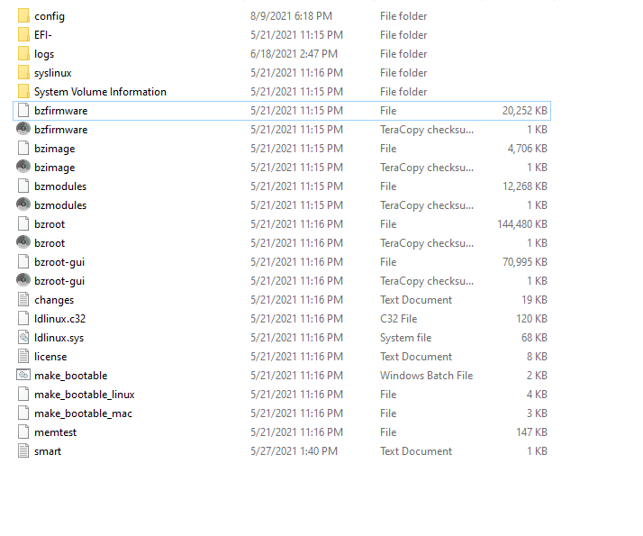

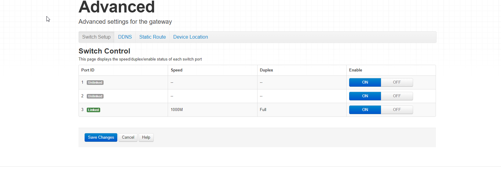

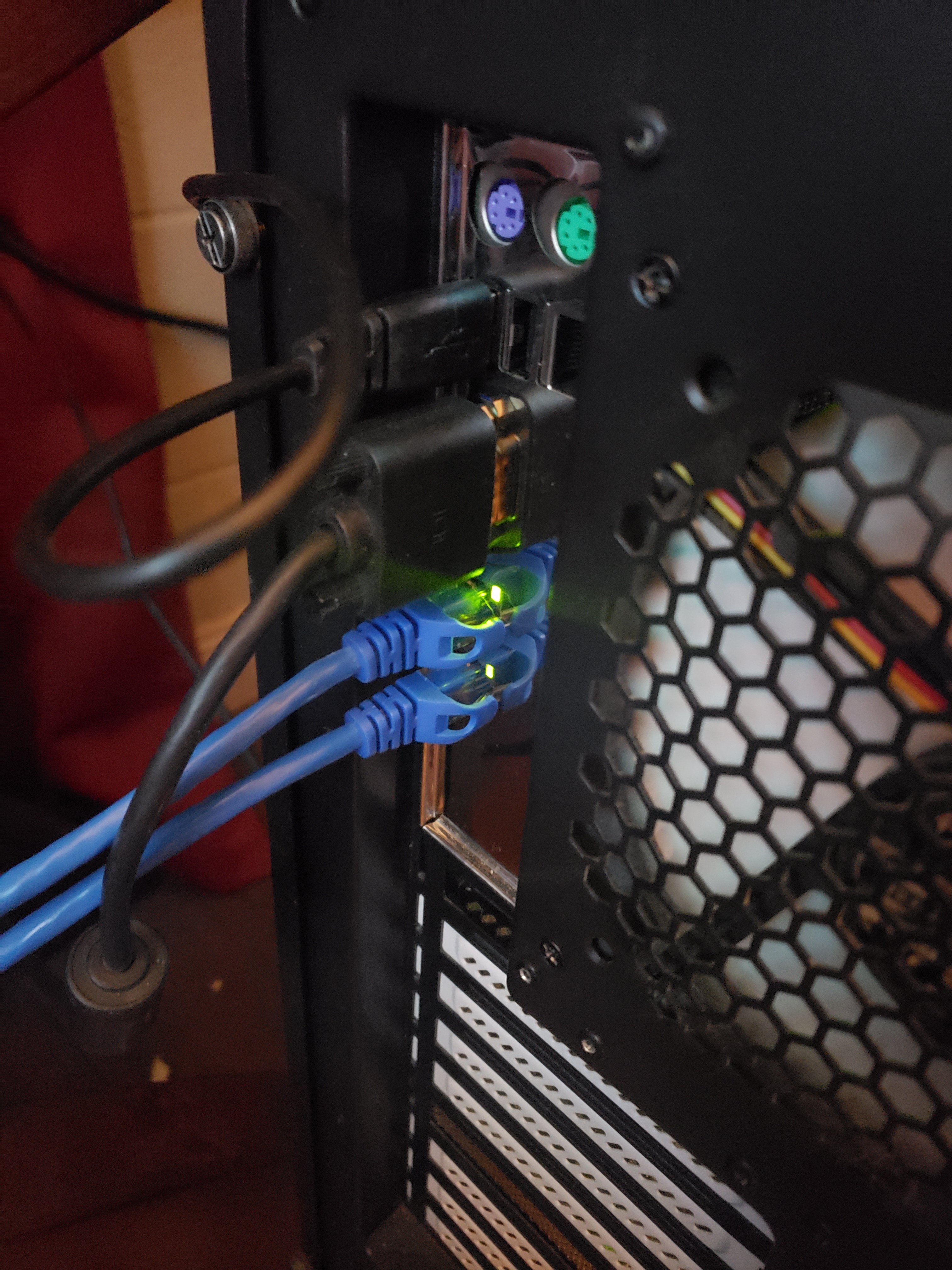

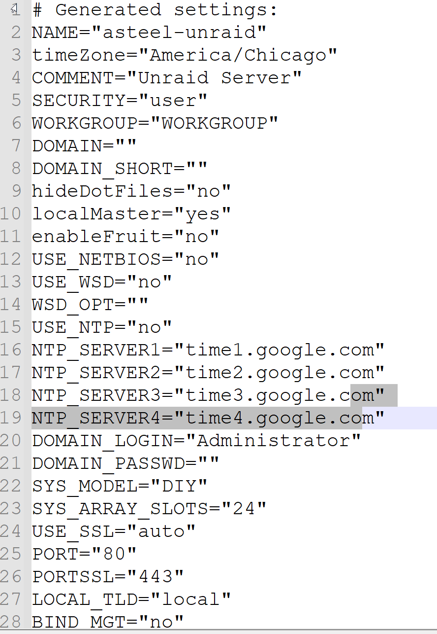

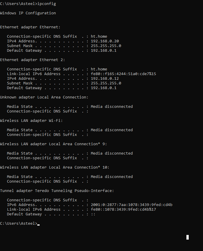

September 11, 20215 yr Author The first one is my pc config and it is connected perfectly.... The second and third pic are the connected lan cables that work with no problems used on other devices. The next few pictures are from config files. I am so lost and... sick... all I want to do is enjoy my plex movies while I am in bed sick. Thank you, Asteel

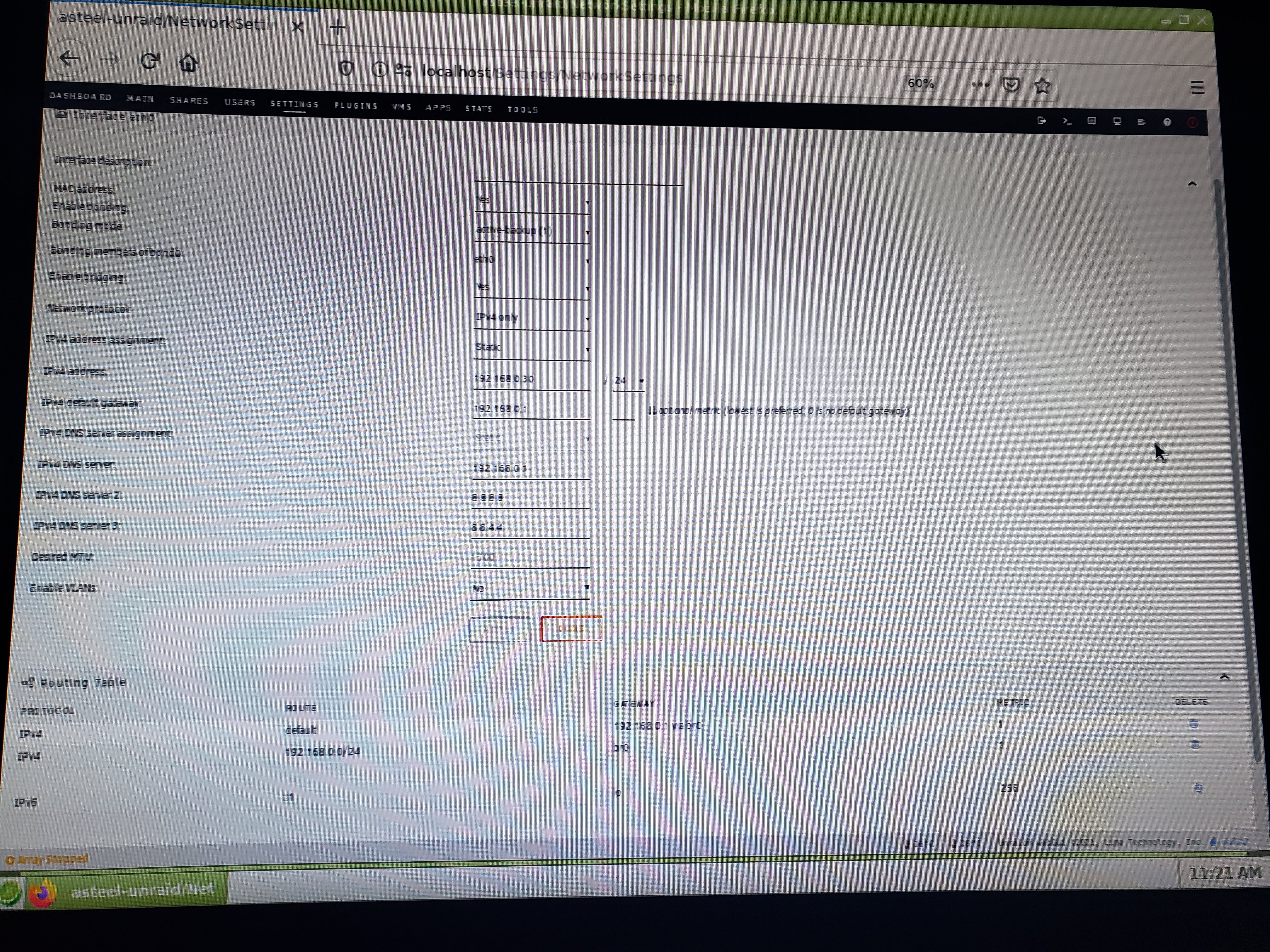

September 11, 20215 yr Author this is what my network is popping up like on this new usb... still not connecting to anything. could it be my issue lies with the pci device config files?

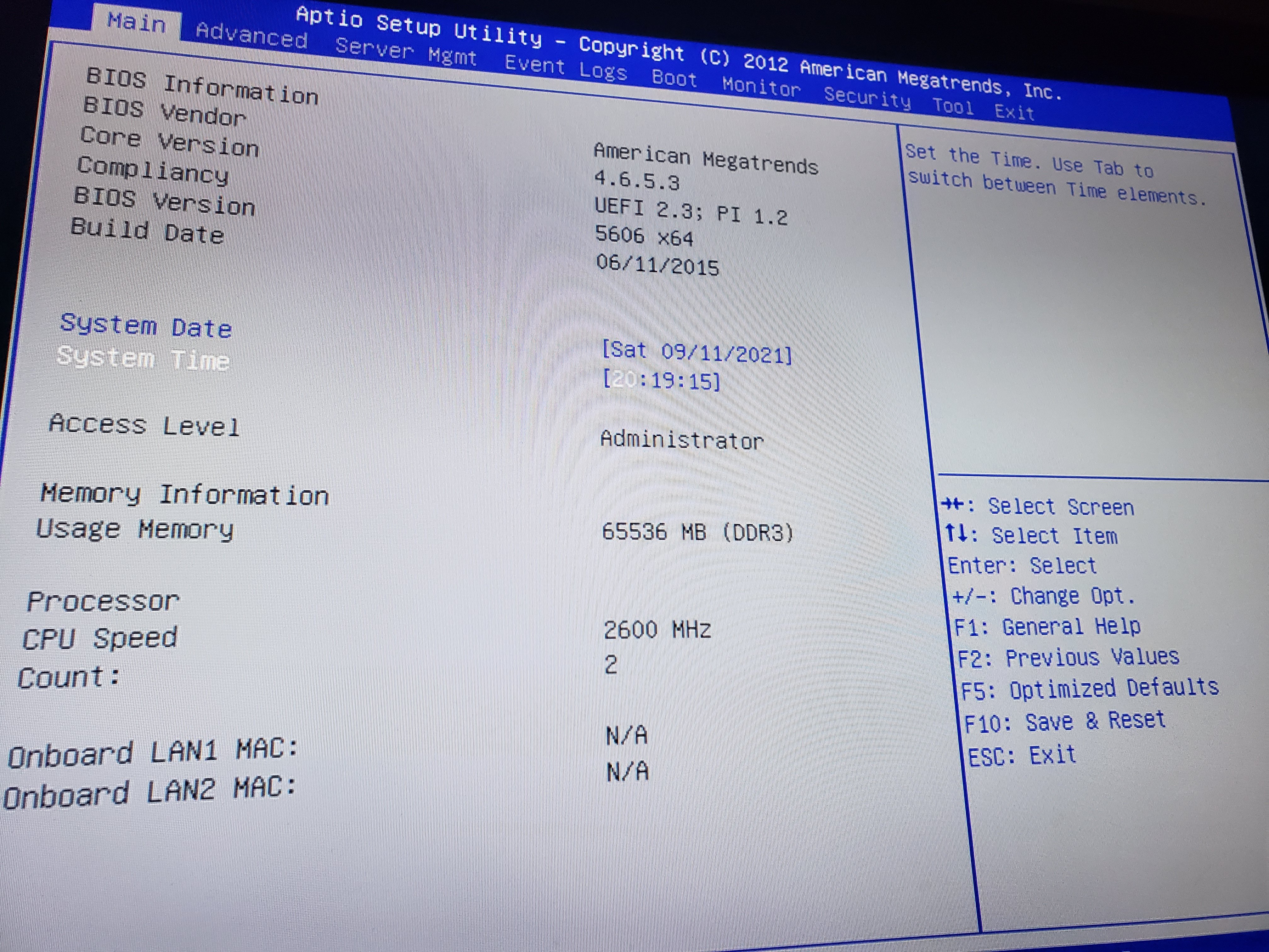

September 11, 20215 yr Community Expert I don't see any ethernet device in lspci in your diagnostics. Are you sure you don't have it disabled in BIOS?

September 11, 20215 yr Author 11 minutes ago, trurl said: I don't see any ethernet device in lspci in your diagnostics. Are you sure you don't have it disabled in BIOS? I will check right now
September 11, 20215 yr Community Expert What @trurl is saying is that Unraid has not detected a Network adapter during the boot process. Without such a device being present, you can not establish a connection to the RJ-45 cable that you are plugging in. (The only reason to disable a NIC (Network Interface Card) in the BIOS is if you have such a card plugged into a PCI slot.)
September 11, 20215 yr Author I understand what your saying now. This is silly do you think i just need to do the Asus easy update thing for my motherboard? I know its not an unraid issue now... I'm sorry... SMH at myself

September 12, 20215 yr That's not the issue. The problem is that your BIOS itself doesn't even recognize the NICs, which is way before any driver gets involved. Update the BIOS? Verify there's no way in the manual to disable the NICs via a jumper or something. If the BIOS itself can't recognize the NICs, there's zero chance of any OS recognizing them (and as trurl pointed out Unraid doesn't see the card at all, because the BIOS doesn't)

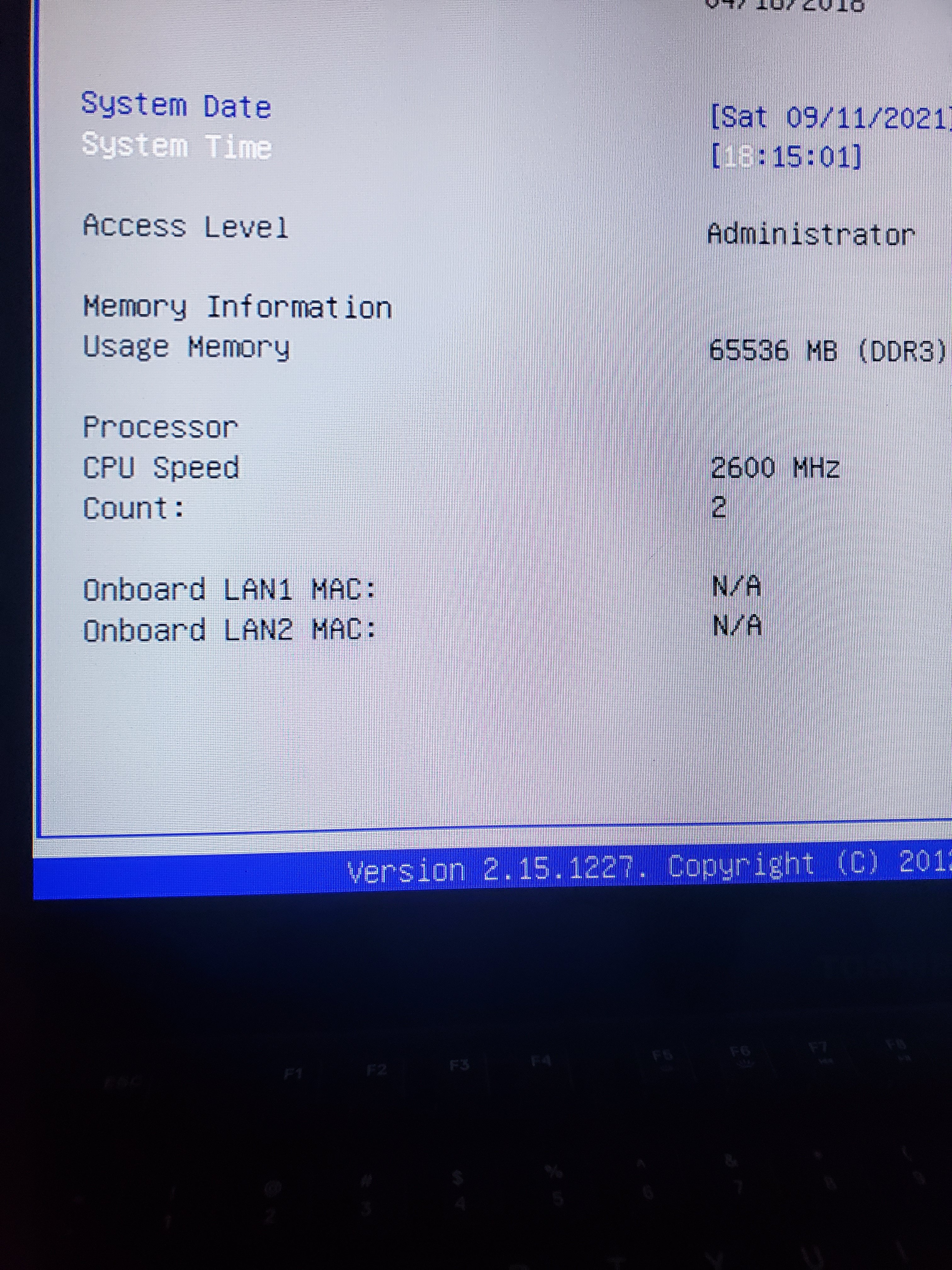

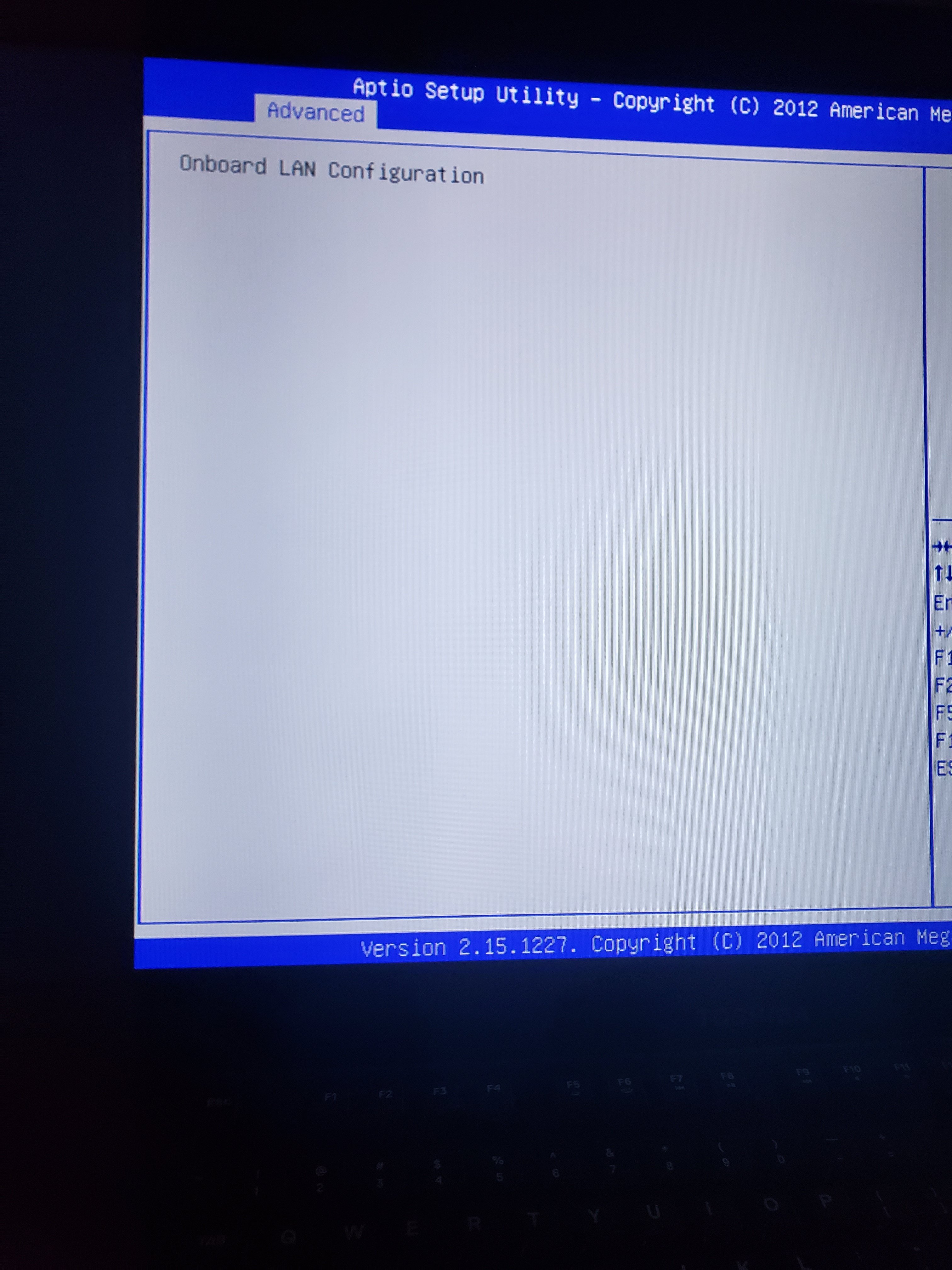

September 12, 20215 yr Community Expert 43 minutes ago, Asteel said: Thank you I will take a look into this. I did update the asus but it also uses american megatrends... I will try to update this What happens if you arrow down to the 'Onboard LAN1 MAC' and enter the <ENTER>. The <+>/<-> keys will probably allow to select the options that the BIOS software provides. (Look at that text box in the lower right of the Screenshot in your post quote in this post for how to navigate the BIOS screen and make changes to its settings!)
September 12, 20215 yr Author It won't allow them to be selected at all. Also under server management the lan section is literally a blank screen so... I think buying a 30 dollar network card was easier than trying to troubleshoot at this point. I am way to sick to try and figure out all of the terminal stuff to update everything. Honestly I'm happy to have a clue what went wrong tbh so thank you guys for helping me solve that... I just have no idea how it occurred.
