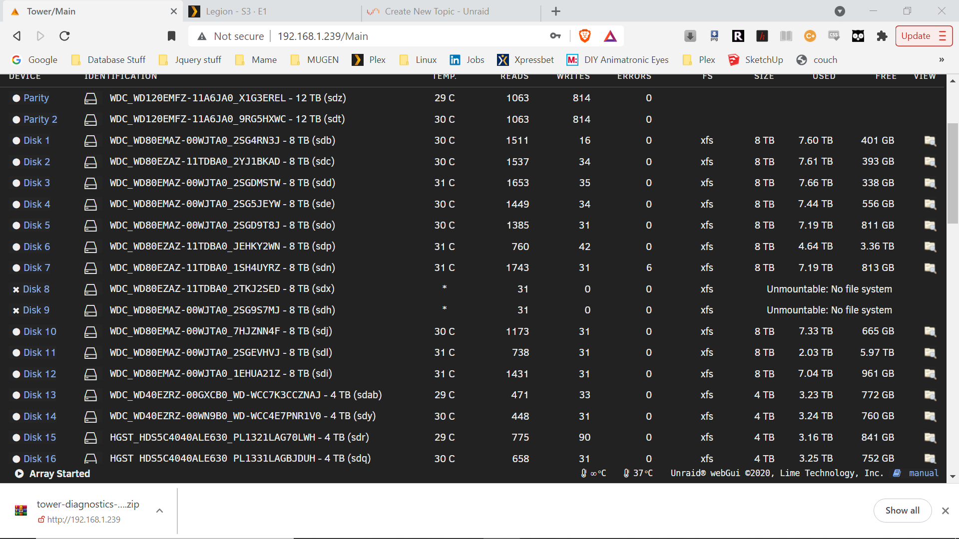

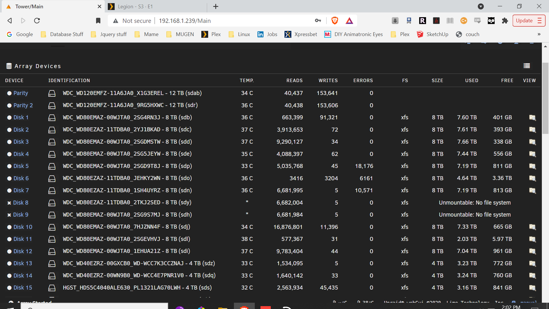

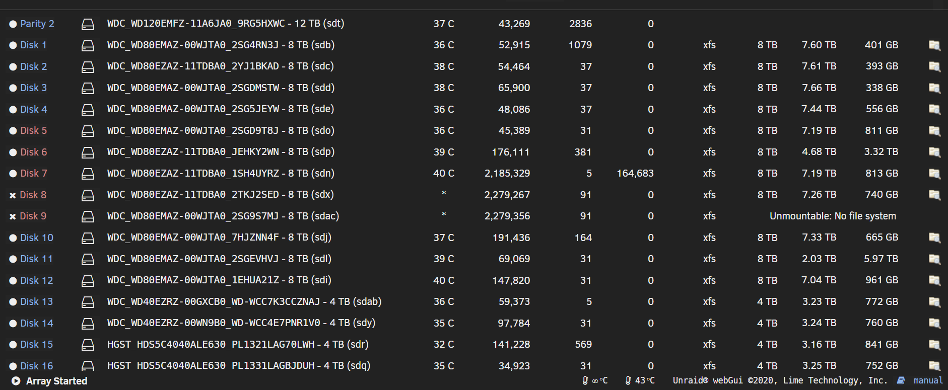

I am trying to figure out what could be causing the errors in my attached screenshot and Diagnostics file. Unraid is telling me I have two unmountable disks. So I did a complete tear down and ensured all connections were solid. Disk 8 and 9 still will not mount and I continue to have errors on others disks. I have attached a screenshot from before (more disk errors) and after a restart after re-securing the cables. Do I have dead drives? Also I noticed that I am several version behind in my Unraid updates should I wait to update until after these issues are resolved.
Thanks for your help as always!
GTP

Not only are they unmountable, they are also disabled. Syslog doesn't show us anything from before the reboot so don't know how you got to this state. You will have to repair the filesystems on both disks, then rebuild them.
You have more disks than I care to examine SMART reports for. Do any of your disks show SMART warnings on the Dashboard page?
Thanks for your reply @trurl. I checked my dashboard and it says all my disks are in Healthy status. I re-ordered cables again because this is not the first time this has occurred. I will also have two empty drive ready tomorrow if I need to replace any. I tried to do a repair on disk 8 but it said fatal error Input/Output. I will reach out tomorrow or the next when the cables arrive and after I have replaced the cables again to see if I am able to repair. Since I will have the disks to replace would you recommend just chucking the disabled disks? I also can't seem to repair disk 6. Thanks for your help, I let my server get in bad shape and I am trying to fix it up again. You have helped me before and I always appreciate it.

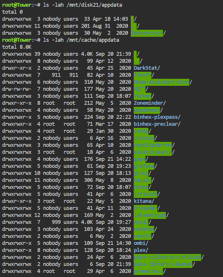

Your appdata share still has some files/folders on disk21.
What do you get from the command line with this?
ls -lah /mnt/disk21/appdata
And this?
ls -lah /mnt/cache/appdata

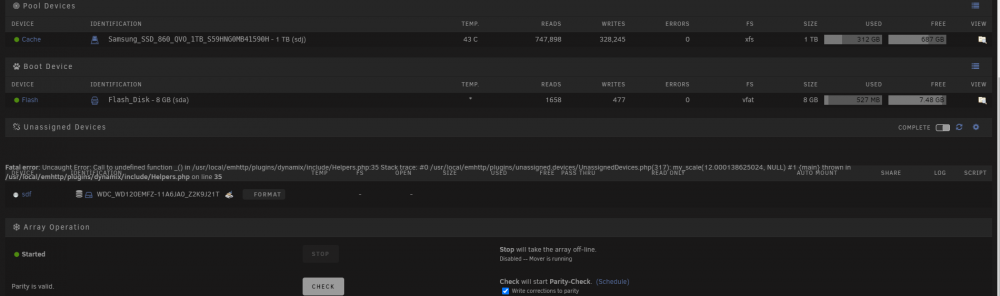

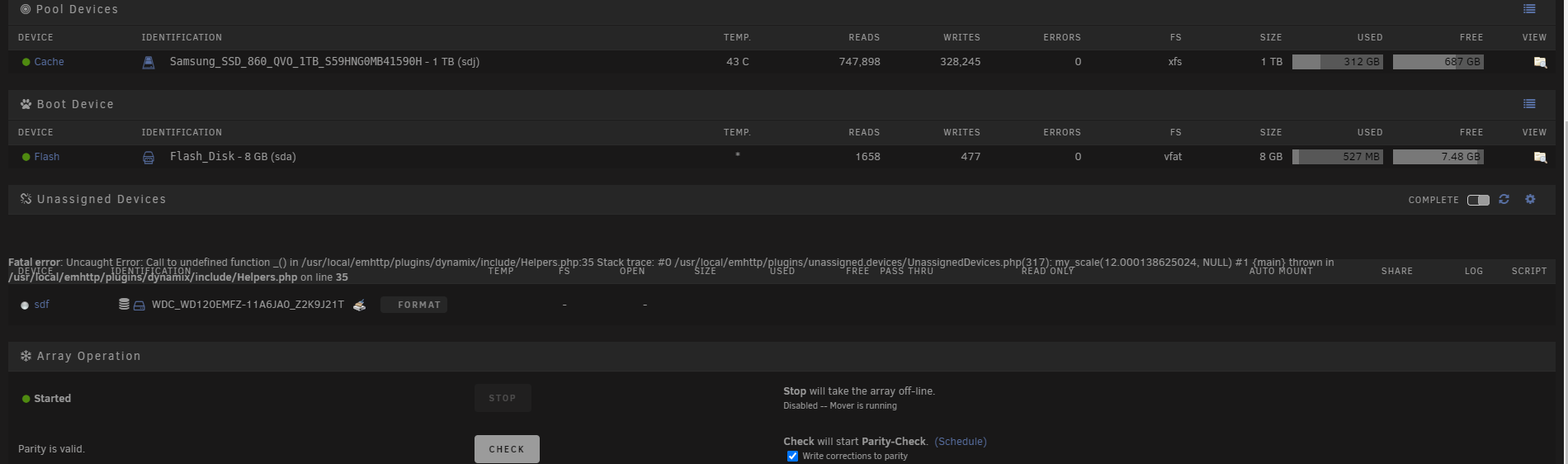

I am also seeing this weird error in the screenshot below.
Thank you,
GTP

1 hour ago, GTP said:
When I click on the terminal icon in the upper right hand corner, the terminal window pops up but I cannot type anything
Both of these seem like browser problems. Make sure you only have one browser window open to your server, maybe clear browser cache. Do you have an adblocker or anything else that might interfere? Which browser are you using?
@trurl I am using Brave but I turned off all shields. I switched to chrome and I managed to get the terminal window to chow up but the error in the screenshot from before persists. I have also attached a screenshot of what was displayed when I ran the commands you requested. It looks like some leftover containers from the old docker image that didn't get deleted for some reason?
Thank you for your help,
GTP
Your appdata isn't part of docker.img. That is one reason it is safe to delete docker.img since all of that appdata is stored elsewhere.
I assume the currently used appdata for letsencrypt is on cache since it has precedence. Are you even using letsencrypt? I know that docker was renamed to swag but of course the appdata for swag could be named letsencrypt.
These latest diagnostics you posted shows you have docker enabled again. Why?
