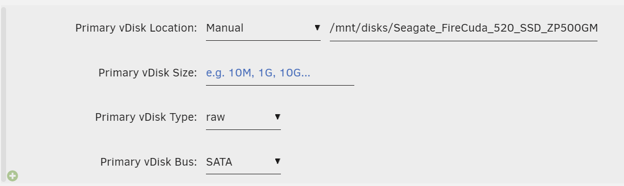

OK - been doing some reading of other having similar problems and made some changes in my VM Template:
First I mounted the NVMe drive in UD.  Then wetn to the template and manually set the location to the Windows partition that is now available via UD.  I left the vDisk blank, the type to the default raw and changed the Primary vDisk Bus to SATA.
Then I click on UPDATE.  The page currently says "updating" - but I'm afraid its been stuck like that for some time.  Its either crashed or really taking its time.
Rob
Edited by RAP2
typo/clarification
Well 15 minutes later - still saying "Updating..." -  so I clicked on the VMs menu and then hit edit on the Windows 10 template to review.  Looks like it took the revisions; not sure why it hung in that state.  So next, I tried to start the VM.
First, I got the UEFI Interactive Shell window... ESC or other keys did not really do anything - but I was able to type exit; it then went to an old school BIOS setting window as before (Standard PC (Q35 + CH9, 2009)
Reset dump me back to the UEFI IS v2.2... and I am in now "living in a mobius strip" - I think that should be the name of a song!
Ideas?

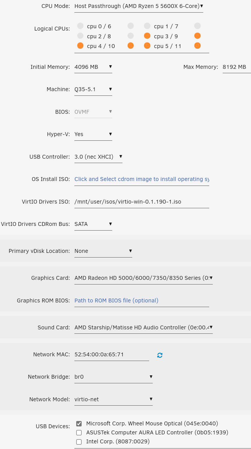

Full error message here:
VM creation error
error: Failed to attach device from /tmp/hotattach.tmp error: internal error: cannot parse product 0x1939#remove , error: Failed to attach device from /tmp/hotattach.tmp error: internal error: cannot parse product 0x1939#remove error: Failed to attach device from /tmp/hotattach.tmp error: internal error: cannot parse product 0x0029#remove
My settings in case it helps:
However, the VM will not accept my UUID - which is 3467b5f3-b0ea-ba89-bd6d-04421a07e0fc, whiteout the aforementioned error.
If you are going to pass through a drive to a VM you do NOT want to use a /mnt/disks/? typepath as that is where UD mounts drives and UD must not mount a drive to be passed through to a VM.   Instead you must get the /dev/disk/by-id type path for the drive.
@ itimpi:  That has been changed... see directly above your post:  My understanding is that is only for spinning disks and I am using an NVMe.  It was an early error I made watching Space Invader One's video.
Currently, the VM has been started - but I can't seem to RDP to it.  There is supposed to be a place to "enable RDP" for the VM - but I can't seem to locate this.  Also, I'm no even sure the IP address of the VM!  How do I determine this?
OK - After some reading, I've removed the VM.  I've also removed the manual stubs for the NVMe drive that I wanted to pass-through; but even after removal, System Devices showed it was still bound - I had to stop the array and then reboot UNRAID.  Back on-line, SysDev no longer had the NVMe bound - and it now magically shows up again under Unassigned Devices.  Yea!
However: does any one have instruction on who to do the dual-boot Windows 10 pass-thru under 6.9.2?   I've realized that as a newbie, following these videos is risky, unless one is working with  the exact same version of software.  Setting up a VM in UNRAID is not straightforward - lots of gotcha's.  Docs do not explain process and videos can be problematic unless you are using one that matches your version of UNRAID.
I had no problem setting up Windows 10 and Ubuntu on Virtual Box a couple of years ago.  Maybe the solution is to do that and then run UNRAID on a VB VM? Thoughts?
Well - I gave it another shot:  Reset my NVMe as "Pass Through".  Created the VM.  Set the SysDev binding for that NVMe.  Rebooted UNRAID.
Logged in, started the array, started the VM and then tried to RDP to it - nada.  No joy.
So then I decide to stop the VM and change my Video card to VNC so I can see what is going on.  It shows me the UEFI Interactive Shell with a mapping table to floppy's and an ATA???  The shell command allows me to "exit" - but it enter some kind of VM BIOS and continue or reset does the same thing - just loops back to the EUFI Shell ... exit to the VM Bios - etc.  Stuck in a loop.
Seem the VM does not real get started after all.  I cannot RDP because Windows has not booted in the VM.
What could be wrong?
You do not necessarily need to bind the nvme drive to pass it through, instead you can set the path to be the /dev/disk/by-Id/? value that corresponds to the nvme drive.
