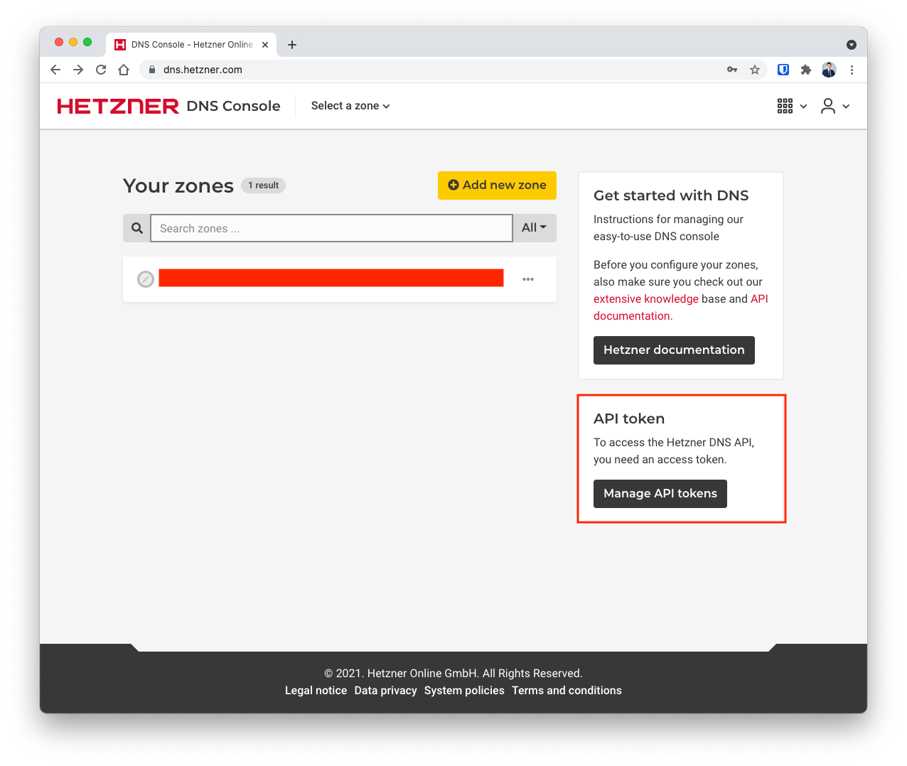

Hi, I only have a Domain at Hetzner and want to know, if I need something more than this tool? Do I have to make some arangment in the setings at Hetzner?
Hello @Alwerich,
besides the Domain you need to use the DNS Console of Hetzner for your domain. Configure your domain as a zone and then you can create a personal API-Token:
1002869495_Bildschirmfoto2021-10-21um08_37_53.thumb.png.d072fc52c7d978fe5ee24f662f134a0b.png

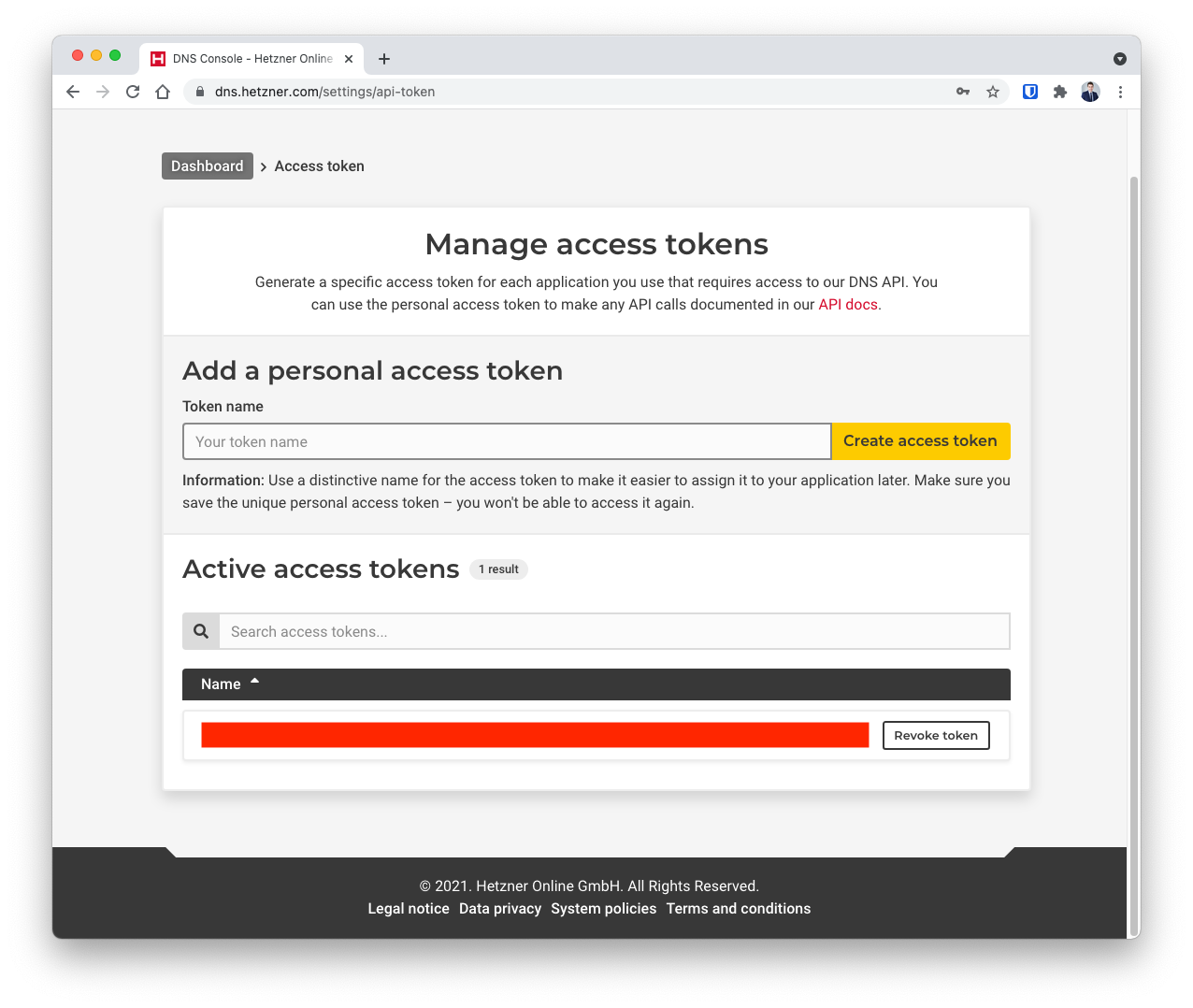

The API-Token will be used by the Docker Image to authenticate to your zone. Create an Token with a name such "Unraid" or what ever you like:
180395901_Bildschirmfoto2021-10-21um08_37_46.thumb.png.32e152791611da60fc3155293dd563a5.png

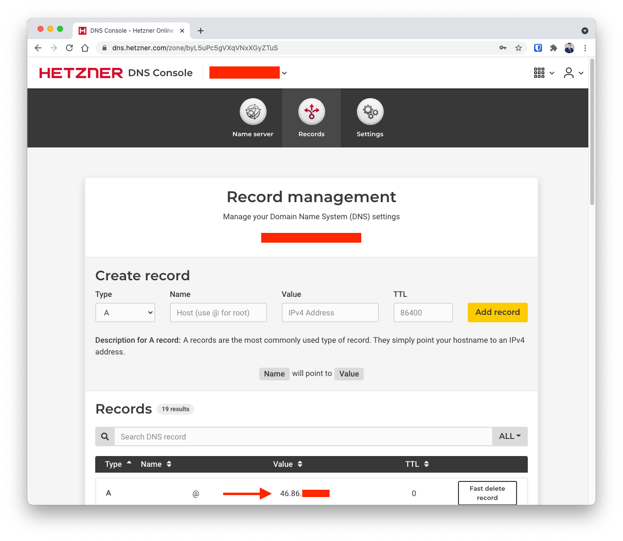

Provide the necessary attributes zone-name, API-Token and record type (A if you use a IPv4 or AAAA for IPv6) to the Docker Image. Afterwards the docker image will connect to Hetzner DNS and will update your @-Record (A or AAAA) to your public IP (respectively the IP the app is running on). Then you will find your IP here:
26934267_Bildschirmfoto2021-10-21um08_42_32.thumb.png.7f79bfc62f26dcd58f73f53890b8e15b.png
Afterwards you will be able to create DNS-Records (such as subdomains with CNAME-records) for your domain in the console. And they will point to your Unraid-System.

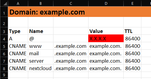

Hi @High-Tower,
I know it's been a while, but I also encountered this problem and wanted to share my solution.
To add some sub Domains you just need to create a CNAME in the DNS and Point to the A Record.
The red cell is updated by the Docker "hetzner-ddns" with the public IP every 5 Minutes.

Hi @Venari,
As far as I have tested, only one A Record can be updated with this Docker. And this should be the main record -> Type A | Name @
But you can store www.example.com as CNAME and link to the A record. (See the picture above).
