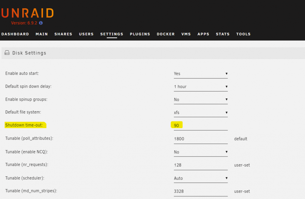

Everytime I reboot or shutdown my system a parity check starts when it powers back up. I am aware from reading other topics that this usually means an unclean shutdown but there is no errors appearing in the syslog during the shutdown process.

I based on that topic, have tried replacing my flash-drive to a new one and have tried chaging the shutdown timeout as per this comment in above thread:
"Timeout appears to be kicking sooner than it should, go to Settings - Disk Settings and change the shutdown timeout to a different value just to re-apply, set it to like 60 secs."
But still I get a parity check starting after reboot.

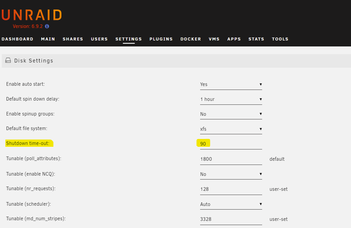

Try stopping the array from the Main tab and time how long it takes for the array to stop.  That will tell you if the 'Shutdown time-out' value is correct.
I timed how long it took to stop the array from the Main tab:
1 minute & 9 Seconds.
Could it be that 90 secs is not long enough in my setup for all my VMs (x3) and Docker Containers (x30+) to shutdown fully if something like a windows update kicks in?
I am going to up the timeout to 180 secs and see if a parity check starts on reboot.
This seems to have fixed it.
Increasing the timeout to a high vaue (180 secs in my case) has ensured enough time for safe shutdown even in the event of a Windows update during VM shutdown.

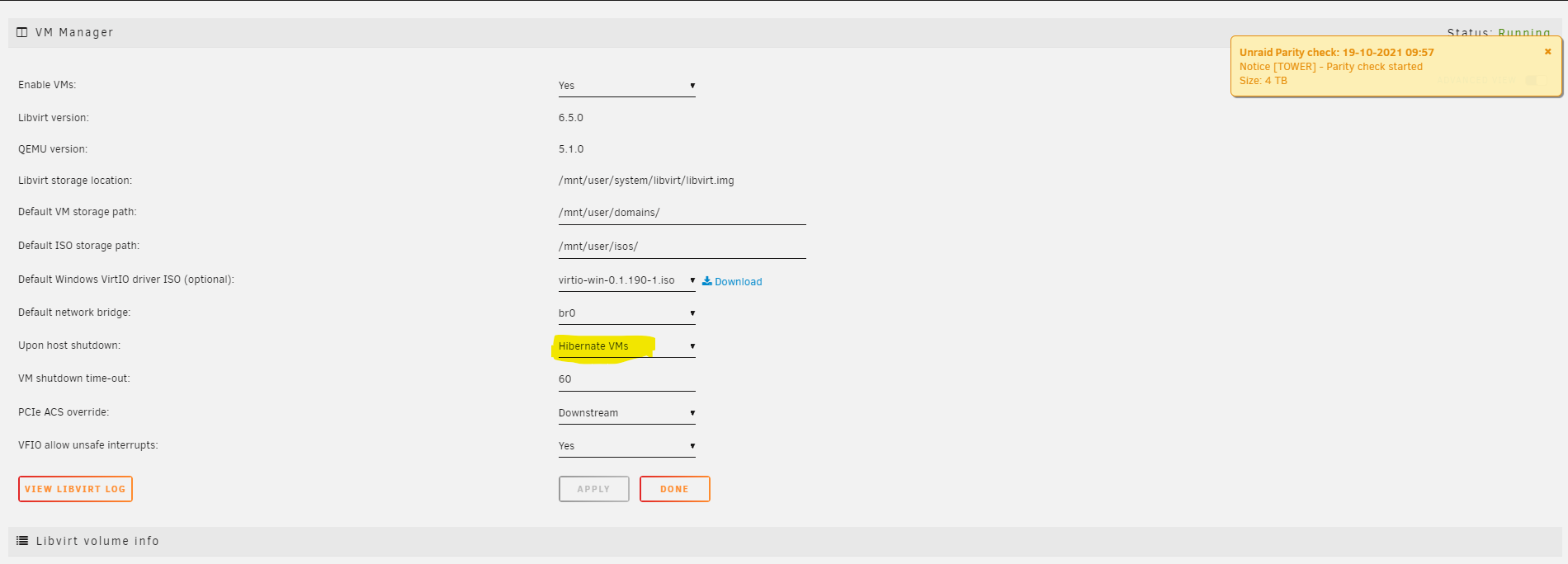

I followed your recommendation of changing my VMs to hibernate instead of shutdown, any other recommendations seeing as libvirt is the culprit?

Oct 19 09:50:38 Tower shutdown[16774]: shutting down for system reboot
Oct 19 09:51:45 Tower root: Waiting on VMs to hibernate............................................................
Oct 19 09:51:45 Tower root: Domain 86349a06-14bd-3361-c257-9064d80fe376 is being shutdown
Oct 19 09:51:45 Tower root: Domain 37dc3718-c315-0f42-39de-4a1ab8e25771 is being shutdown
VM timeout is set to 60 secs, and it wasn't enough, and looks like they didn't force shutdown either since libvirt was still in use after this.

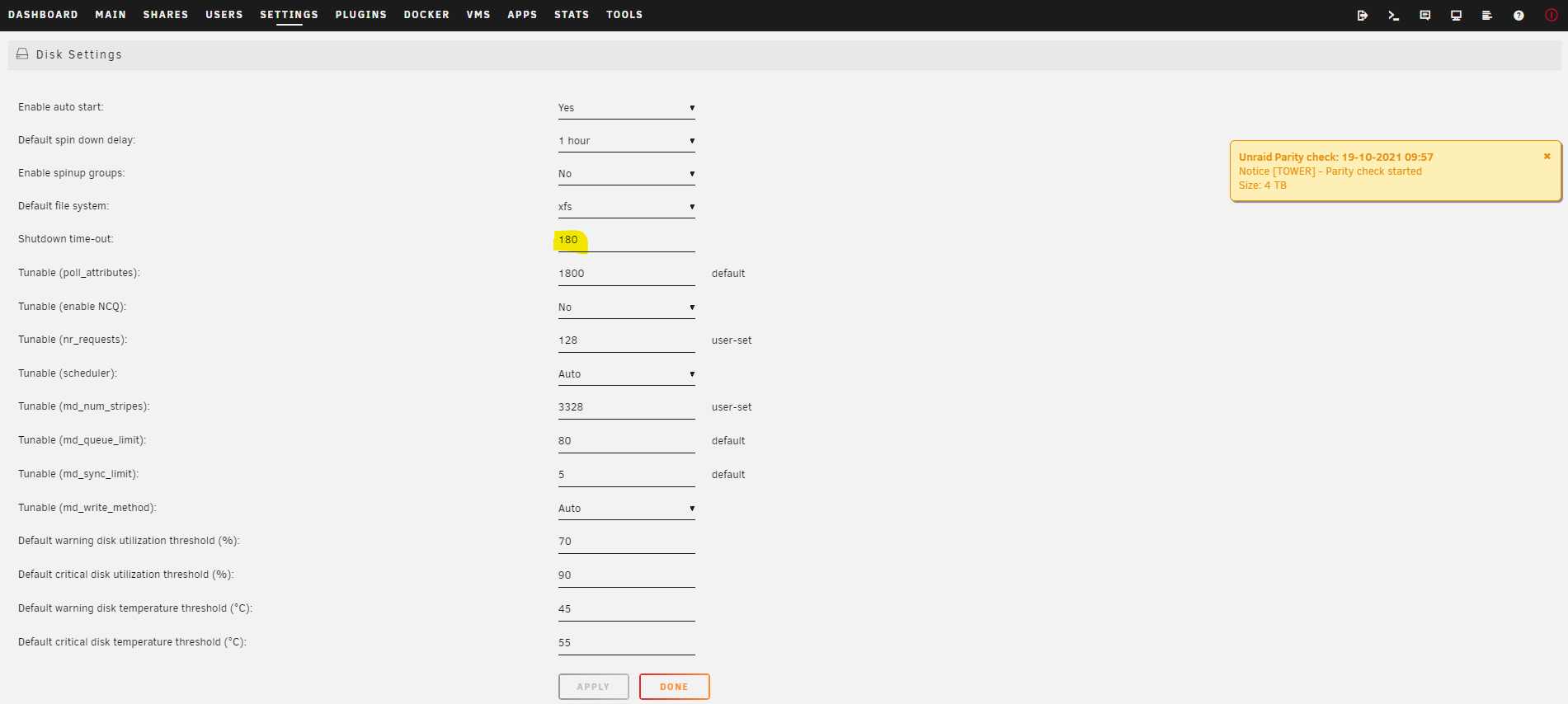

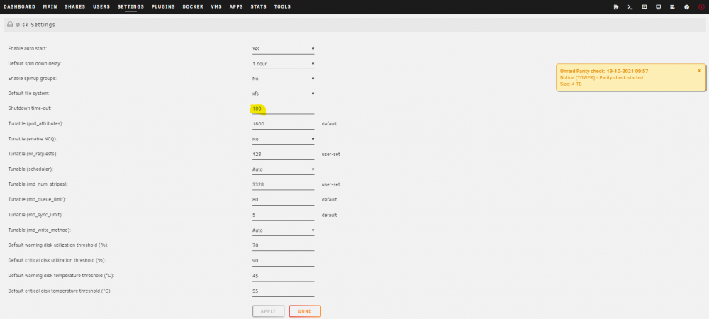

I updated VM shutdown time-out to 180 secs and still a parity check after reboot.
You need to increase the general timeout, they can't be the same or the second one will kick in, still it looks like 180 wasn't enough for the VMs to shutdown, do they shutdown if you stop the array? If yes post new diags after doing that.
7 minutes ago, Capt.Insano said:
it completed successfully but took 4mins 14secs!
So then you'dneed to set the VM timeout to like 5 minutes and set the general timeout to 6 minutes, or just shutdown the VMs manually before rebooting/stopping the array, that's what I do.

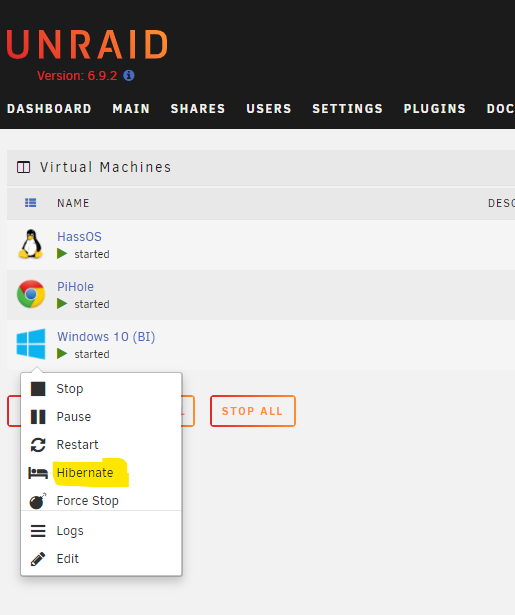

@JorgeB & @Squid

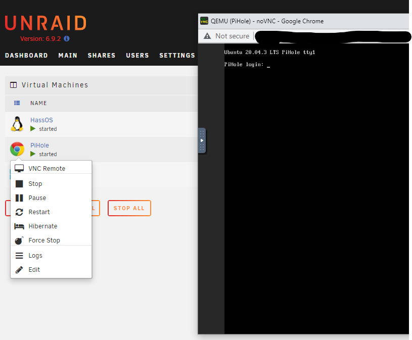

I think I have found the issue that is causing the excessive shutdown times at the moment (and possibly the unclean shutdowns):
libvirt is not hibernating my linux VMs.
My Windows 10 VM will hibernate no problem either during array stop, unraid shutdown or by manually triggering a hibernation here:
But if I try the same with either my PiHole VM (ubuntu based) or HomeAssistant OS VM(Hassio) nothing happens:
This screenshot was after clicking the "Hibernate" button, nothing happens and the VM does not hibernate (same with HassOS VM)
I think they are just sitting there (ignoring the hibernation command) causing the libvirt timeout to be reached and then being force-closed.
Should linux VMs be able to hibernate from libvirt?
