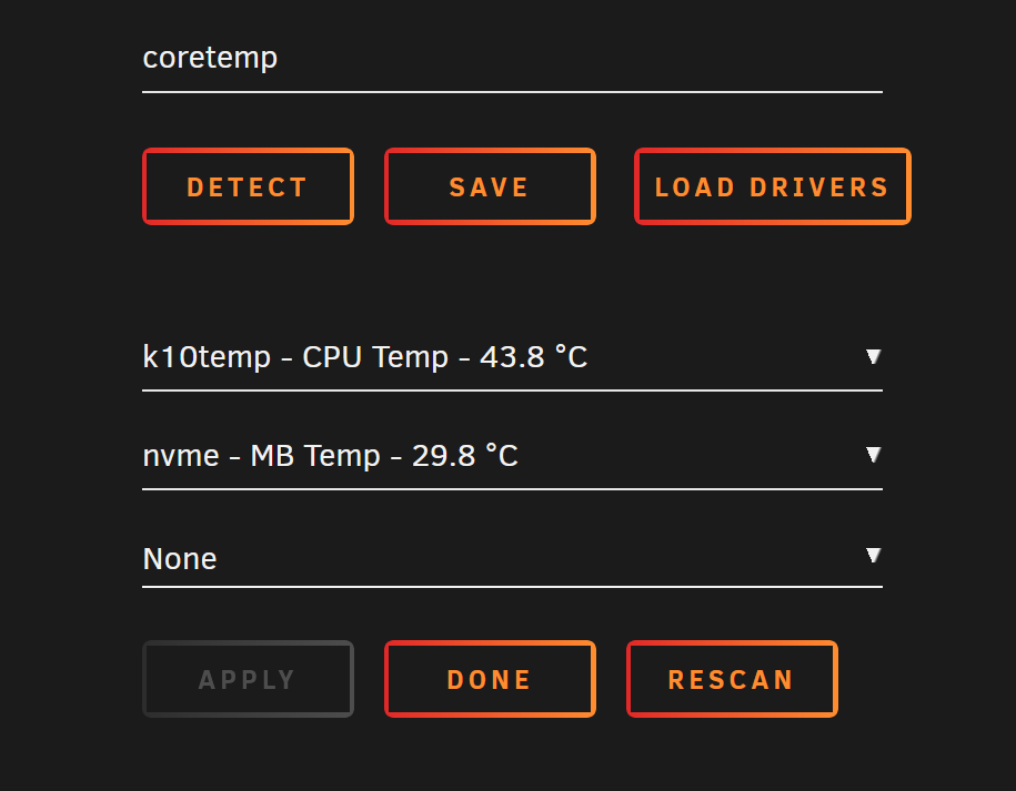

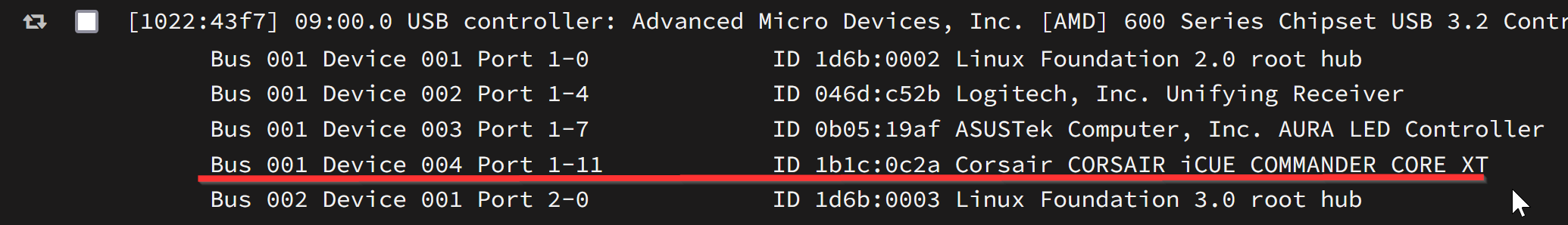

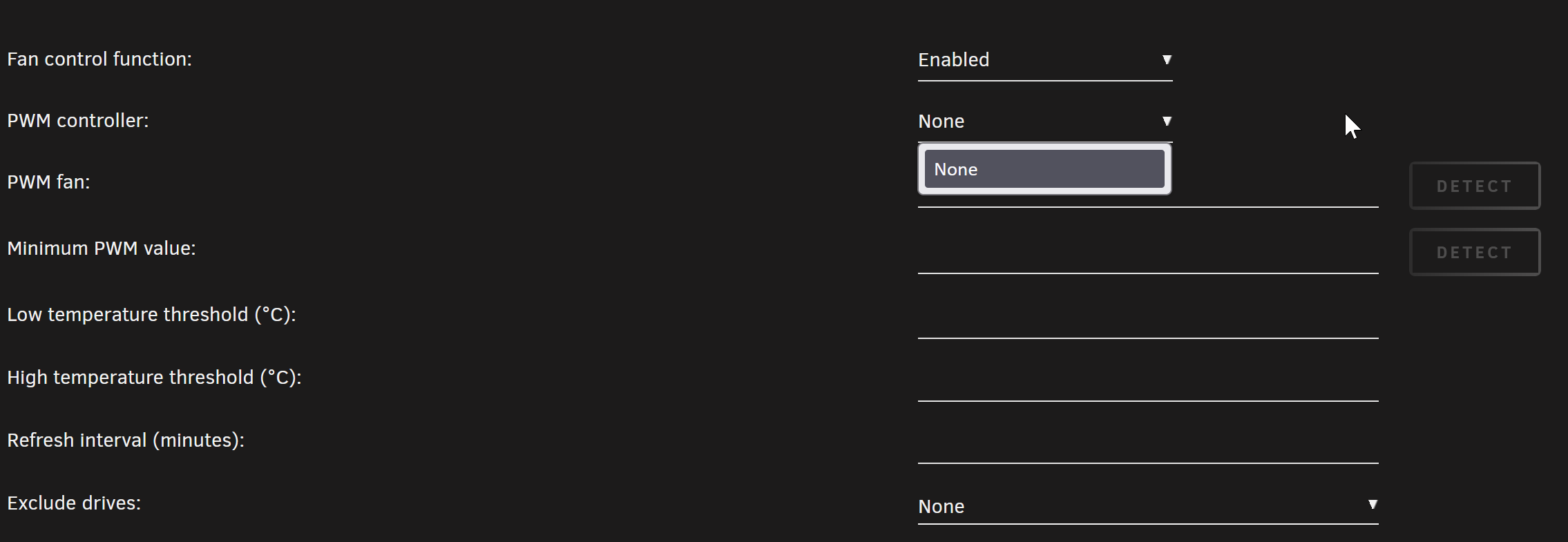

December 3, 20241 yr On 10/29/2021 at 5:56 AM, mikeyosm said: EDIT: lspro shows the driver exists but is not in use. So, I've been trying to get this working for a while now and have gotten nowhere! If 'lspro' is a Linux CLI command, it's not working on my system! (UR 6.12.14) I can see the Commander in the hardware list Dynamix System Temps shows none for fans. Dynamix Fan Control also sees nothing. And sensors-detect also finds nothing. I'm not sure what I am missing? Is there a driver plugin I need to install? A kernel config that needs adding to the boot?
