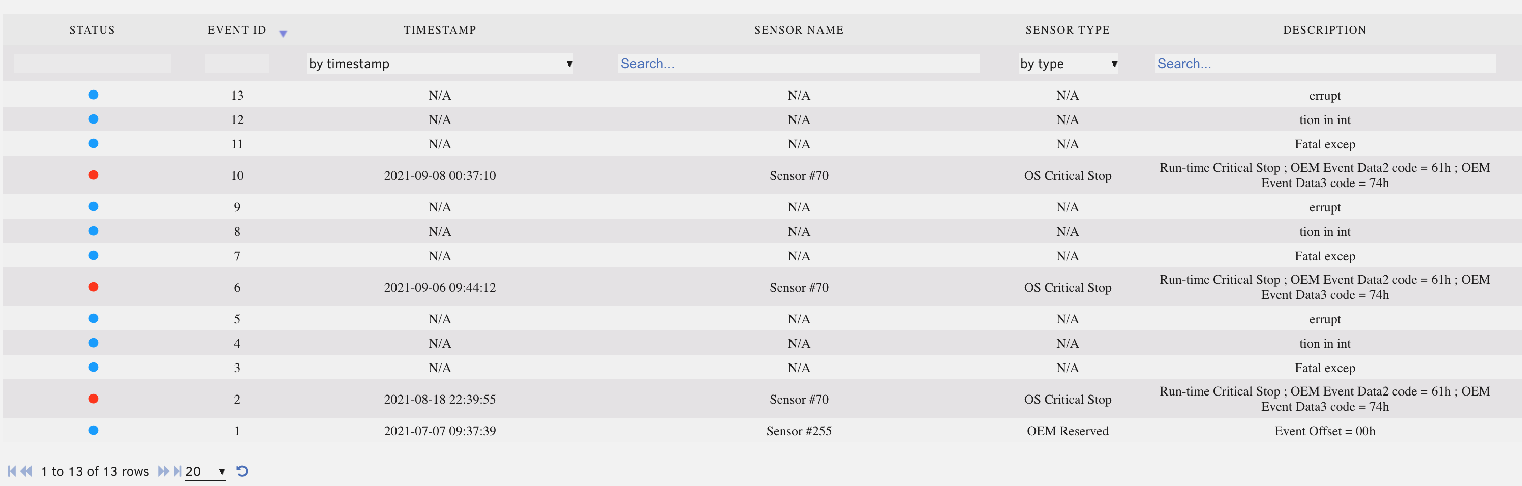

Hi Guy´s,
I´m running Unraid 6.9.2 and i´m running my server on Supermicro hardware.

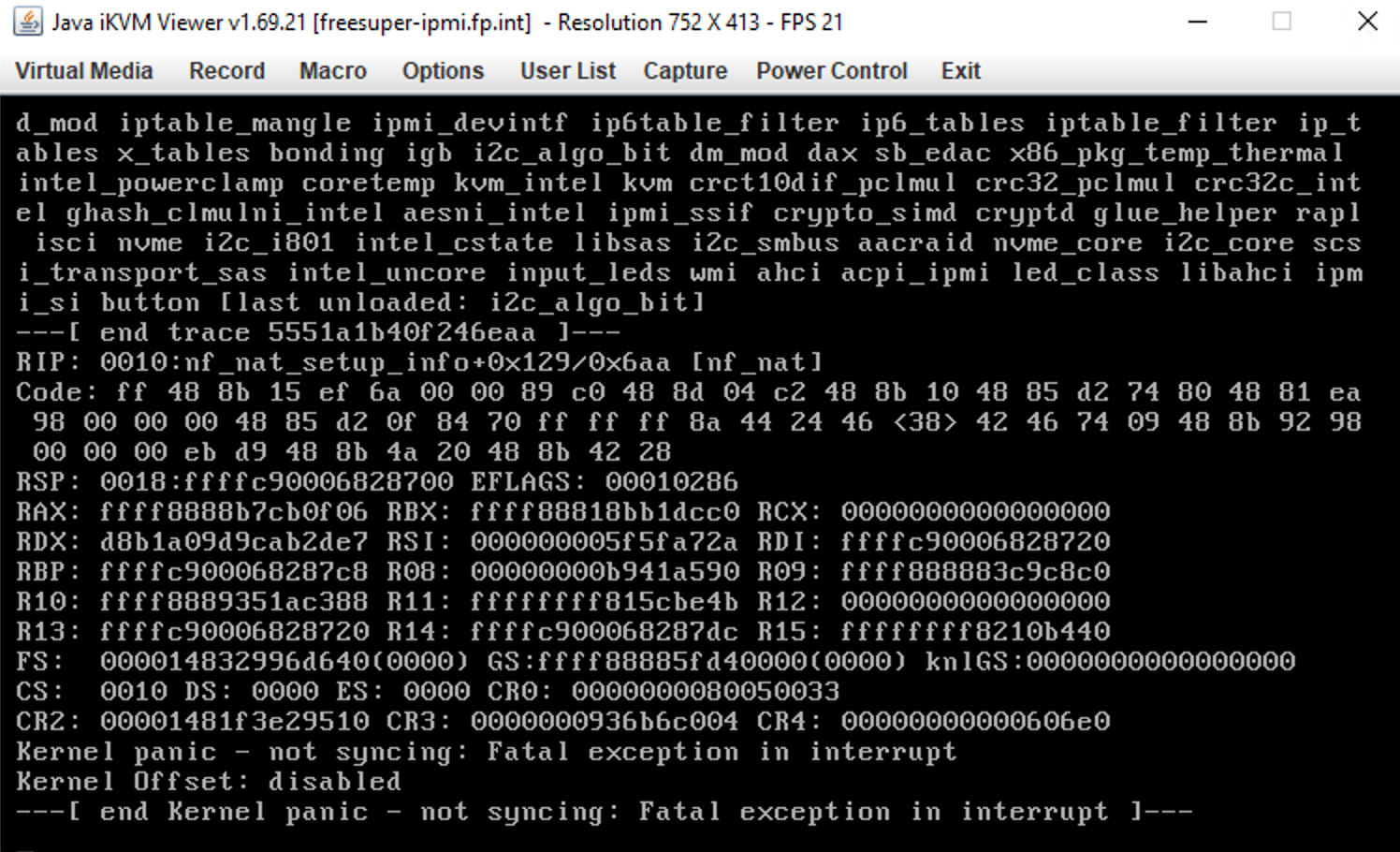

My Unraid server is getting Kernel panic every other day.
Hopefully you can find something in the logs that i have missed.
I have tested to update the BIOS/BMC version.
I have the "IPMI Support" plugin installed.
I have tested to uninstall/remove plugins/docker-apps with no luck.
Screenshot_01.png - Kernel panic

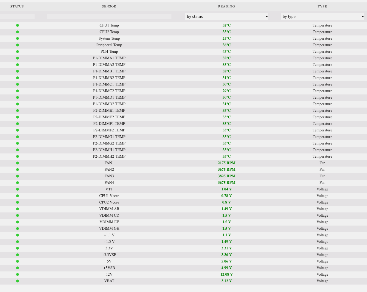

Screenshot_02.png - Temp, sensor info

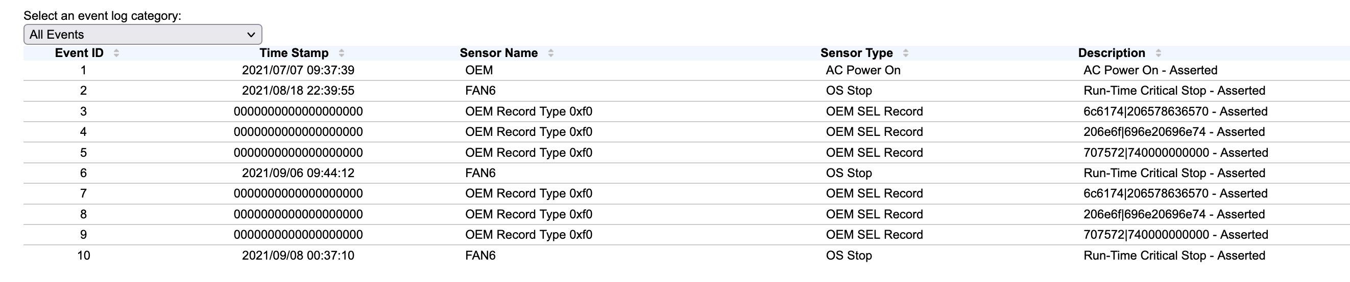

Screenshot_03.png - Run-Time Critical Stop (There is no FAN6 installed, this is from Supermicro IPMI)
Screenshot_04.png - Run-Time Critical Stop (This is from IPMI Support plugin)

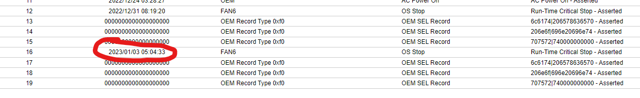

Hello, I also use a Supermicro board (X10SDV-TLN4F) with unraid 6.9.2 and also had this error three times.
Do you have a solution ? How's your troubleshooting going @kfpersson?
I read the error via the IPMI APP (Event Log). I write the log now on an external syslog server to see more accurate errors.
Hi @netsrot303
ATM i have had 7 days without any problem.
The posted problem that i had December 6, was something else. Not because the "Critical Stop" issue.
But my solution so far for the "Critical Stop" issue was to:
  • Update the BMC/BIOS
  • Remove old plugins/docker
