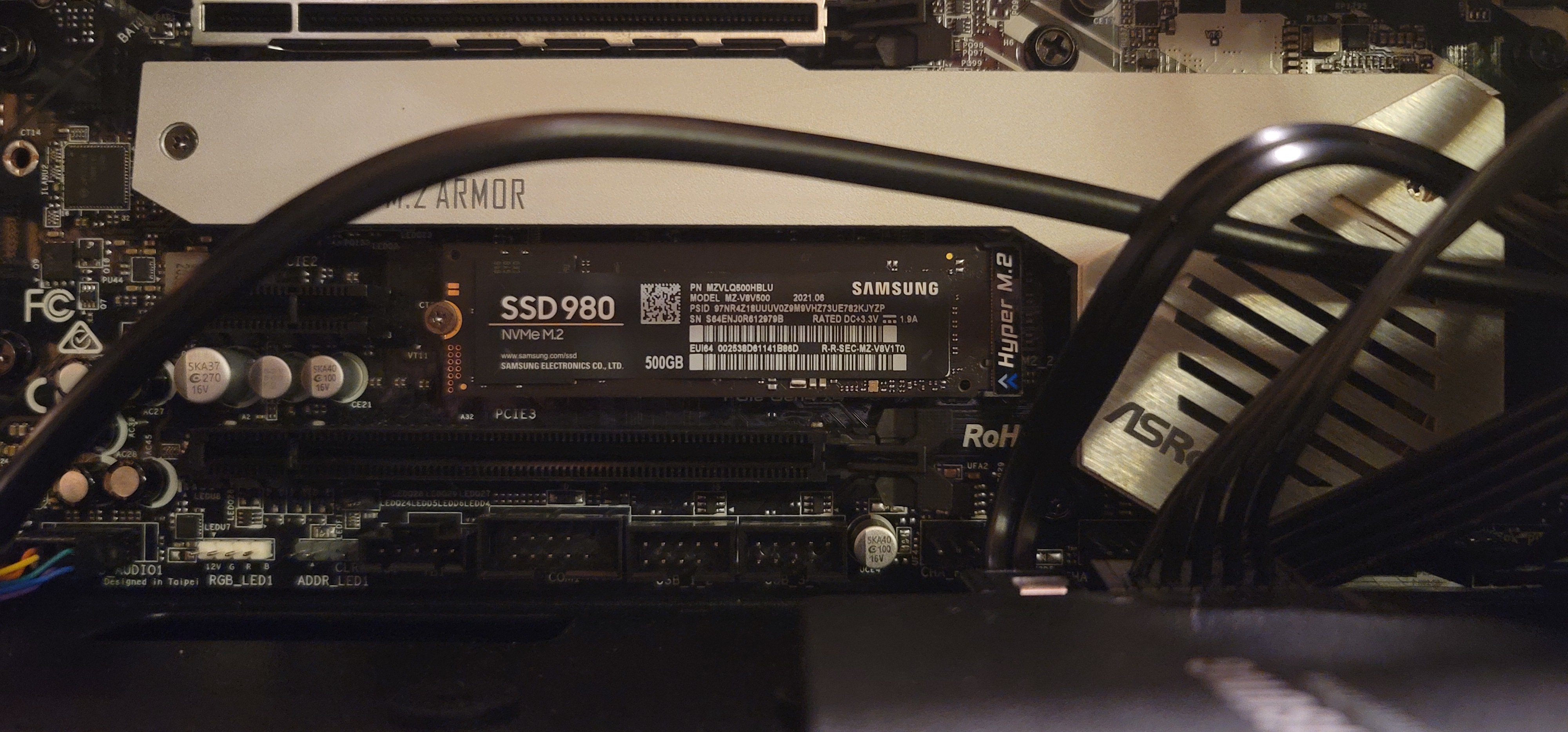

I just updated to 6.10.0-rc2 and noticed that I'm now having issues with my NVMe cache SSDs spike up from 31 C to 84 C. I use this cache drive for Docker containers. I first noticed this issue after I 1) upgraded to rc2, and 2) installed a new container (Jellyfin). After removing the new container the problem seemed to go away until tonight.
Any thoughts? Should I downgrade or is my NVMe faulty?

  • I have a heatsink on mine and it makes a HUGE difference

Put a heatsink on it
Right, add a 3rd party heatsink.
Suggest don't use onboard one, I found almost all miss or hard to align, no matter Asus Gigabyte EVGA.
Ok, very good. I'll head to the store at some point to get a heatsink.

root@maxwell:~# sensors | grep nvme-pci-0400 -A 5
nvme-pci-0400
Adapter: PCI adapter
Composite:    +31.9°C  (low  = -273.1°C, high = +81.8°C)
                       (crit = +84.8°C)
Sensor 1:     +31.9°C  (low  = -273.1°C, high = +65261.8°C)
Sensor 2:     +44.9°C  (low  = -273.1°C, high = +65261.8°C)
nvme-pci-0400
                       (crit = +84.8°C)
Sensor 2:     +43.9°C  (low  = -273.1°C, high = +65261.8°C)
nvme-pci-0400
                       (crit = +84.8°C)
Sensor 2:     +41.9°C  (low  = -273.1°C, high = +65261.8°C)
Edited by MaxwellHouse
