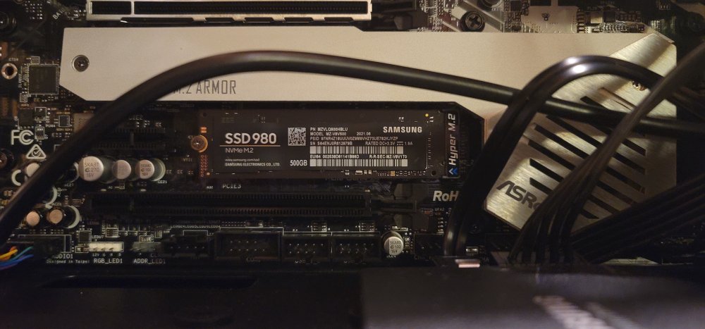

  • I have a heatsink on mine and it makes a HUGE difference

Came here after seeing these temp spikes for months and even with a cooler on it.
Its only used to boot VM's and is idle 90% of the time when a VM is not running, so i have set the temp values to 85 warn and 86 crit and will see how it goes...
