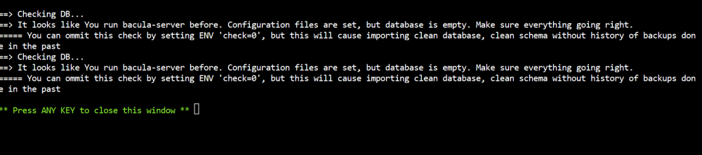

I installed bacula with postegresql except that I don't know why but it can't find the host of the IP database (both are on the same networks) so after that I deleted everything and installed with sqlite3. Installation that works but did not take into account the following variables :
-WEB_User
-WEB_Password
After launching the container I access the dashboard with a 101-curl error. I check the internal conf files and it turns out that the user was admin and the password was difficult. So the variables are not taken into account as I mentioned above.
Edited by professeurx
On 4/22/2024 at 11:50 PM, Sinister Crayon said:
My feedback about the image still stands... I went into the console and did "apt update; apt install -y ssh; apt install -y pgp" and that allowed me to use the deployment API successfully.
You are doing something that containerization is not intended for.
If you need to extend the image with additional functionalities, use the image as a source, install packages, configure and thus use a new image, or use the image creation code and modify it to suit your needs, the image code is published by me on github.
Additionally, by modifying the API settings, you may corrupt your copy of the image and require help later (when creating the image, I cannot predict what you will modify, and after updating the image, your settings may be overwritten).
Did you provide the ip or hostname by entering DB_Host in the Bacula-Server parameters?
Found my mistake, it will be resolved at the next image update.

Just wanted to provide some more feedback. Decided to start from scratch with Postgres as my database instead of SQLite. Cleaned up the old config and deployed the 15 image with Postgres. Can confirm I am having the same issue as @professeurx that despite defining DB_Host, DB_User and DB_Password it cannot find the Postgres database. I can connect fine from other remote systems. Tried adding DB_Port and the problem persists; says
==> Could not connect to database. Please check DB Settings: Host, User, Password, Port. exiting
Edit to add: Switched to the 13 image with Postgresql and it seems to work OK.
Edited by Sinister Crayon

did You create database and database user before You installed Bacula-Server?
I've checked on my lab and everything working ok. I've checked postgresql13 postgresql14 and postgresql15 (clean install)
9 hours ago, professeurx said:
What is this error? because I would only like to work with postgresql as a database
That was about curl-101 error with sqlite3 version, but could also happend in postgresql version.
