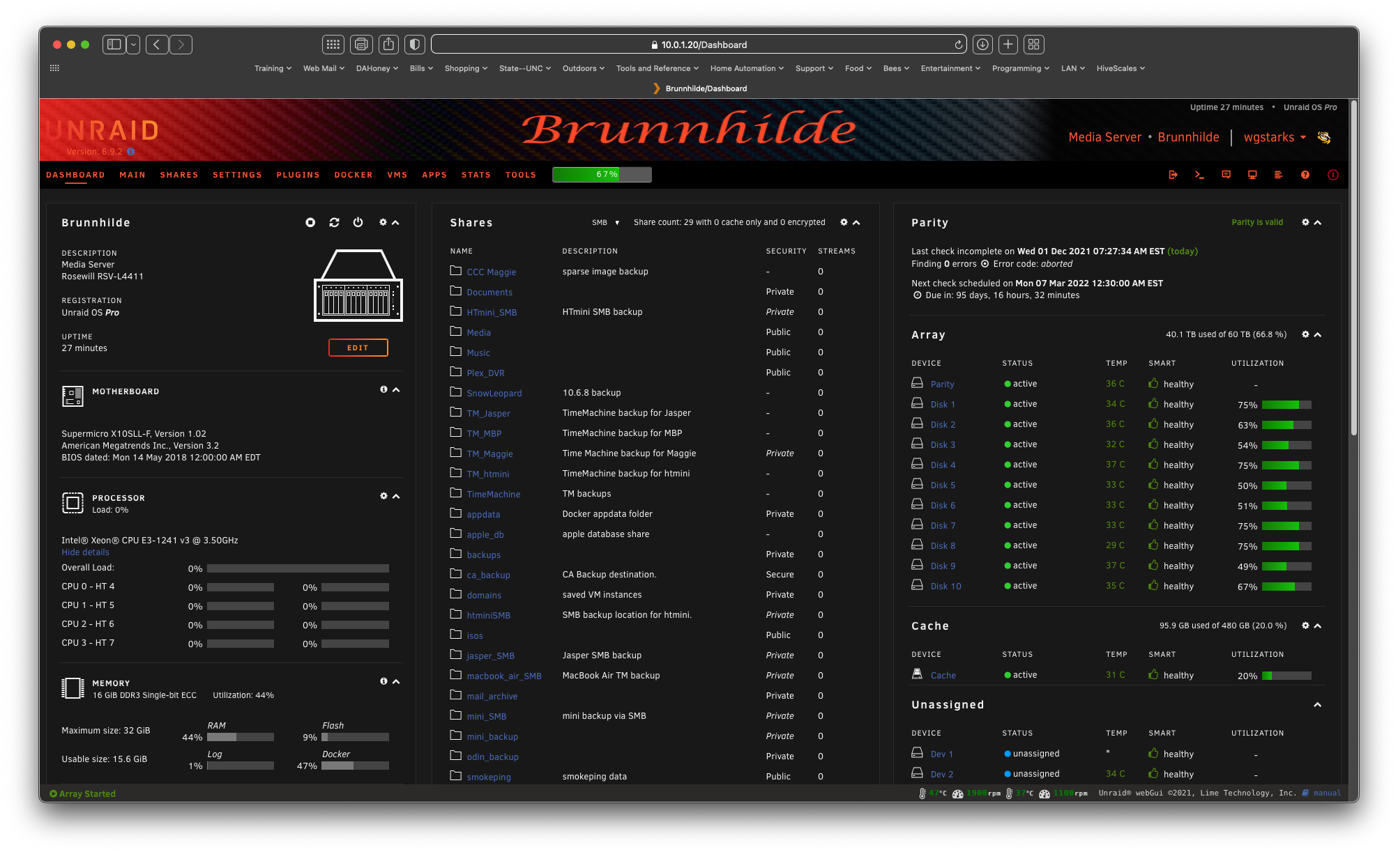

The dashboard isn't showing any cpu activity.
804480213_ScreenShot2021-12-01at7_57_03AM.thumb.png.d20e0e00d77624287b0e7bc591ec4ee2.png

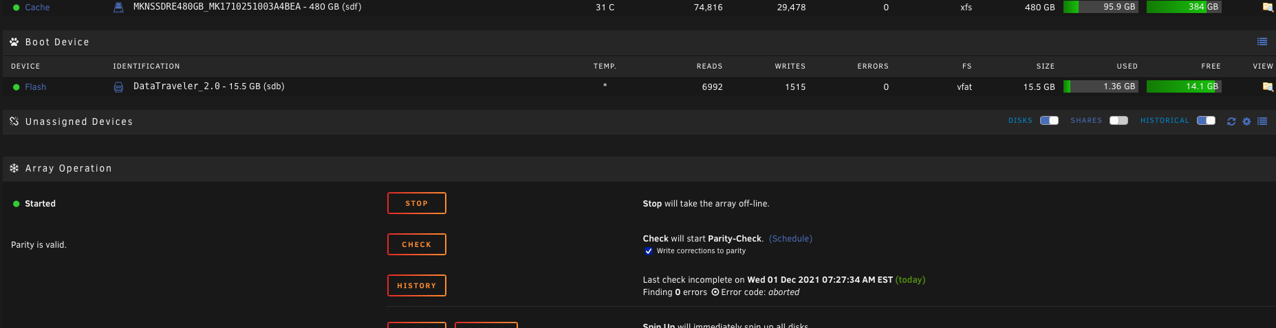

None of my connected dives are showing in UD. There are two external drives connected and I can access them via SMB and SSH.
826859008_ScreenShot2021-12-01at7_57_41AM.thumb.png.63a200a74e7f0e30b1359b74ed6053f2.png

Booting into safe mode restored the display of UD devices but CPU activity is still showing zero on dashboard.
As soon as I boot back in a normal mode I lose the UD devices again even with array start and dockers disabled.

If I delete the UD plugin I the webui shows the unassigned devices but I'm not sure UD is causing the issue. Removing the plugin and doing a clean install doesn't resolve anything. And so far nothing has corrected the dashboard issues. I might try restoring from the My Servers backup to see if that helps.

Make sure that safari is up to date.  Clear out your cookies etc.  Try a different browser.

OMG. I wasted most of the day restoring and restarting because of a browser issue. Safari is up to date but I’ll need to update to 6.10 for full compatibility.
The server freeze really had me thinking that the display issues must be related. Starting to look like all the issues happening at the same time is just really bad karma. 😆
