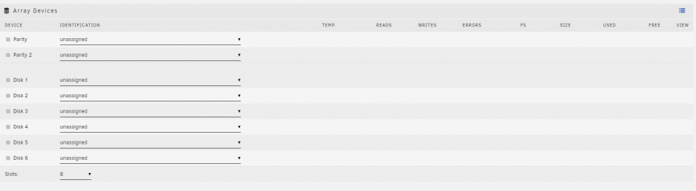

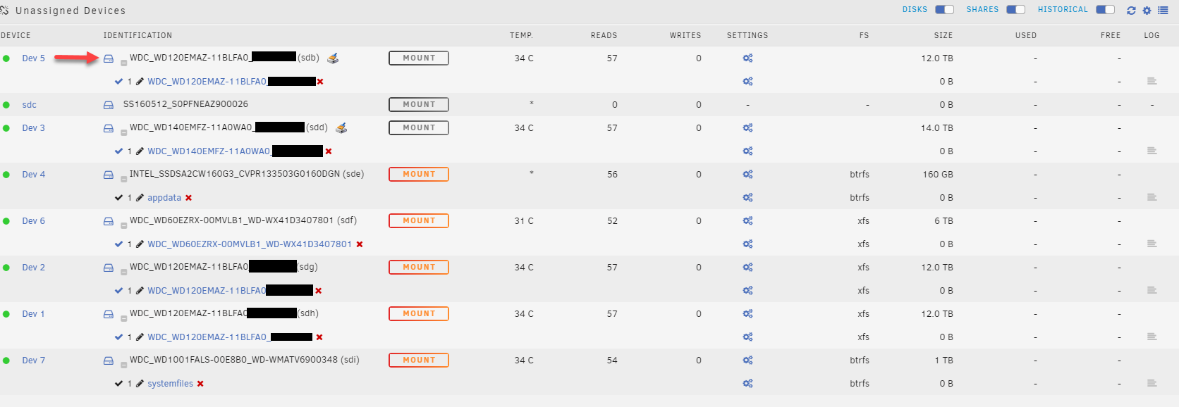

Post a screenshot of Main - Array Devices and Main - Unassigned Devices.
No doubt nothing is assigned because of the New Config. I assume you know what your disk assignments are supposed to be.
But you haven't mounted the Unassigned Device. "Mount" is a special word that means much more than just installing a disk, it means the filesystem on the disk has been made accessible.
I haven't assigned any disks to the Array devices because I was afraid if I did, it would overwrite any data I have on the affected disk (DISK 1).  However, I do know what my disk assignments are supposed to be prior to the mishap.  As for the Unassigned Devices, the "Mount" option is greyed out on the affected disk (DEV 5) so I'm assuming it's already mounted?
No, that means the UD plugin is not recognising a file system it can mount.  If it HAD mounted then you would have an unmount option
Thank you for the clarification.  So does that mean both my Parity Disk 1 and my Data Disk 1 are no longer accessible since the option to mount them are greyed out?  Also, if I assign disk 2, 3 & 4 back into the Array devices without the Parity Disk 1 and Data Disk 1, will my unRAID system will be able to function?  And if so, will it affect my array or my data without the other two disks?  I was hoping I can still have my unRAID system running while we look into options to try to restore data to Disk 1 if possible.

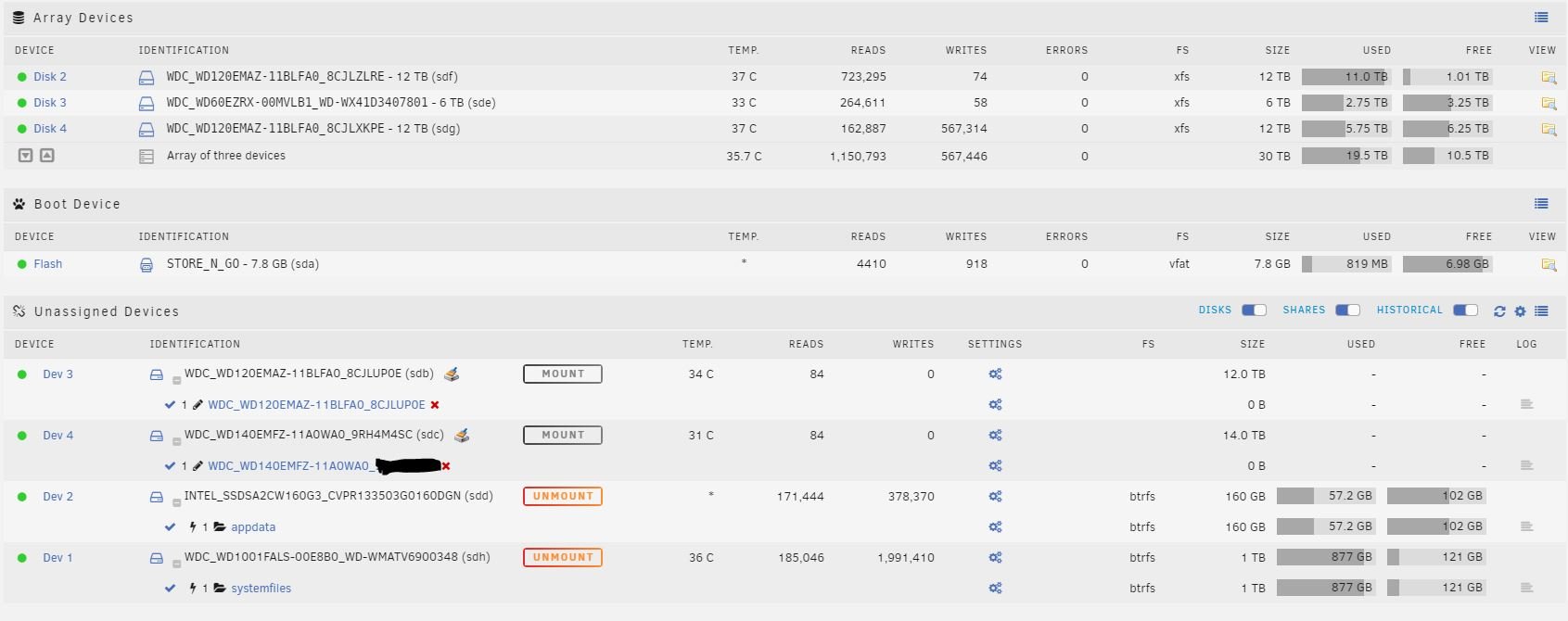

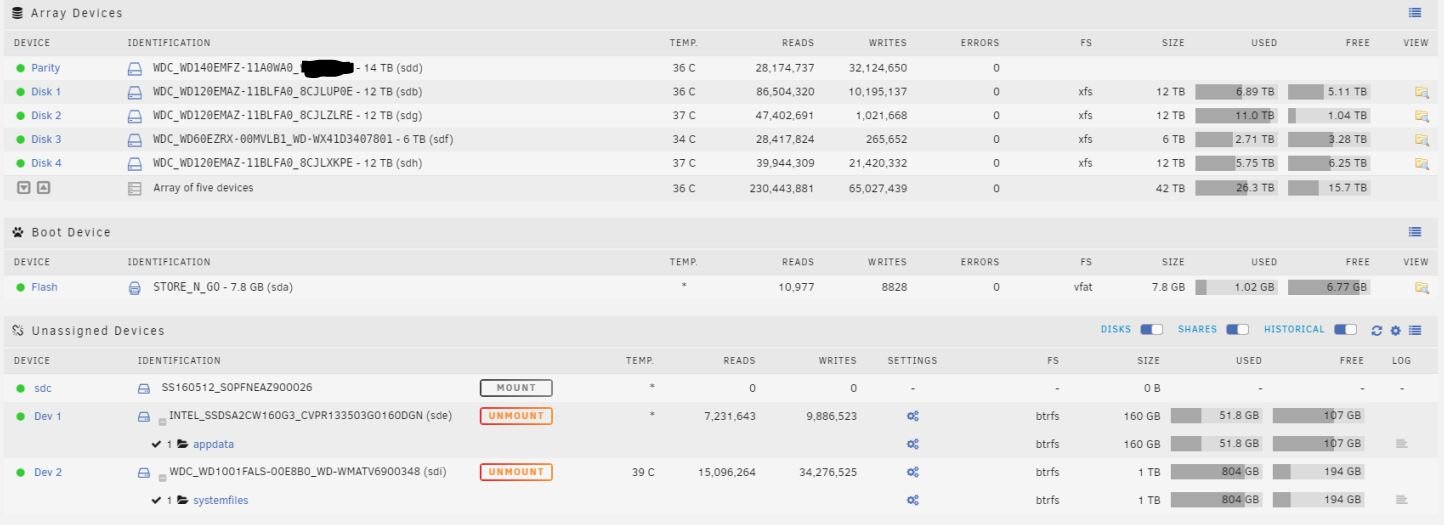

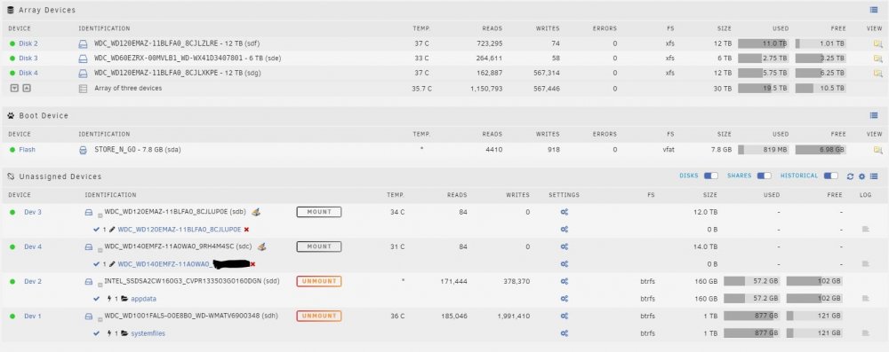

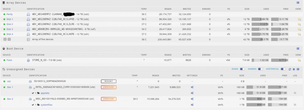

I've attached the original config of the disks prior to the incident as well as the current config (which was done to get the system online temporarily).  In the current config, I did not add back the 14tB parity disk since I'm hoping I can rebuild DISK 1 (SN# 8CJLUPOE - sdb), and was afraid if I had re-add the parity disk, the data would get overwritten.
Would have been better if array hadn't been started since this began but nothing to be done about that, parity is going to be out-of-sync to some extent. Hopefully you haven't actually written anything to the array during all this, but that first screenshot has more writes to disk4 than seems appropriate. Any idea what that is about?
So if data were added recently, would that cause any issues while rebuilding disk1?  As for disk4, that's where my most recent data are stored.
Yes. Parity is the missing bit combined with ALL the data drives. So any data altered on the rest of the drives is going to corrupt the rebuild of disk1.
With that much altered on the rest of the data disks, emulating disk1 is no longer an option. Sometimes you can get away with a few writes caused by the mounting process where the corruption is small enough that a file system check can repair things, but new files being written to the remaining data drives is going to corrupt things way beyond repair.
The parity drive in isolation is worthless, it has no data whatsoever. It only has value when it's in sync with all the rest of the data drives. Remove one data drive, and the rest of the data drives plus the parity bit emulate the single missing drive.
