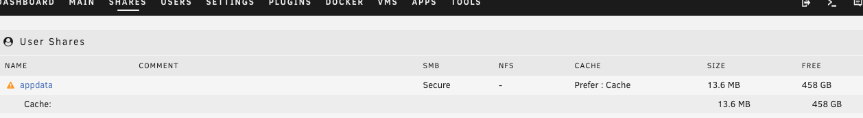

 I followed you instruction   I believe everything is on pool? Should i change the appdata to  Yes or leave on Prefer as the error message is still there  after reboot?
That message is only a warning :)
You do NOT want to change the Use Cache setting to Yes as that will tell Unraid you want it moved back to the array.   You should either leave it at the Prefer setting or change it to the Only setting.

Yeah, the warning is correct.  You've got appdata set as use cache: yes which means that when mover runs it's going to wind up moving the appdata share to the array.  Warning only as there's nothing "technically" wrong with that, but your performance on containers will significantly degrade.  Hence the warning.  You want to set it to either Only or Prefer
