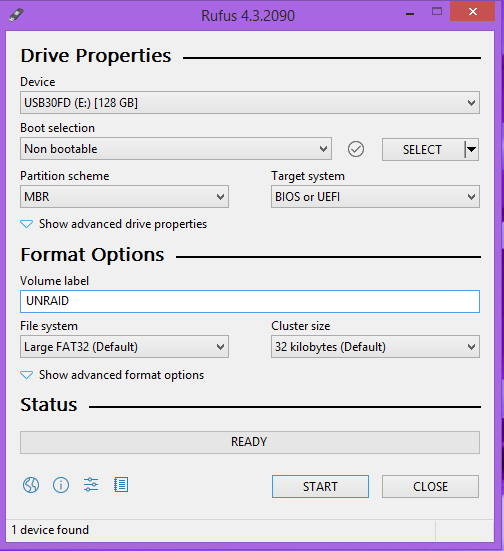

October 17, 20233 yr 3 hours ago, BeersTeddy said: Some flash drives will not be seen as bootable in Legacy mode no matter what. Could you please reformat one of those drives using rufus and see if it works after that?

October 22, 20233 yr On 10/17/2023 at 6:56 PM, JonathanM said: Could you please reformat one of those drives using rufus and see if it works after that? Found one of the drives. What options what you suggest to use in rufus? Boot selection? Syslinux? 4.07 or 6.04?
October 22, 20233 yr 26 minutes ago, BeersTeddy said: What options what you suggest to use in rufus? Once that completes, extract the contents of the installation zip file to it, and run the make bootable script. See if it boots properly then.
