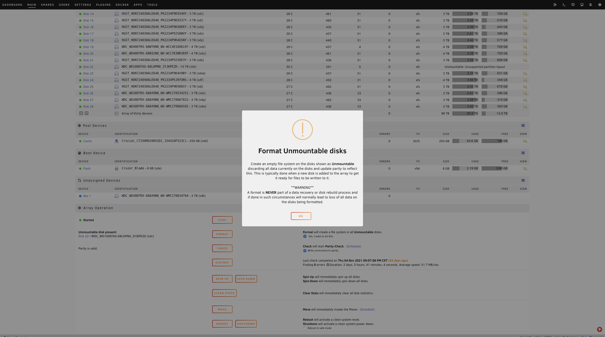

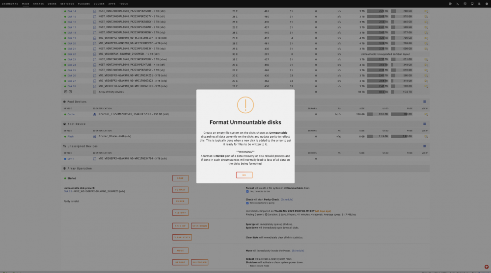

Disc is ok. So I want to add it to the unraid again, and rebuild it. When I add it and start the unraid, I get a message saying that I got 1 unmountable disc (in this case disc 22). I get the choice to format this disc. And a message saying "A format is NEVER part of a data recovery or disc rebuild process".
Have I done something stupid when I removed the disc and formatted it (using a Mac mini) ?

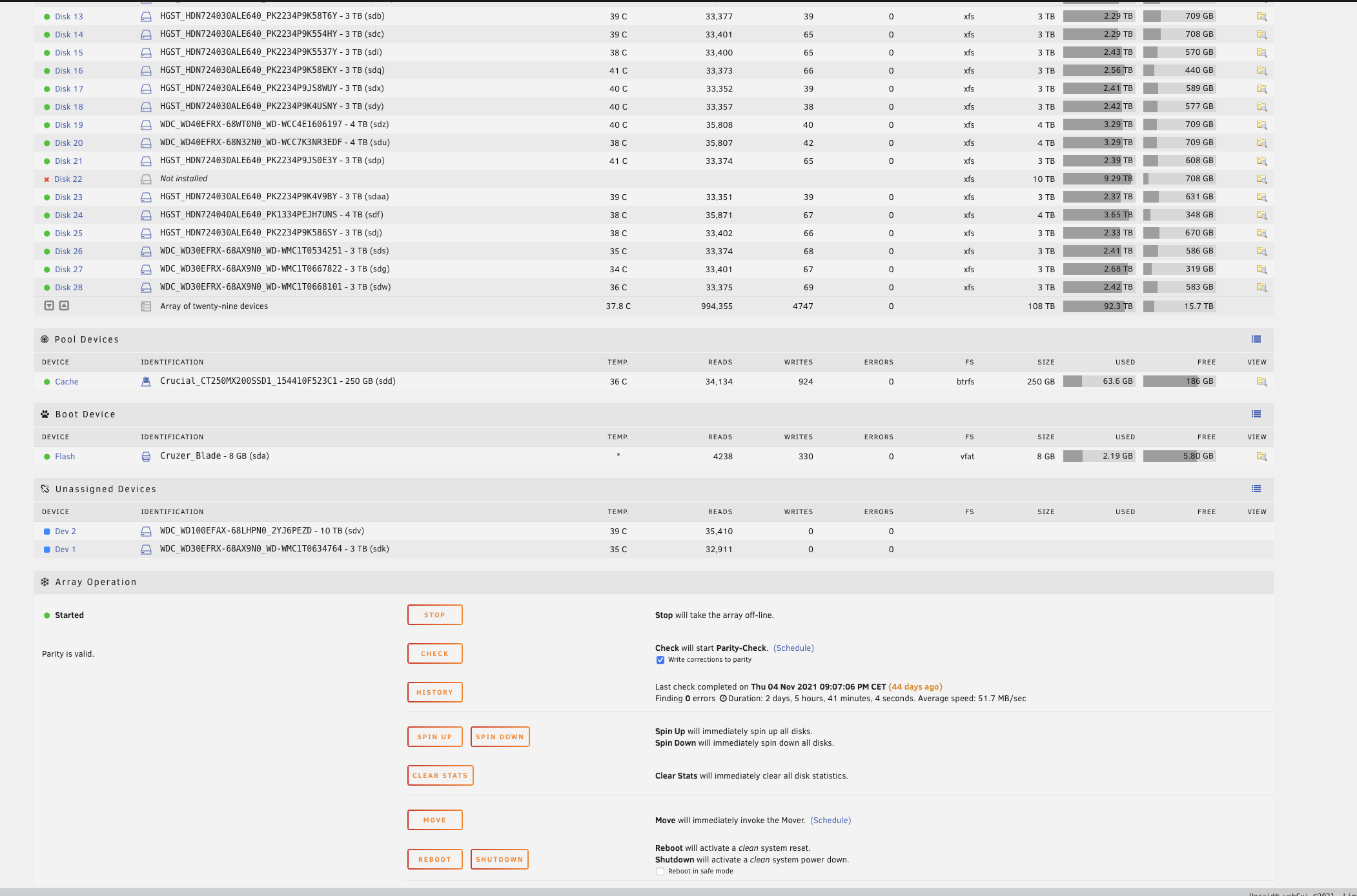

CRC errors are connection problems, not disk problems.
Pretty much everything you did was wrong, but maybe not fatal.
Stop the array, unassign the disk, start the array with the disk unassigned. That will disable the disk and hopefully the emulated filesystem will be mountable.
After that post a new screenshot and diagnostics.

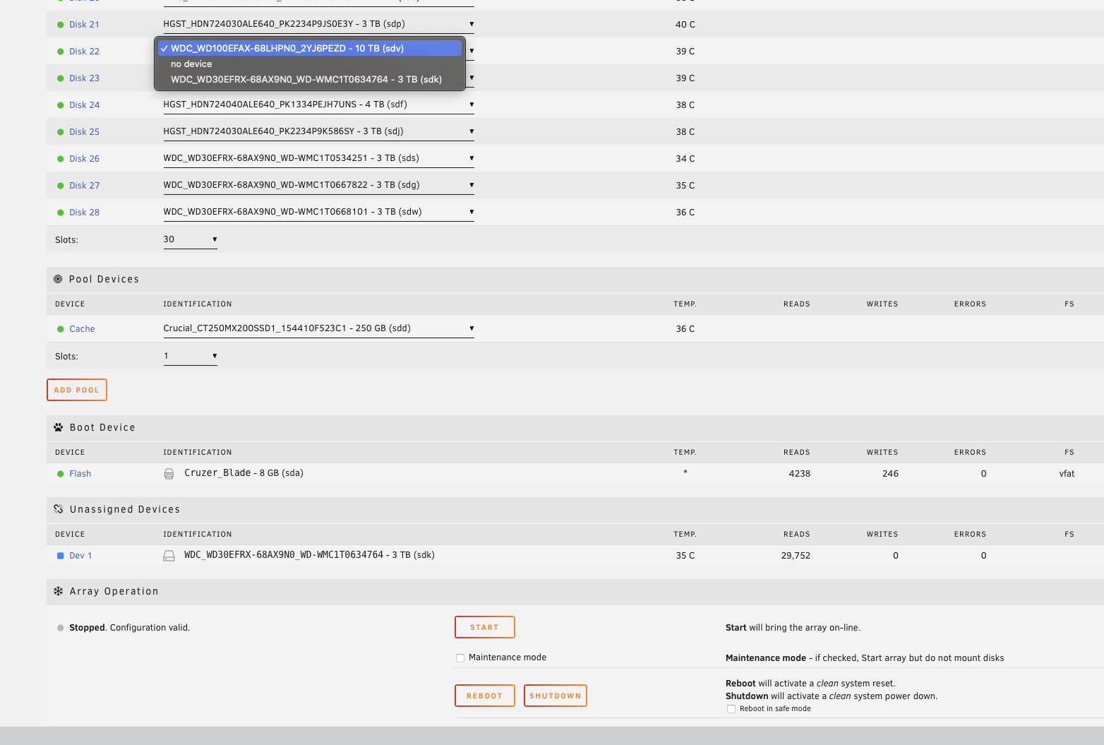

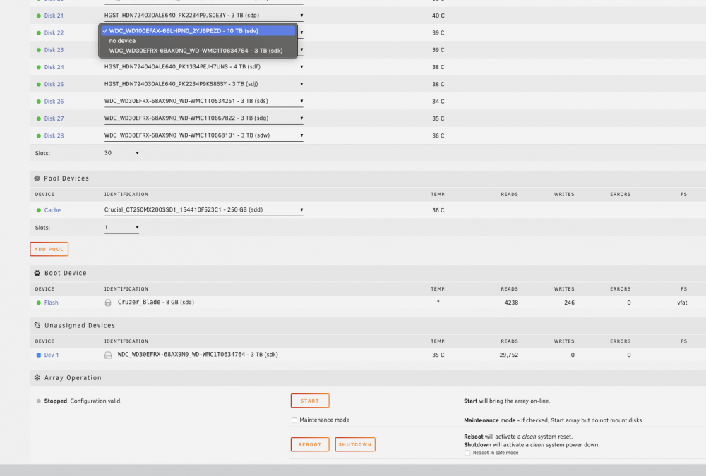

Thanks guys. But I am just lost here... The unraid is stopped. Shall I first choose disc 22 as the 10tb ? And then "Start" to bring the unraid array online ?
No, you should do what trurl already told you 19H ago:
Ok, sorry guys for being technically a rookie on raids. But if I start the unraid without disc 22 (disc 22 unassigned) - will not parity delete the data that was on disc 22 ?
What would be the point of having parity them? Parity, if still valid, will emulate the missing disk.
Ok, I am sorry that I don't understand this topic well enough. Hence these questions. I will start the array now without disc 22.
Emulated disk mounted which is good news, now you can rebuild using the old or a new disk, just stop the array, assign the disk you want to use and start the array to begin rebuilding.

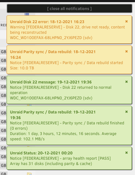

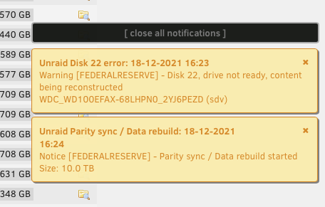

Rebuild started. I guess this message is normal ?
Yes.
Looks good.
Looks good my side too. Thanks everyone for helping 😀
