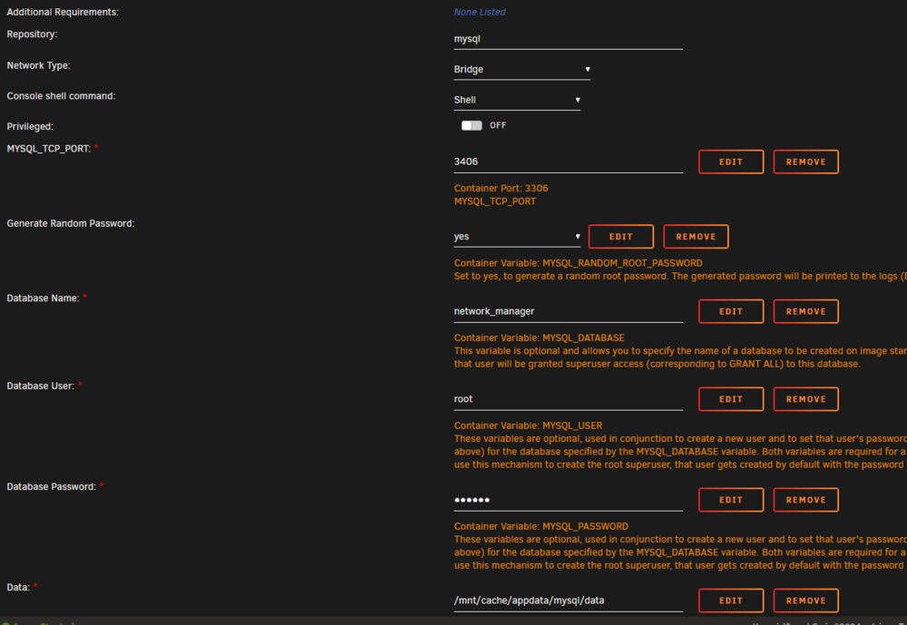

So there is no need to use additional MySQL docker? Am I wrong? a089b1b3c64823421bb315e85cdadb6c.jpg
The screenshot you posted says "Additional Requirements: MySQL"
So it should be additional decker with mysql. Created user / password / permissions. Does network manager will create DB Od first start?
Gesendet von meinem CPH2449 mit Tapatalk
Yes, you need an additional docker container with MySQL.
I am not sure whether the database is automatically created. Try creating it yourself to avoid any errors.

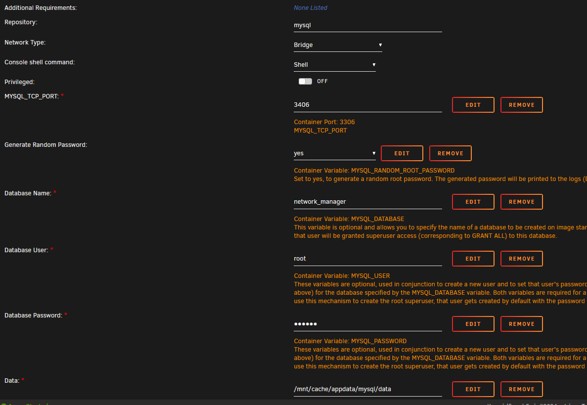

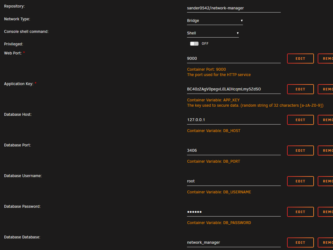

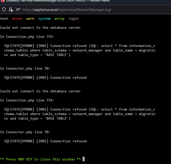

Hi Sanders. I've gone through the topics discussed here and haven't resolved this Network Manager database connection issue with the official MySQL docker image as per the attached screenshot. There's a 32 digit alphanumeric application key and MySQL root password configured. The MySQL database on launching the docker is network_manager.  I would very much appreciate any suggestions to identify and resolve this connection issue.
