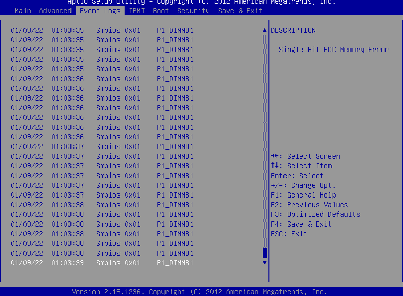

Got into the event log and sure enough there is something strange going on. For one thing, the first series of events listed is a string of single bit eec memory errors that occurred multiple times a second over the span of about 30 seconds back in last July. I have no way of really telling if that was really the extent of this event or if the log is maybe overflowing and old events are being removed as new ones are added. Anyone familiar with how the supermicro log behaves? Those events all applied to one DIM (P2_DIMMF1).
From what I recall, July was near the first time I tried to upgrade from 6.8.3 to 6.9.2 and that I only set up syslog because I was getting random crashes. Unfortunately the syslog doesn't seem to show what version of unraid is running or I don't know where to look for it.
Then there are no more events until yesterday 1/8 at 16:14 local time. I get a flurry of single bit errors from 16:14 to 16:17 all related to P1_DIMMB1. Then there is a break until 19:56 local time when P1_DIMMB1 starts having single bit errors until 20:03 local. There have been no other events since then. According to syslog it looks like I did the upgrade to 6.9.2 at 12:42 and after the reboot I see memory error messages in the syslog that don't seem to line up with any of the events in the bios log.  The last string of errors seems occur about an hour before I rolled back to 6.8.3.

Sreenshots in spoiler:
Spoiler

Single bit errors like you describe will always be hardware related.    It is possible a software upgrade can change the frequency as it may start using regularly a memory address that was not much used before the upgrade.
That makes sense, so my next step will be to remove the dimms that had errors and see if I get a stable upgrade afterwards. I'll check back in when I get a chance to do that. Thanks for the help guys,
