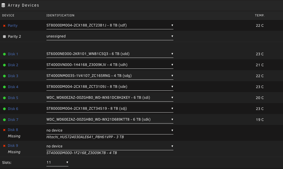

Ok I disconnected the parity drive and connected disk 8 up to the SAS cable that Parity was attached to. Its still showing as dead. Parity however is not showing at all. Was it just the wrong disk before? I have not changed the position of the SAS cable for the drives other than to trouble shoot them (see if the bad drive moved from parity to some other one thinking maybe the cable was bad).
Not clear what you mean, Unraid doesn't care how a disk is connected, it keeps track of the assignments by serial number

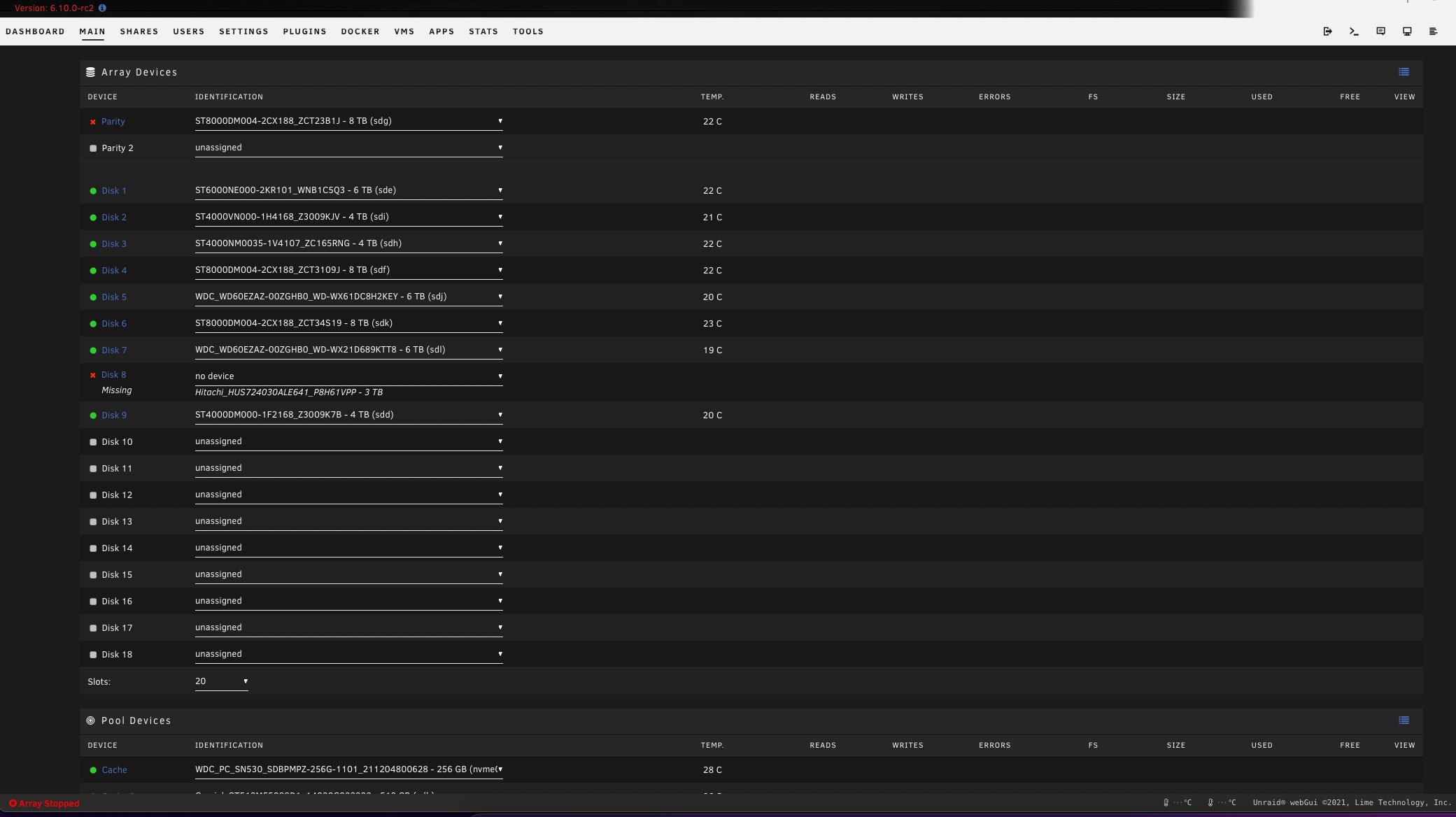

I am so confused right now. I reconnected my parity drive. Its still "Parity Device Disabled". The motherboard/sas recognizes it right? Now I somehow lost the 3rd disk again while reconnecting the parity back up. I swapped SATA cables and its still not coming back. I need to walk away from this for a bit. If you have any tips on how I can fix this I would really appreciate it because I am not doing too well right now.

Do any disks appear in the Unassigned Devices section on Main?
They do not. How is it unraid/system see the disks but I cannot enable them? If I unplug one then reboot the drive shows up as not even installed. Plug it back in and it says missing. I’m at a loss
The drive shows up when you unplug it? What does that mean? Where are you looking that makes you think it shows up?

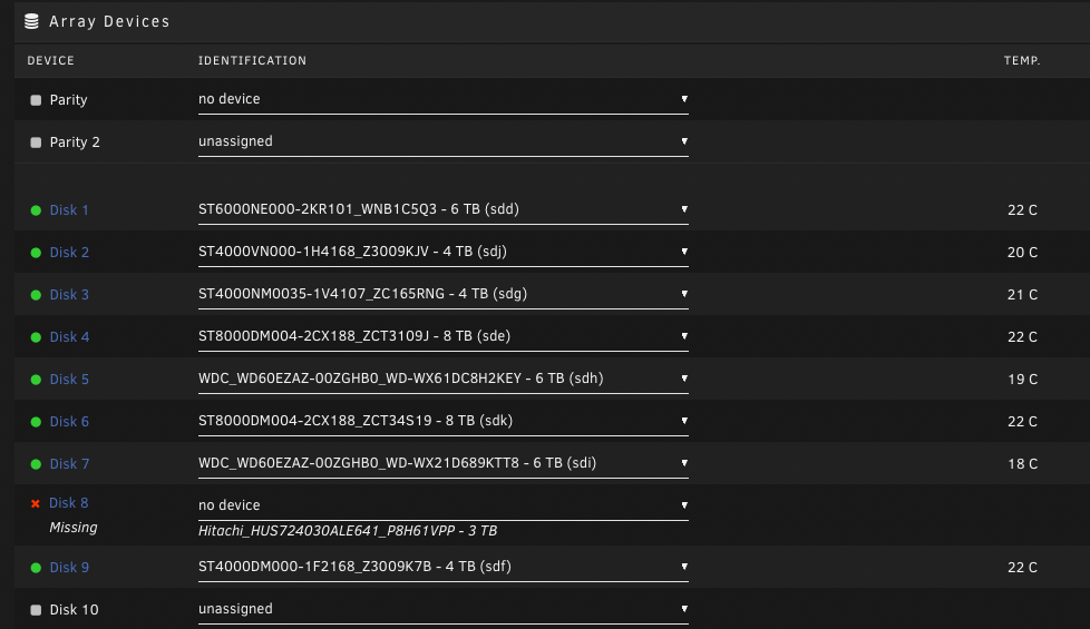

  1. New Config, Retain All, Apply. Assign disks as needed.
  2. Check BOTH Parity Valid and Maintenance Mode checkboxes and START the array. This will result in all assigned disks enabled and accepted into the array exactly as they are.
  3. STOP the array, unassign the disk to be rebuilt, START the array with that disk unassigned. This will result in the unassigned disk being disabled and ready to be rebuilt when it is reassigned.
  4. Reassign the disk and START the array to begin rebuild.
So the parity drive will function at that point? Thanks a ton I’ll give it a go tomorrow morning!
After step 3, the disabled disk will be emulated from the parity calculation. Hopefully, the emulated disk will not show as Unmountable on the Main page. The emulated disk is exactly what will be rebuilt when the disk is reassigned. If it is not Unmountable, you can even look at its contents with no disk assigned to that slot. In the more general situation, the emulated disk can be read and written even if there is no corresponding disk in the server, since only the emulation is used.
If the emulated disk is Unmountable, it may still be possible to repair the emulated filesystem before rebuilding, or repair the rebuilt filesystem afterwards. We usually recommend repairing before rebuild, but if you aren't rebuilding to the same disk it doesn't matter, since you won't be overwriting a disk that might have good data on it. And rebuild will be a good test that everything is working well. Only the rebuilding disk is written so nothing will change on all the other good disks.

I think we are good!
I had to sleep and quit panicking. So your solution DID fix the array. I was sure to follow it exactly and at the last step my server said "Unmounting disks... retry unmounting disk..." and it stuck there. I found on another thread to reboot the server. When it came back up It was unmounted and ready for rebuild. I am rebuilding now and I think its good to go. THANK YOU.
