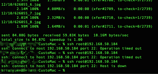

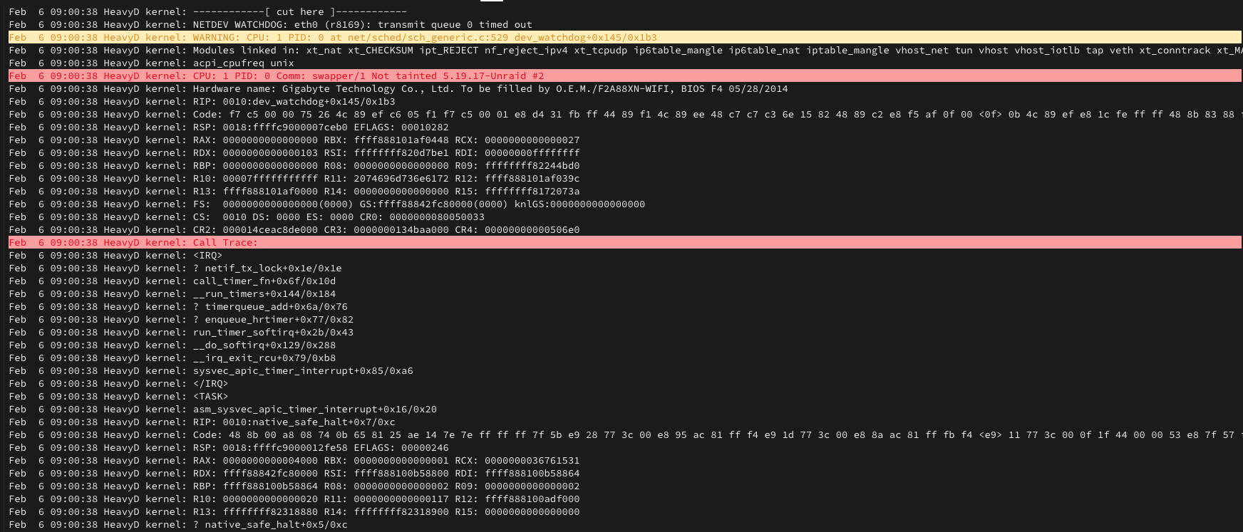

Ok, so it happened again.. and this time I've enabled syslog server. I just completed transferring about 85gb worth of raw photos when unraid went down at around 9am PST. Could not reach the web gui or able to SSH in. I left to run an errand for a few hours and came back to try again. This time the system was back up and I checked the logs to find a few warnings around the time it happened. See attached. Any idea what this could mean?
zip log and post
Looks like the Realtek ethernet driver crashed. Do you have another ethernet adapter you could try?
Hmmm.. unfortunately not. This was a motherboard that I used from my 2014 htpc.
