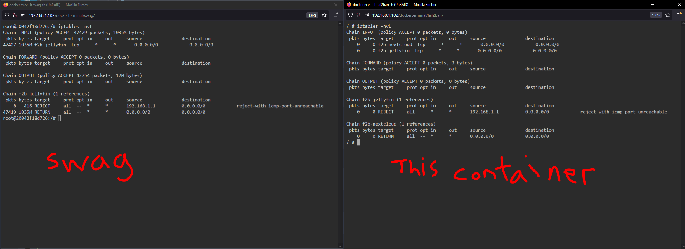

Ok So I have 2 instances of fail2ban.  One is this docker here, the other is the swag docker.  I have done identical jails and setups in both dockers.
Here I have banned myself in the jellyfin docker.  Take a look at what happens when I run the command iptables -nvL in both containers
It says Reject on both, but it looks slightly different on the left in Swags, have a return line.
I must note that swag is also running my reverse proxy, where as this standalone fail2ban container is not.  I do however have both containers running on my same custom network "proxynet".  Swags fail2ban works but for some reason this standalone fail2ban does not.

I am sure I must be missing something, but so far I have set up according to your instructions and f2b is reporting that my test ip gets banned. I can however still access the site.
Looking a bit further I can see that f2b docker host is banning the IP within the f2b container, and not in the Unraid iptables. Wouldn't this indicate that the ip never would get blocked, as the actual traffic does not hit the f2b container?
Or - as a I'm sure - I've missed something crucial. :)

Spoke too soon it seems. Fail2ban are correctly banning IPs, but doing so within the container, and not on Unraid.
Advice?
I can do everything except mod the IP tables to prevent access.  The filter identifies the failed access attempt and put in the jail but now action is taken.
The action example on docker website doesn't seem to jive with the jail example.
I'm very green.  I'll revisit in a few weeks.
EDIT:  Figured it out.  I had to load the container as HOST and made sure the banaction line in the jail.d match action.d conf file name.
Exactly right.  This fail2ban does not work with NPM to ban.  Instead it sets firewall rules directly on cloudflare
