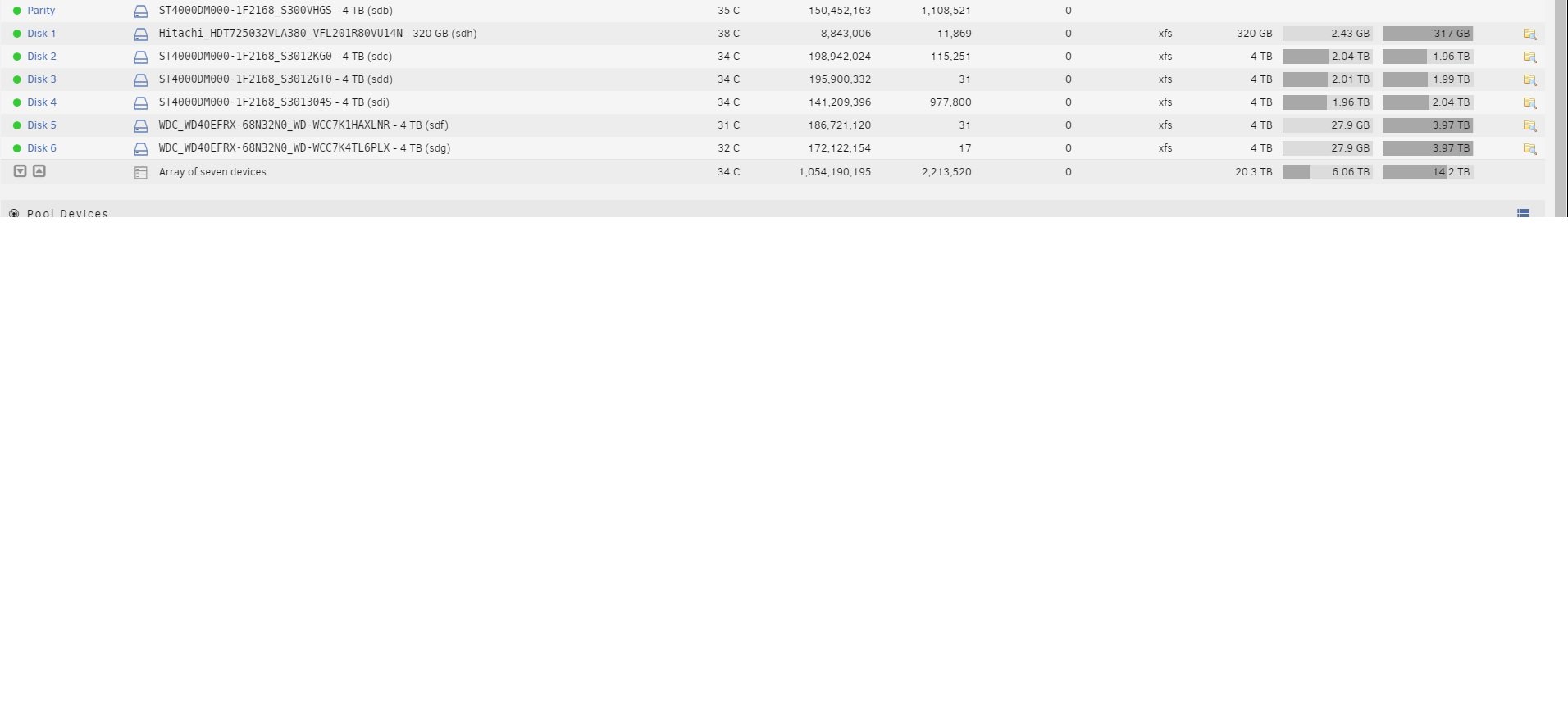

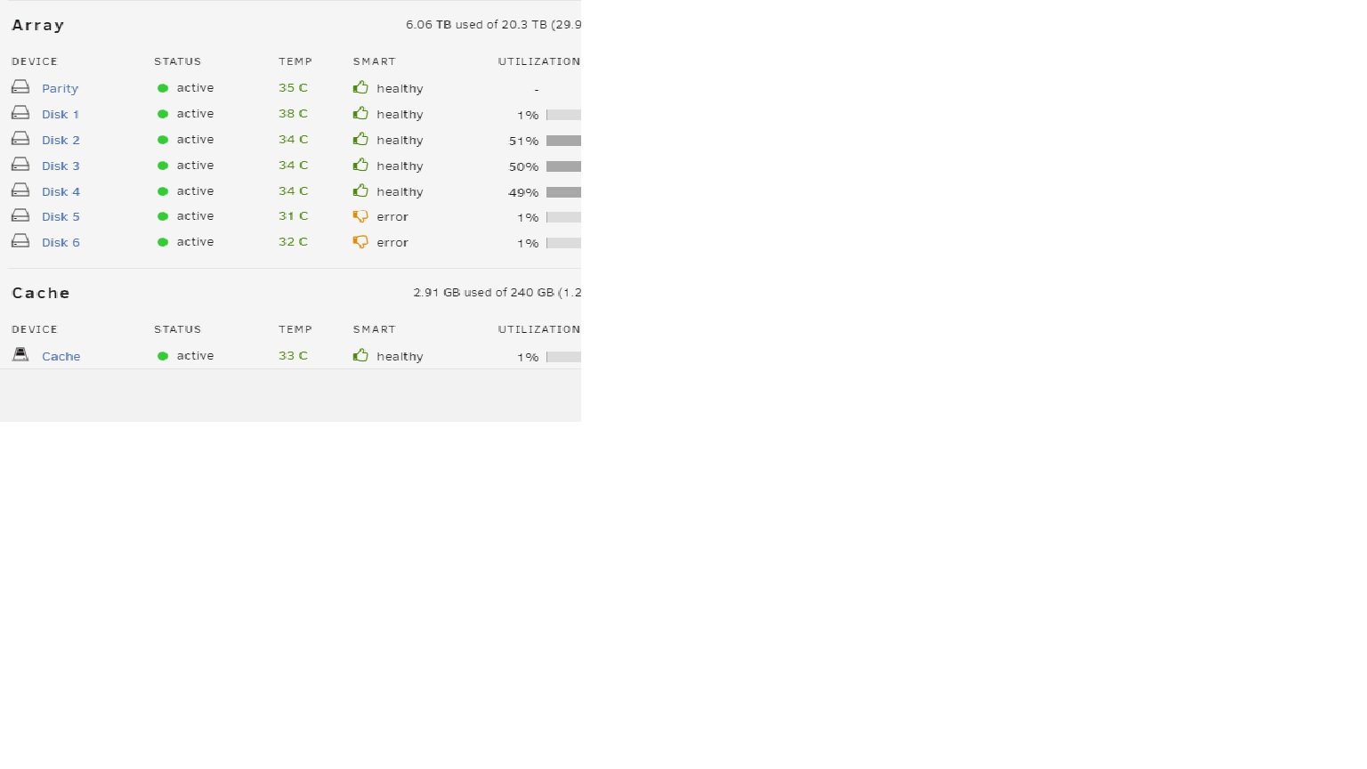

Hi i have 2 drive which i pout in server months ago now but to me nothing going on them i am not very good with this anyhelp would be good it is disk 5 and 6
You are likely to get better informed feedback if you post your system’s diagnostics zip file.
Default allocation mode is high water, it will start writing to disk5 once disk4 is over 50% used, and to disk6 once disk5 is over 50% used, assuming split level setting allows it.
what is split level setting and how do i check
I checked a few of your shares and they don't have split level set. Since you don't know what it is you probably haven't set it for any of them, which means split level will allow any of your disks to be used unless excluded from the share. Didn't notice any includes or excludes for any share or globally, so this is all about Highwater Allocation. That is the default for good reason. Just leave it alone and eventually all disks will be used.
I did notice that your appdata and system shares have files on the array. You want those all on fast storage (cache) and set to stay there so your dockers will perform better and not keep array disks spunup since these files are always open.

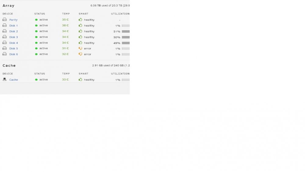

Thank you for reply so sorry how do i sort the second thing you said about sorry  and the other thing is in the second image i posted why does it show the two drives with a error
Edited by Sparky678911
Disk5 has 251 CRC errors, disk6 has 34. These are connection problems. You can acknowledge those warnings by clicking on them and it will warn again if it increases. If it increases frequently you need to figure out what the connection problem is.

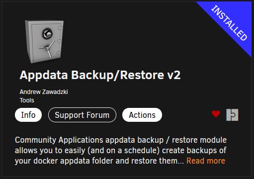

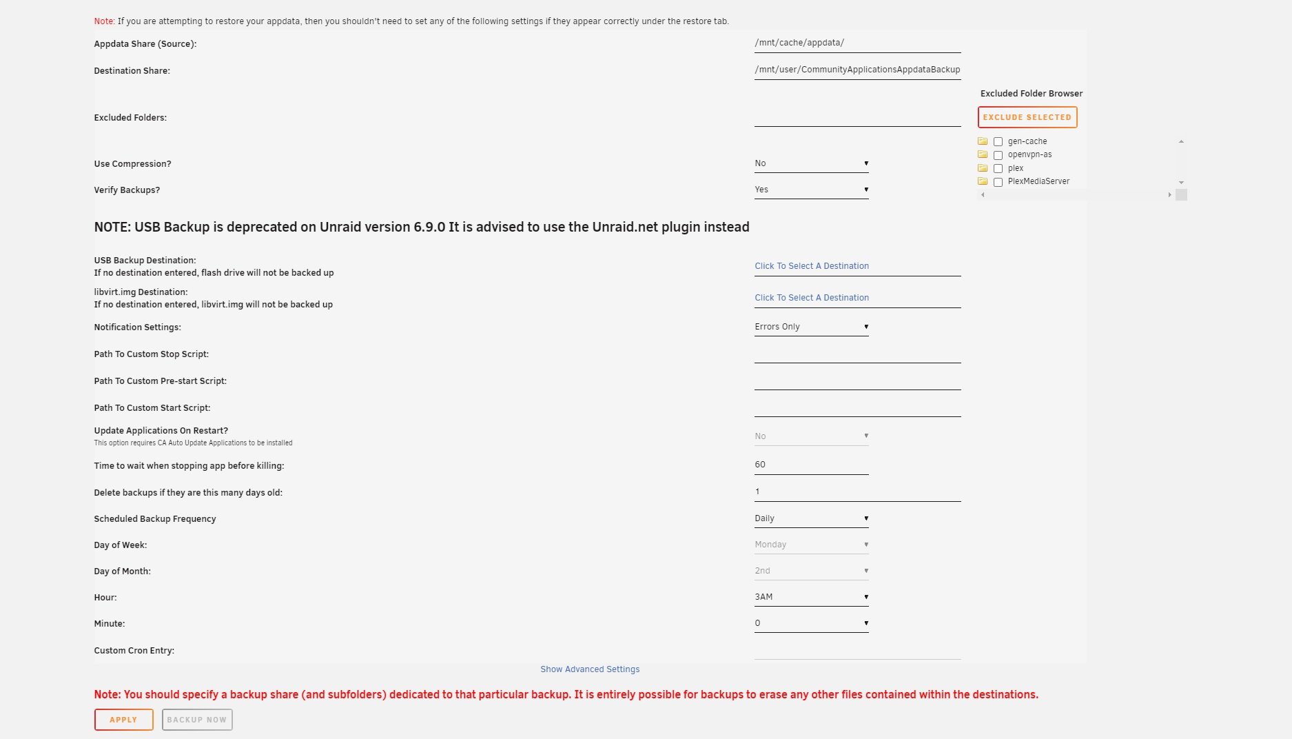

Thanks for help so i installed it image below do i need to do anything or is it self setup
Those default settings are safe. You will get a new user share named CommunityApplicationsAppdataBackup

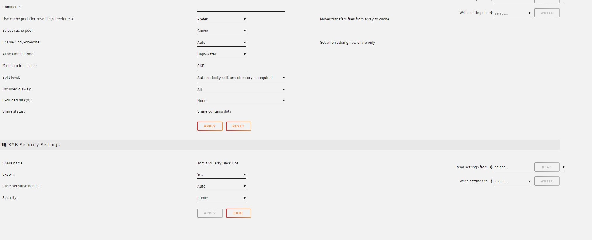

On 2/8/2022 at 3:58 PM, trurl said:
Set those shares to prefer cache so mover will move them to cache. Nothing can move open files, so you will have to disable Docker in Settings before running mover.
Thanks for help so on this is there any instructions on how to this this please sorry if sound a bit stupid i do not want to muck up or loose anything thank you
7 hours ago, Sparky678911 said:
instructions
Click on each share to get to its settings

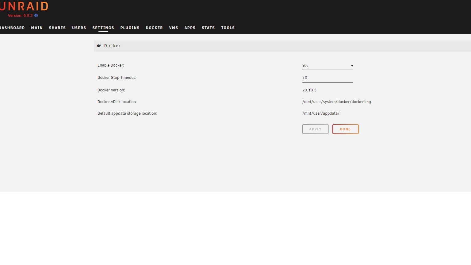

Settings - Docker

Settings - Docker

ok when i click on each share i can not see anything that says docker
Docker is an option under Settings - not a share level setting.
if this is it then i was told to do for each share but you cant
No, that is not the option you were told to set for each share.   You were told that after setting the Use cache=Prefer setting for the relevant shares, you need Docker to be disabled before running Mover.
is this the right section sorry to be a pain
