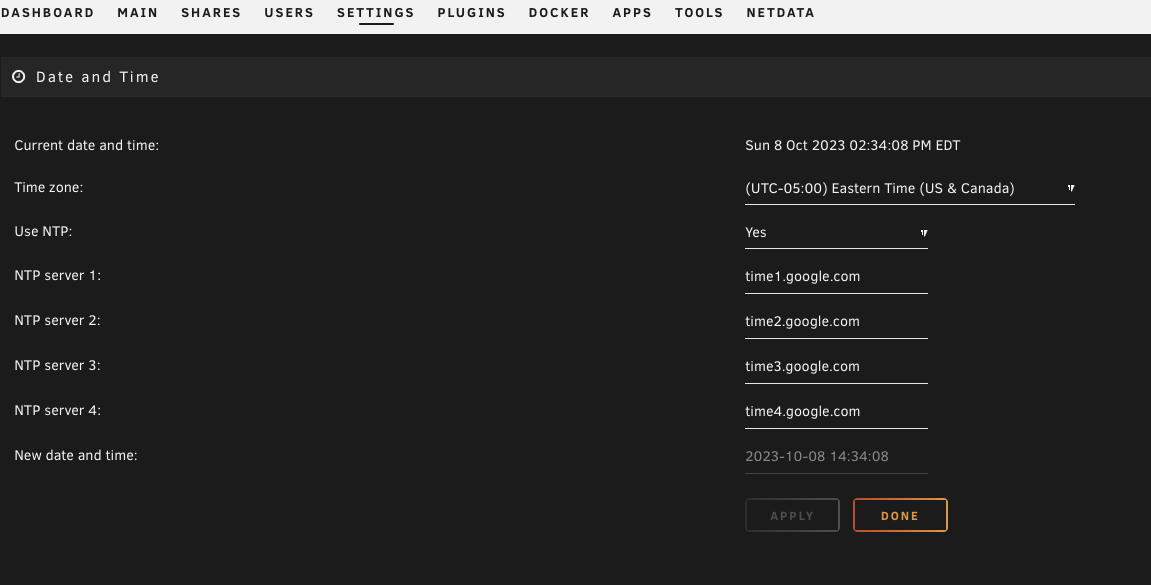

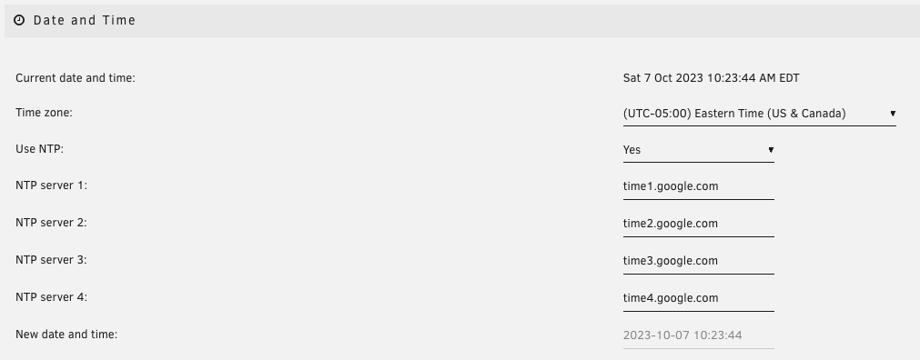

Date and Time Incorrect
Most services on the internet require the correct (or nearly correct) date and time to be set on your server.  Your server appears to have a date and time that is incorrect by a significant amount.
You should set the Date and Time correctly within Settings - Date and Time and if necessary also use NTP servers so that the date / time will stay up to date.
Note that this problem could also be indicative of a failing CMOS battery on your motherboard (usually a CR2032) and you may want to look at also replacing it.
