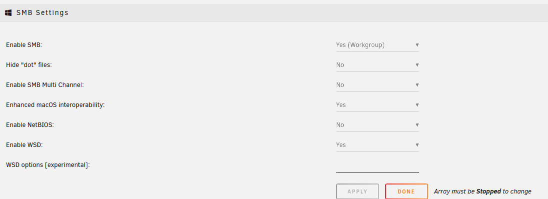

This is what my Unraid Settings an HP Setting look like.
And also attached the error message...

Enabling NetBios will enable SMB v1
Yes, that is the solution.
