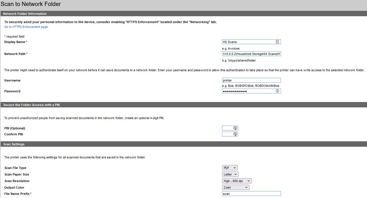

  8. Its sad no-one has replied. I just got a used M477fdn, and was tinkering with its settings. I wanted to get Scan to Network functioning, but when I do "Save and Test" it fails. I made the printer its own user in UnRaid. The fields that could be wrong are "Network Path" and I have "\\10.0.0.2\Household Storage\04 Scans\HP StN" 10.0.0.2 being my server address. "Household Storage" being the Share and the the nested folders from there. If anyone has set this up, and can help myself and @henris I, and no doubt he would be thankful.

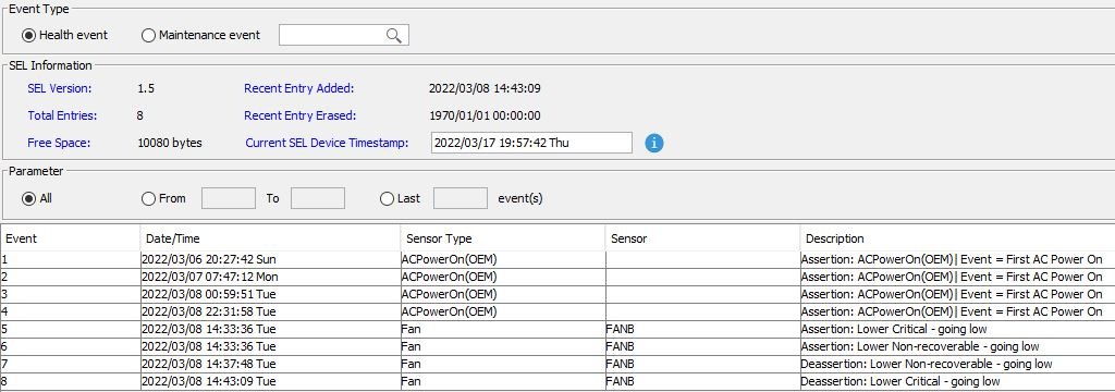

  14. So, from the IPMI logs, maybe it is the PSU? But maybe its just... Sort of failing, because of the Sata Rail? Ugh.
