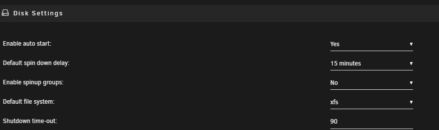

You mentioned that the shutdown, after which it ran a Parity Check was clean; but you also mentioned that shutting down the array took a very long time... If the array does not shut down in 90 seconds (that's what mine is set for) it will foce the issue and do an unclean shutdown.
