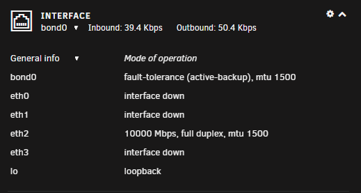

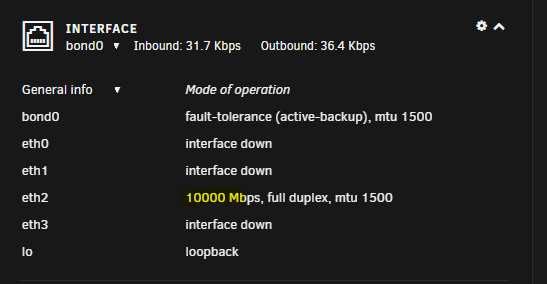

Each server has a VM and all updated windows 10, on the AMD server I can max out my internet 1.4gb down on a speedtest, the Dell server I cant seem to get over 1gbe, unraid says its connected at 10gbe on the Dell. I know the dell is older equipment but, why the slowness.
I took a 6gb iso from my laptop which is hooked up 2.5gbe to the same switch, I was able to write to the AMD server at 280 MB/s (maxing out my nvme). I did the same test with my Dell which as a 2.5 SSD, i know its not as fast as the nvme, but I can only get 80 MB/s on the transfer.
Something is bottlenecking the Dell and I cant tell when it is. Any Ideas on why slow on the Dell Server?

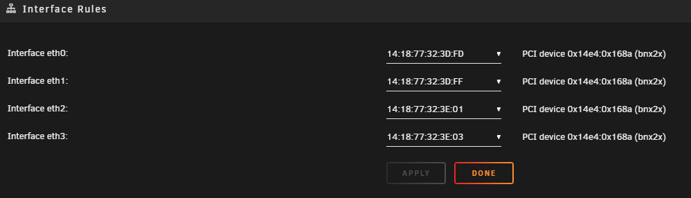

is this what you are talking about
Yes you are bonding your connections. Change bonding mode to no, and change bonding members to eth0.
Well that was a hot mess, had to blow away my network config on the flashdrive 4x
I am ruling that the card that I got is either bad or the drivers are not loading correctly. In the list of ports, the MAC address's are all the same for each port, and at the bottom of the screen they all have individual ones, when I make the changes like you recommended the server boots to no IP and cant access anything via the GUI. I have it set how it was, and when I get some $ and time I will look at another card for the server, but the weird thing is though it does say connected at 10gb on the main unraid page.
After work I will try iperf to see what the actual speeds are
You need to change the adapter setting for eth2 to eth0 so unraid uses it. If you go to setting->network setting you should see the below settings. Change the NIC Mac for eth2 to eth0 and reboot. Unraid will then use your 10Gb connection.
Here goes nothing!
You sir deserve a beer (or redbull if beer is not your thing, lol)

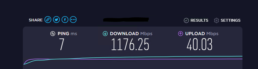

that worked and ran a speedtest on the VM and not as fast as my newer server, but I expect that. BOOM!
