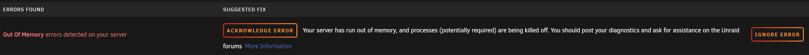

Out of Memory on v.6.9.2
I keep getting these errors and following the below I have attached the l before rebooting
Running Unraid v6.9.2
Hope some one can share some light on what is causing this?
I am looking into upgrading the memory to 128G but is very expensive 😞

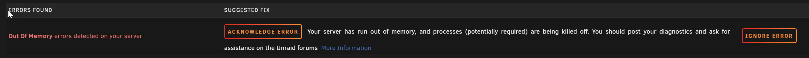

Just received the same error again?
I do a reboot and after some time I get this error again....
I've just started getting the same error today - also on 6.9.2
Also posted my diagnostics separately before noticing your post.
OK it just got very scary my docker failed to start and I had to do a manual start in the terminal (No logs where visible)
I then got the error shared drive not available - and I noticed that ALL MY SHARED DRIVES WAS GONE!
Found the above post and it said that this could be caused by memory problems

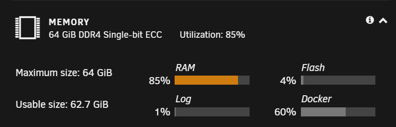

I have defined memory limits on my dockers and VM's the utilization is high but okay, I guess its the spikes that causes this?
I am between 65% - 85% high
