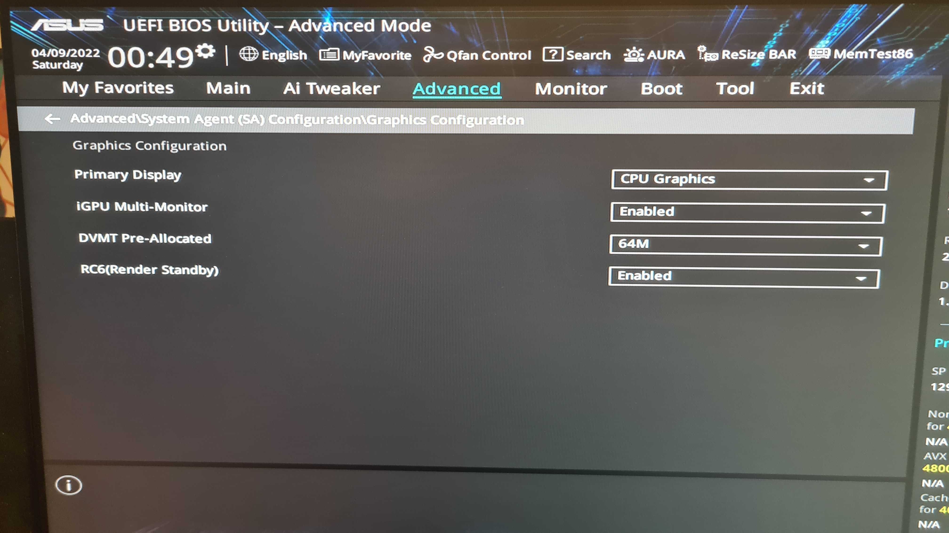

I don't think this is actually an unraid problem but i'm not sure where else to turn. I'm trying to get my igpu to be recognised.
I think i have my bios setup correctly (screenshot). but when i type cd dev/dri nothing is coming up.
Any ideas?
Specs are i5-11600 with an Asus Prime Z590-A

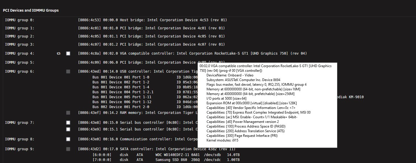

Do you see i915 loaded for the igpu if you hover on the system devices page?
Yep its listed there.
I've just had a look in the modprobe.d folder under config and its empty...could that be my issue?
When i load into gui mode i just get a black screen and a flashing text line at the top

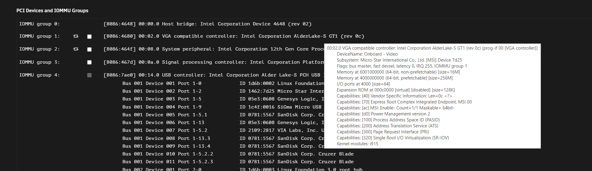

Sorry error on my part the driver is not loaded, Should look like this.
My i915 is blacklisted. You could try touch /boot/config/modprobe.d/i915.conf to see if that resolves the issue but should be loading by default.
Do you see anything in the logs? I have an alderlake so need to add an option.

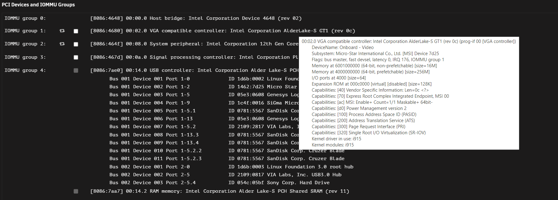

 Sorry i don't understrand, whats the difference? other than mine lists the UHD750?

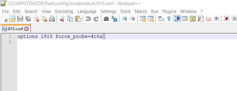

Ok your CPU needs a force probe also. Have a look at this tread, but I am not sure which one will be for yours.
Format will be similar to this. If you run modprobe i915 you should see correct version in the syslog.
Okay,
Been trying a few different things, nothing working so far.
Tried the force probe as shown in your notepad screenshot. no joy
tried the same again with "options i915 enable_guc=2" also added, and also tried deleting them and adding i915.force_probe=4c8a to the syslinux config
Nothing working.
