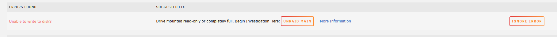

I got an error from Fix Common Problems. I don't think currently the parity disk can write to it. Should I just wipe the disk and reconnect to the array.
Since only one disk is impacted the parity disk could rewrite the data

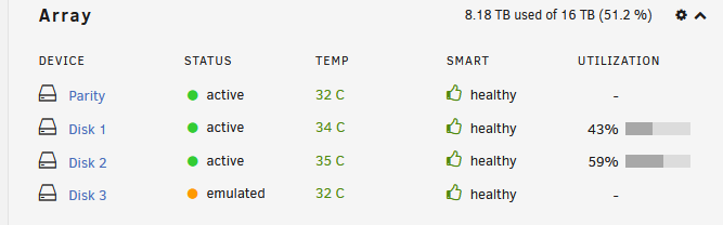

Sooo I messed this up big time. My initial assessment was correct.
Steps I took in the past hour
- I stopped the parity check.
- turned off the server
- disconnected disk3
- powered on the server
- unraid started, the array didn't start. I found it strange it didn't try to emulate Disk3. I opted for the array to be started as I tough emulation might kick in after...at hat point I realized that my original assessment was correct. When I was working with the 2 disks connected to the VM and I removed and reconnected one the disk allocations must have changed without me realizing it. And when the VM started for the second time not the two unassigned disks were connected but the parity disk and Disk3.
- I turned off the server again
- reconnected Disk 3

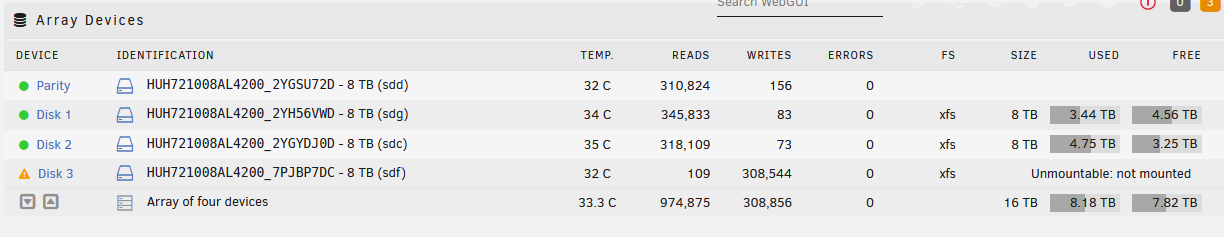

The array didn't pick the disk up automatically after the reboot. Probably because the partition table was missing.
- I added Disk 3 as a new config. The disk is now in the array sort of but not mounted.

I have no idea how the parity disk is is green?!? I have a feeling I have deleted the partition table from that accidentally as Disk3 was never emulated.
Data should still be present on Disk3 but now thinking back I might have reformatted as a quick format to ntfs.
Is there a way to restore this?
How can Disk3 be emulated and un-mountable in the same time?
Any disk can be flagged as unmountable regardless of whether it is emulated or not if there is file system corruption or problems recognising the partition.
How can I correct/recreate the partition table on disk3? The raw data should still be present on the disk so should should be largely a logical issue, no?
If you hadn't run a parity check it would likely be much easier to recover, check filesystem on disk3, it might still be salvageable.
