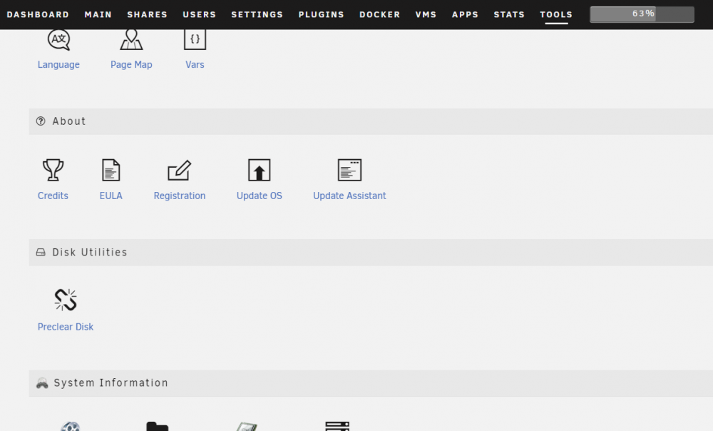

I took a quick screen shot.
UPDATE: I just reviewed my plugin list and there is UNNASSIGNED DEVICES PRECLEAR there. When I click on that it does show me the header of what would be values if a disk was there doing a preclear. What was odd with mine, the precleear started by itself but never showed up on that page. If this is the plugin that kicked off my disk preclear is it supposed to show up on that preclear page?
