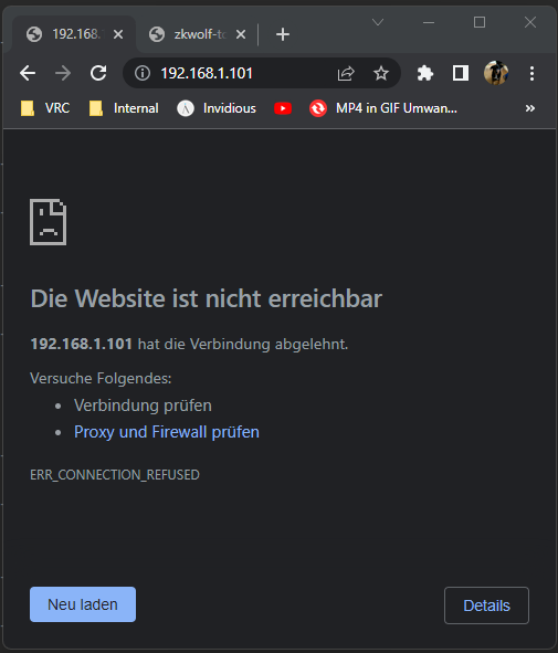

Output of curl:
C:\Users\jerem>curl -l http://192.168.1.101/
curl: (7) Failed to connect to 192.168.1.101 port 80 after 2044 ms: Connection refused
C:\Users\jerem>curl -l https://192.168.1.101/
curl: (7) Failed to connect to 192.168.1.101 port 443 after 2062 ms: Connection refused

Still get ERR_CONNECTION_REFUSED

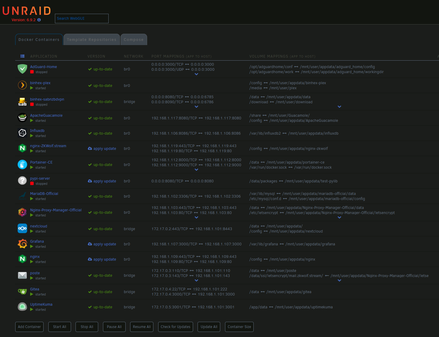

Do you have a Docker container that is already running on port 443? If so, then to setup SSL for the webgui you will need a different port, perhaps something like 2443 or 3443, as long as it is not already in use.
No I have all of my dockers on other IPs except a few that use different Ports.

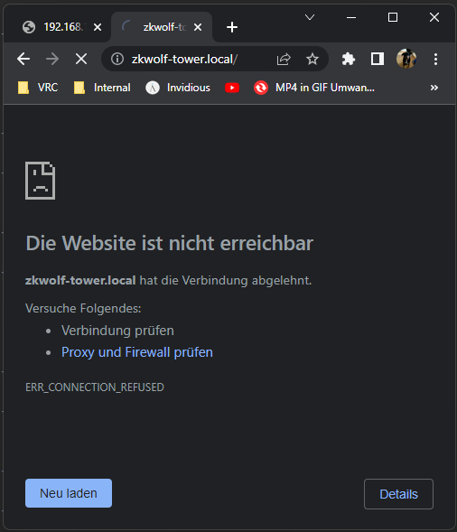

I just set SSL/TLS to Auto and I get the ERR_CONNECTION_REFUSED again on https://zkwolf-tower.local and https://192.168.1.101/.
I also changed to Port to 9443 and still Connection refused.
You are jumping ahead :)  You should still be able to login at the http url right?

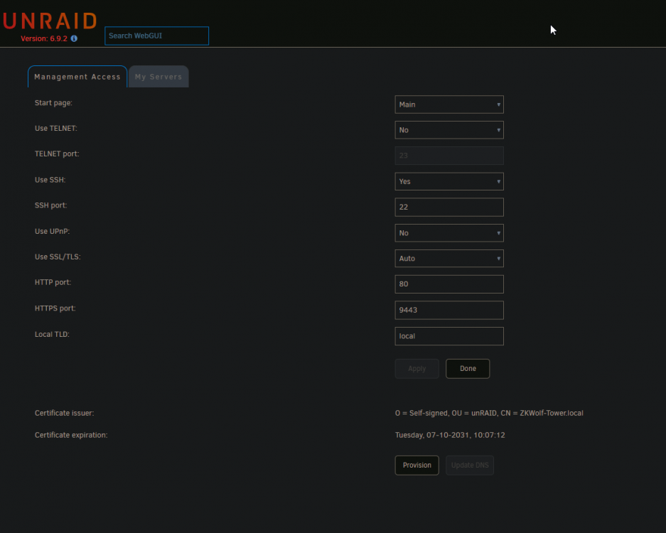

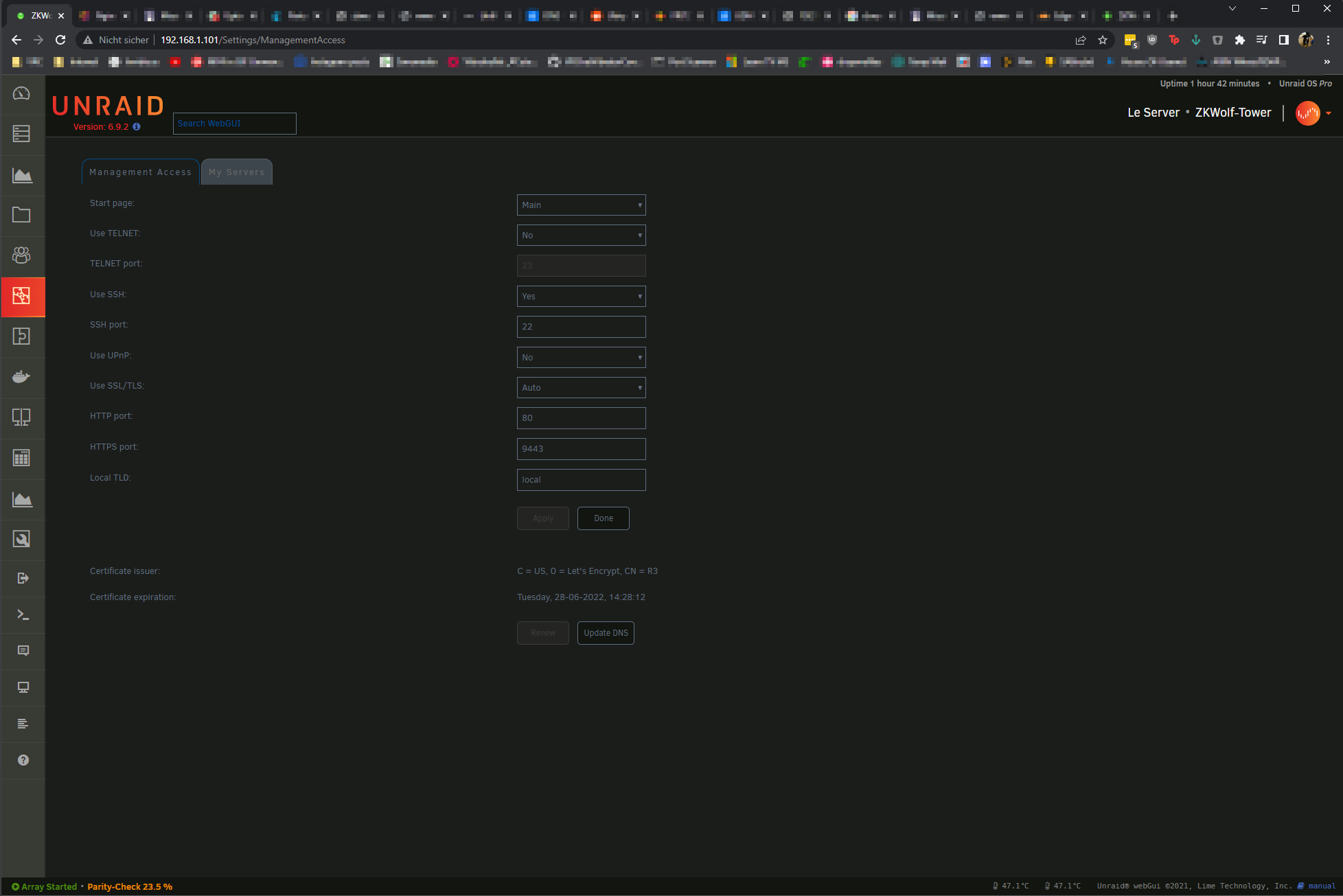

What do I need to do? My current config:
Just a thing I want to say is that when I paste a Screenshot from my ClipBoard to a Reply it Uploads it twice. Don't know if its a me problem. 😅
FYI, Unraid 6.10 came out of beta this week. 6.10.1 is the current stable release of Unraid.
But that is fine, we can stick with 6.9.2.
Go ahead and press Provision. Because Use SSL is set to "Auto", this will replace the self-signed cert with an official Lets Encrypt certificate and change your Local Access url to https://yourpersonalhash.unraid.net:9443

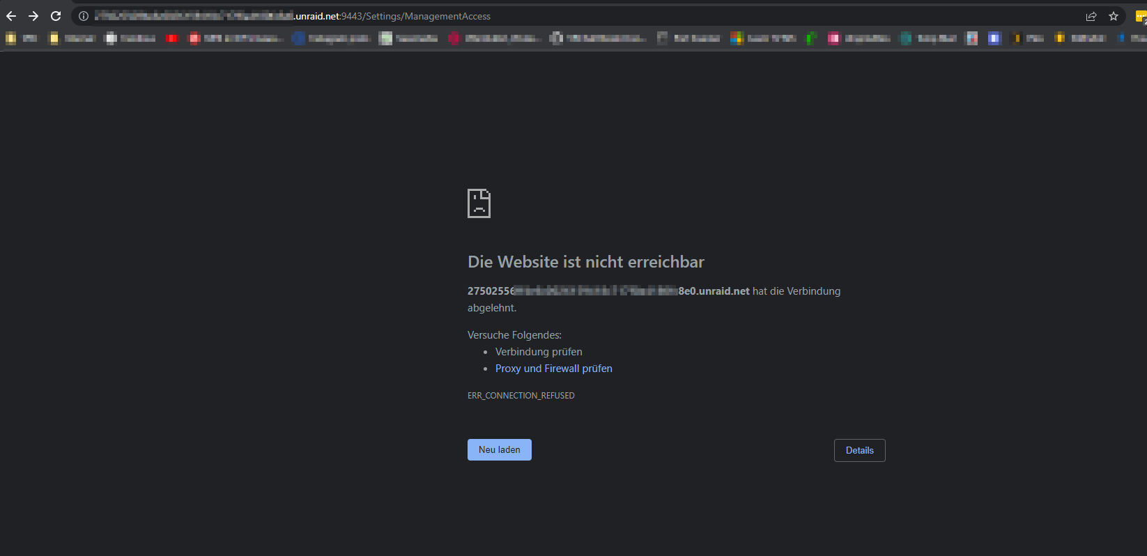

I did and it redirected me to https://hash.unraid.net:9443/
But no access.

Try to ping hash.unraid.net (use your actual hash through :) If should resolve to your server's ip address. if it doesn't yet then wait a bit for DNS to propagate.

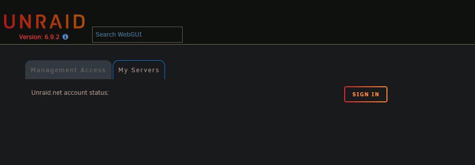

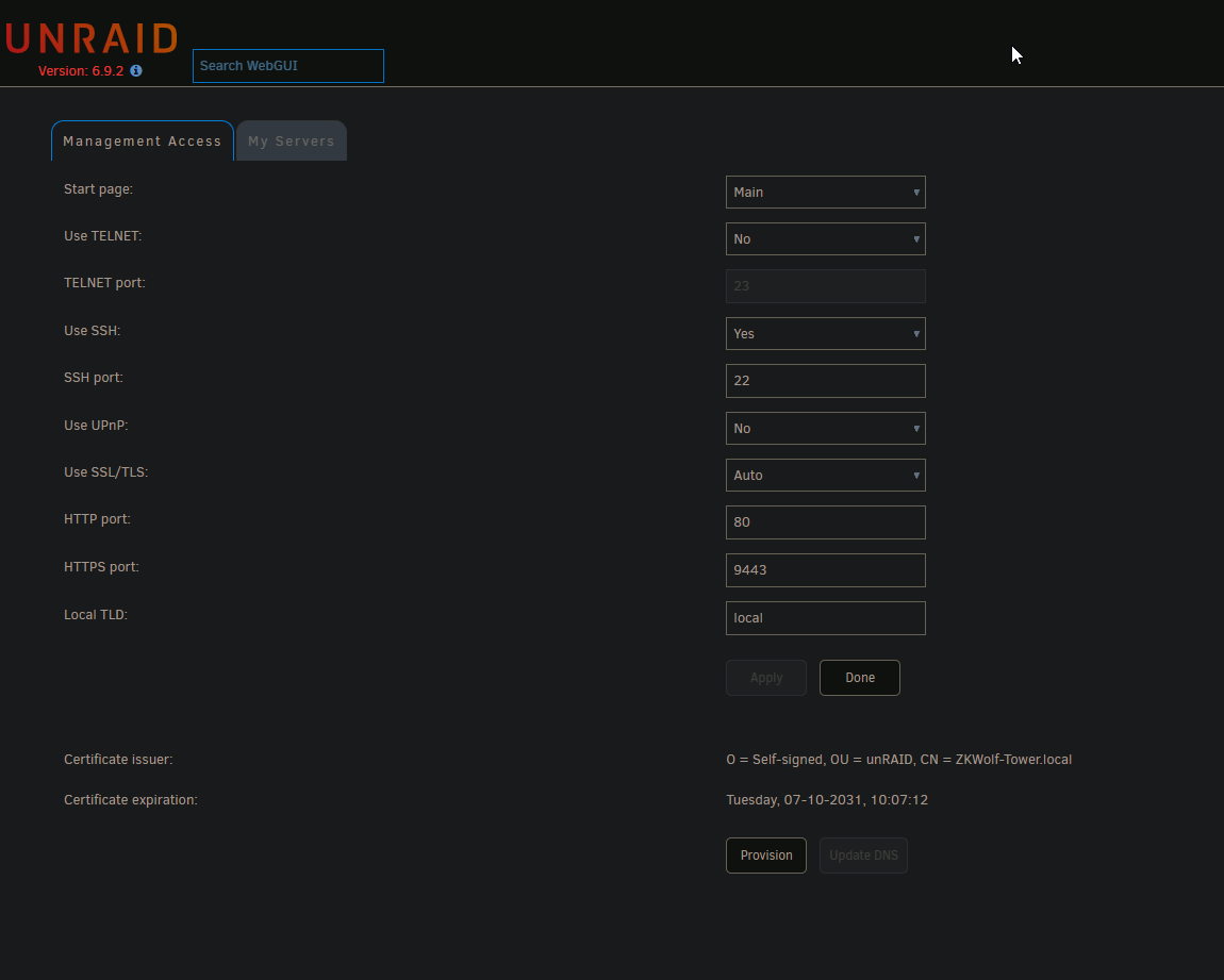

You mentioned you can still get in via http, which is odd as well. Please login and go to the Settings -> Management Access, would you mind taking a screenshot? block out your hash if you can
I might be blind... But I don't see my hash here?
Anyway this is the Screenshot:
Sorry, I'm thinking of 6.10

then trying to open files referenced in configuration...
nginx: [emerg] cannot load certificate "/etc/ssl/certs/unraid_bundle.pem": PEM_read_bio_X509() failed (SSL: error:0908F066:PEM routines:get_header_and_data:bad end line)
nginx: configuration file /etc/nginx/nginx.conf test failed
Invalid configuration, Nginx not reloaded
root@ZKWolf-Tower:~#
And http://IP/ does not redirect. Everything is still accessible via that address.
I tried https://HASH.unraid.net:9443/ again but still nothing on there.
If I need to I can Upgrade to 6.10.1 because as you said its released.

Thanks! I'd recommend that you delete the bad cert:
rm /boot/config/ssl/certs/certificate_bundle.pem
especially if you choose to upgrade to 6.10, that will smooth the upgrade.
Rebooting is fine.
You are also welcome to try provisioning again later, just delete the cert again if it fails.
Hi @ZKWolf we've resolved the issue with your cert. Please open a web terminal and run:
then press Provision again. Your url should change to https://hash.unraid.net:9443
