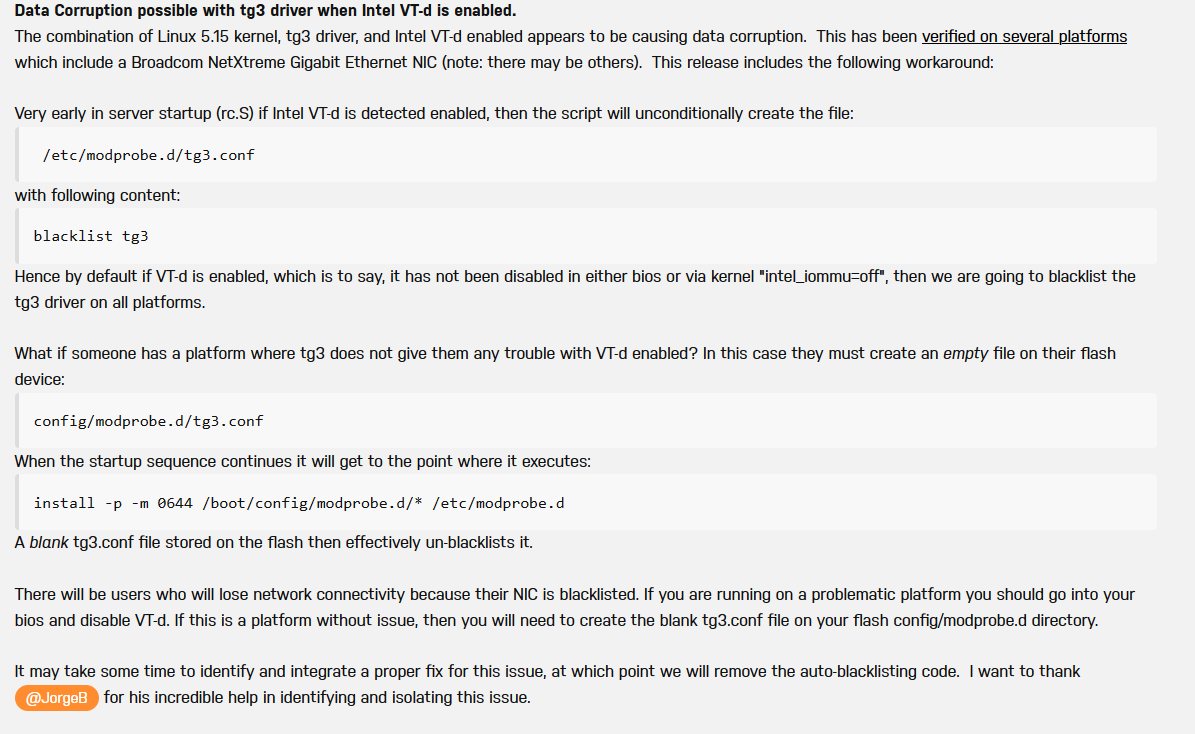

From the release notes:
There are number of the Dell Server products that use this NIC driver.  You get the diagnostics file by using console monitor and key board.  After logging in type at the command prompt:
diagnostics
That will write the file in the /logs directory on the boot drive.  You can shut the server down with a quick push of the Power Button.   Look in the ethtool.txt file in the /system folder and see if the OS installed a driver of eth0.
diagnostics
should this be done before or after the upgrade.. and what if the OS did not install the eth0 driver?
