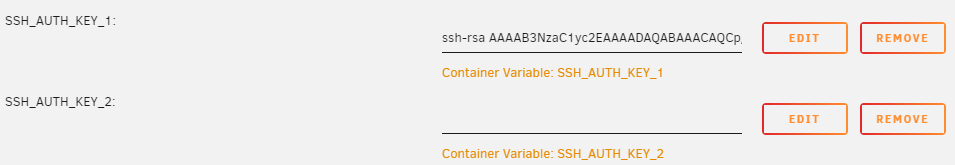

mgutt Posted June 10, 2022 Share Posted June 10, 2022 Overview: rsync-server Docker: https://hub.docker.com/r/eeacms/rsync Github: https://github.com/eea/eea.docker.rsync This is a simple rsync server based on Alpine. To be able to connect to this rsync server you need to add the SSH key of your client to the variable SSH_AUTH_KEY_1. You can pass multiple keys through the additional variables SSH_AUTH_KEY_2, SSH_AUTH_KEY_3, etc. Example The benefits of this container are: you can define a non-default SSH port for rsync only (default of this container is 5533) you can define specific paths instead of allowing access to the complete server (default is /mnt/user) files access is read-only (protection against ransomware) Quote Link to comment
mgutt Posted June 10, 2022 Author Share Posted June 10, 2022 How to create an SSH key? Log into your client machine and create an SSH key as follows: ssh-keygen -t rsa -b 4096 Press 3x ENTER to use the default location and create the key without password. Now display your SSH Key with the following command: cat ~/.ssh/id_rsa.pub Copy the complete line like "ssh-rsa AAA.... username@client" and paste it in the field "SSH_AUTH_KEY_1" and start this container. You can test the connection from your client as follows (replace "tower" against your server name or domain): rsync --dry-run --itemize-changes --archive -e 'ssh -p 5533' root@tower:/mnt/user/system/ /tmp Quote Link to comment

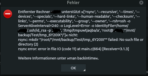

Revan335 Posted June 15, 2022 Share Posted June 15, 2022 Thanks for your great Docker/rsync-server! Is your rsync-server working with Back in Time? Quote Link to comment
mgutt Posted June 15, 2022 Author Share Posted June 15, 2022 Your target is /mnt/backup while it should be /mnt/user/backup and regarding the "no such file or directory" you need to use this fix of Back in Time: https://github.com/bit-team/backintime/issues/1253#issuecomment-1126770876 Quote Link to comment

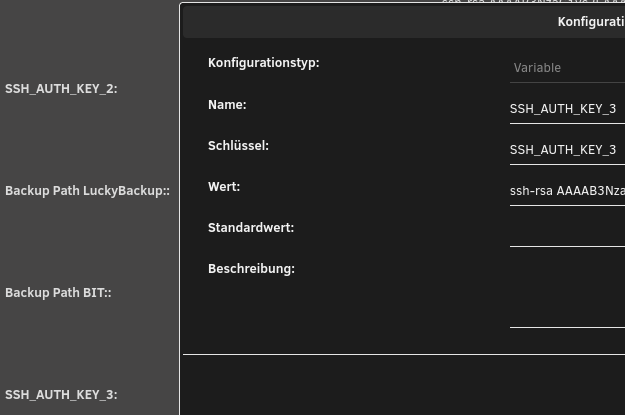

Revan335 Posted September 4, 2022 Share Posted September 4, 2022 Is it allowed to add more keys or is that not supported/not working? Quote Link to comment
mgutt Posted September 4, 2022 Author Share Posted September 4, 2022 1 hour ago, Revan335 said: Is it allowed to add more keys You can add an infinite amount of keys. There is a loop which reads all of them: https://github.com/eea/eea.docker.rsync/blob/master/docker-entrypoint.sh By that even SSH_AUTH_KEY_BANANA or SSH_AUTH_KEY_BABALALADINGDONG should work ^^ 1 Quote Link to comment

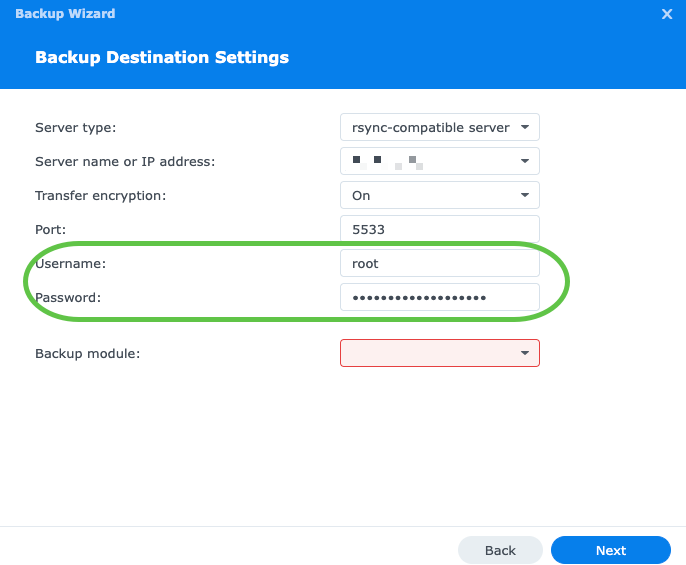

The_Holocron Posted April 12 Share Posted April 12 I am looking for a viable solution to do a local backup of data on my Synology NAS to my Unraid box. I'd like to test the rsync options, but the setup on the Synology requests a user/password. I've noticed that some of the other docker images for an rsync-server include username/password fields. thoughts? Quote Link to comment
