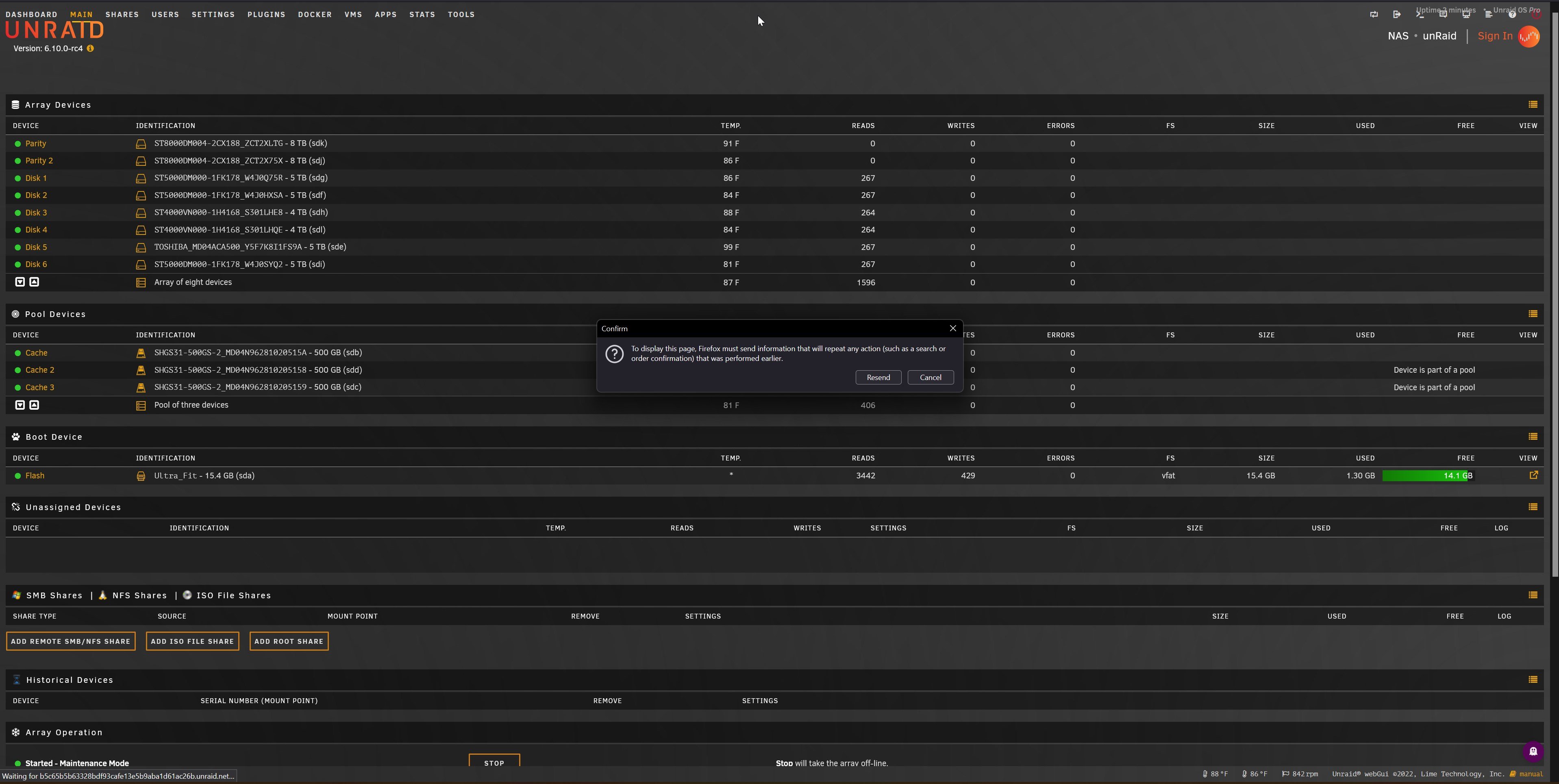

Hi, I just encountered the same issue (within a lab which is running 6.11.5). Using Firefox 111.01 i get the same issue of start array > prompt > hit resubmit > stale configuration.
Note: I was previously able to login to this server without this issue, cannot recall what version of Firefox I was running when i last accessed this server.
Signing in via the Edge browser seems to work without such a prompt. I have attached a screenshot of the dialog. The workaround (clicking on cancel in the prompt) isn't too difficult to do but would be good to understand the root cause.
I have included some diagnostics if they are of use to anyone. (captured after attempting to login via Firefox and clicking on resubmit on the dialog). Thanks,
