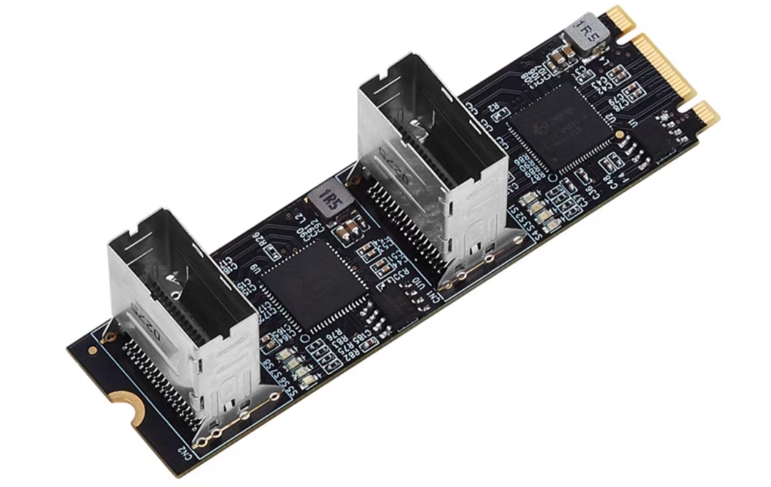

July 25, 20224 yr It even have 8 SATA (two 8087 socket) version, look like have two Jmb585 controller and test got min 190MB/s per disk.
July 25, 20224 yr 4 hours ago, Vr2Io said: It even have 8 SATA (two 8087 socket) version, look like have two Jmb585 controller and test got min 190MB/s per disk. Can't be two jmb585 without a PCIe switch (or a very bizarrely configured [chipset] M.2 slot with "self-bifurcation"). More likely ONE jmb585; and one jmb575 port multiplier. Cute, still ... Edited July 25, 20224 yr by UhClem
July 26, 20224 yr 8 hours ago, UhClem said: Can't be two jmb585 without a PCIe switch (or a very bizarrely configured [chipset] M.2 slot with "self-bifurcation"). More likely ONE jmb585; and one jmb575 port multiplier. Cute, still ... Agree, if look at two chip, one seems have more pin then other .... check their spec, 585 is QFN76 and 575 is QFN64. The model name was IO-M2F5875-8I http://www.iocrest.com/index.php?id=2335 Also Orico have 6 port product .... it look like Asmedia solution.
