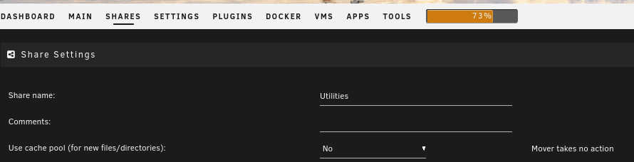

July 26, 20224 yr 40 minutes ago, doobyns said: where is the setting in shares to avoid using the cache for smb ?

July 26, 20224 yr 3 hours ago, doobyns said: I use my cache as "read only", some data only copied on the cache but all my files stay safe on the array Still don't understand what this is trying to accomplish though. Files on cache and files on the array are both part of user shares. The idea that all files are on the array and also some files are on cache. Doesn't make any sense. If you make a share cache:no, no new files will be written to cache, but all files on cache and array are included in the user share.

July 27, 20224 yr 15 hours ago, doobyns said: I understand that i just have to make a top level folder on any pool and it will be considered by the filesystem as the same as it would be selected as "cache" in the gui. If a share is created automatically in this way, it will have default settings. One of those defaults is cache:no I just tested this by creating a top level folder directly on cache. The resulting user share is cache:no despite the fact that it only has files on cache. So any new files would go to the array.
