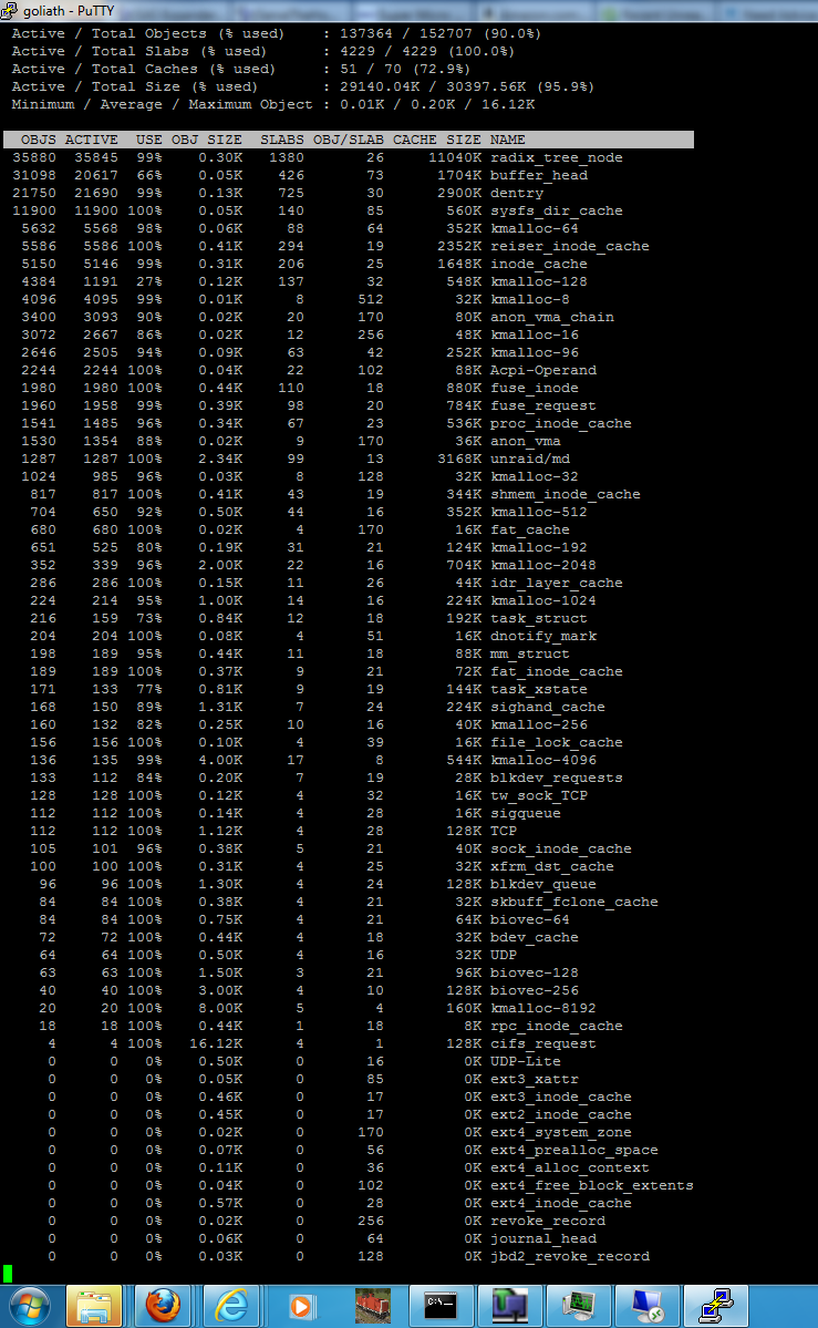

it is a capture of "slabtop"

max_depth=9999 looked deeper then I needed so i did a  "cache_dirs -q" and stopped it.
no change in RAM usage.
well, now I'm confused.
I rebooted to see what happens. everything was back to normal.
I start watching a movie on my XBMC box (just a samba read, "top" shows it as smbd) and the memory starts getting chewed up again.
I pause the movie... the memory stops counting down.
i resume the movie... the memory starts getting eaten again.... and so on.
any ideas?
