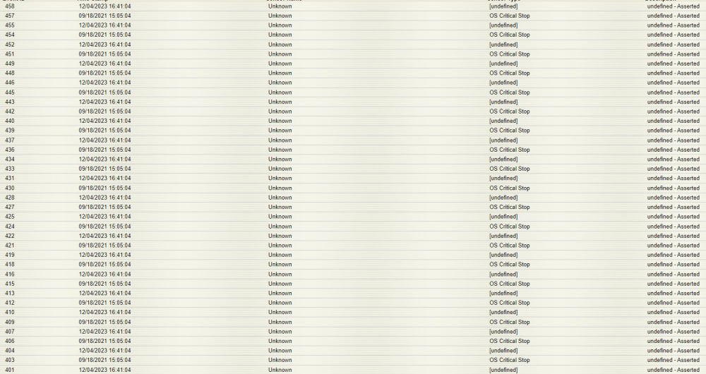

August 24, 20224 yr Author Well I'm at a complete loss now... Finally had some time to look into what going on. My IPMI is now showing over 400 events. (see pic below) The same two things over and over again.. But the timestamps make absolutely no sense. I booted up the server, and when I tired to access the webui i get an nginx error. I log into the terminal and the aspect ratio is super wierd, it shows I have no dockers isntalled, all my cache drives are showing as unassigned, and it freezes, then reboots. This is with no GPU installed, btw. So where before I would only have issues WITH a gpu, it's not just gone to absolute shit. I think im going to have to backup all my data and assume this server is going to fail completely sooner than later. I dont think its going to stay alive long enough for me to grab diags anymore, so maybe syslog will give some idea.... Question, does the syslog include any sensitive info? Or am I goo to post it? I've not seen anything sensitive as I scrolled through it, but I want to be sure before I post it. Also, I watched the entire boot up process, and something about CPU errors. I have another pair of CPUs im going to drop in and see what happens. Wish me luck...

August 24, 20224 yr Author I thought the CPU error I was seeing was related to memory that needed to be reseated. During the CPU swap a RAM module must have developed a poor connection, because after re-seating them all it was fine and the server ran for about 9 hours without issue, then about 2 minutes ago it rebooted out of nowhere again. Now Im seeing the CPU errors again. Im going to have to assume the motherboard is faulty, I don't know what else it could be. The strangest part to me is that it has never once crashed while booted into windows/linux/etc. ONLY unraid. Regardless, I'm going to replace the mobo. I said previously that the mobo had been replaced, and that's sorta true. I had ordered another, installed it in this server, and still experienced a problem (this was 8-10 months ago) so I put the original mobo back in and built a second server with the new mobo. It's a Tyan S7012, which are still available new on ebay. Im going to pick up yet another one, swap the board out, and see what happens. If I still have problems im going to nuke this install of unraid completely and start over. I dont have the space to completely back up my media library, but oh well that can always be.... reacquired
