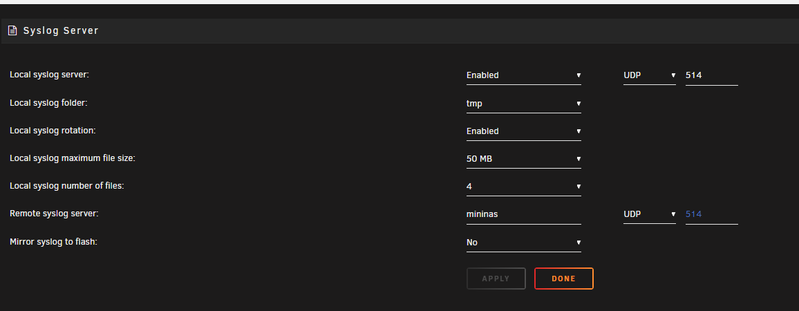

August 19, 20224 yr 3 hours ago, trurl said: setup syslog server I've already enabled syslog server but I have never found anything interesting about my problem. I've tried also to mirror syslog to flash suspecting that something was not written in time by the syslog server. The problem is that when the reboot occurs nothing is logged in the instant immediately before this event....
August 19, 20224 yr Author 4 hours ago, trurl said: setup syslog server 31 minutes ago, alexbn71 said: I've already enabled syslog server but I have never found anything interesting about my problem. I've tried also to mirror syslog to flash suspecting that something was not written in time by the syslog server. The problem is that when the reboot occurs nothing is logged in the instant immediately before this event.... Same thing for me as well. Syslogging to a second unraid server and there's nothing of note there. The logs just end when the shutdown occurs.
