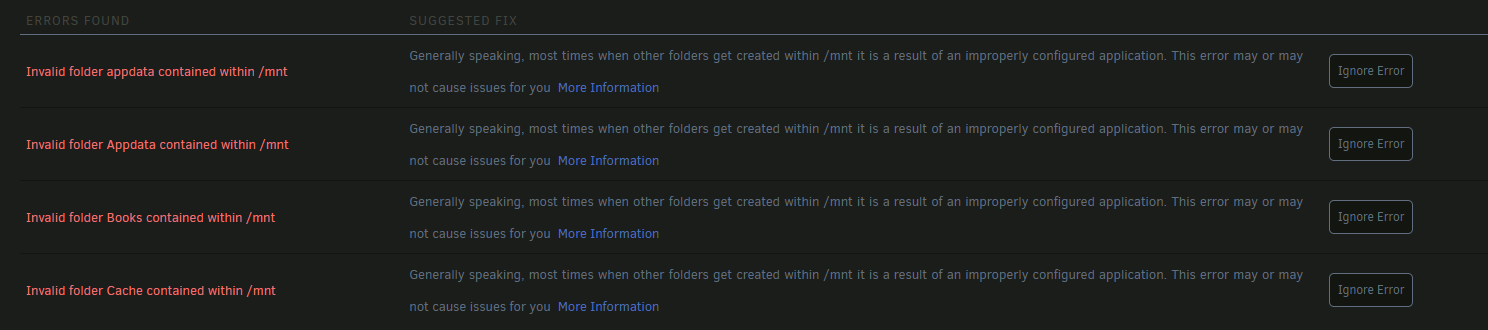

I don't understand that fix common problems error that refers to the "Books" share, as that existed previously and I made no changes to it.  Why would it throw an error now, but not previously?  I don't understand why I'm getting the other errors, but at least they refer to things that I've been screwing with...
User shares are at /mnt/user, such as /mnt/user/appdata.
It appears you have specified /mnt/appdata instead. Also you have apparently specified another as Appdata. Linux is case-sensitive so these are different.
And similarly, cache is mounted at /mnt/cache, but it appears you have specified /mnt/Cache instead, which is not at all the same.
Only mounted storage is persistent. If you specify /mnt/user/appdata, that is OK because /mnt/user is where the user shares are mounted, and so that is the appdata user share.
If you specify /mnt/cache, that is OK because the pool named cache is mounted there. There is no pool named Cache, and I don't think it will even let you create a pool with the first letter capitalized.
If you specify /mnt/appdata, or /mnt/Cache, there is no storage mounted there, so these paths are in RAM like all other OS folders. Anything stored there will not survive reboot. And even if you don't care if they persist, there is some danger that with these paths, you would fill rootfs, the space where the OS lives, and lots of things could break since the OS wouldn't have room to work with its own files.
/mnt/Books is not a user share named Books, it isn't anything except a folder in RAM. The user share named Books would be at /mnt/user/Books.
In what way do you mean it "existed"?
