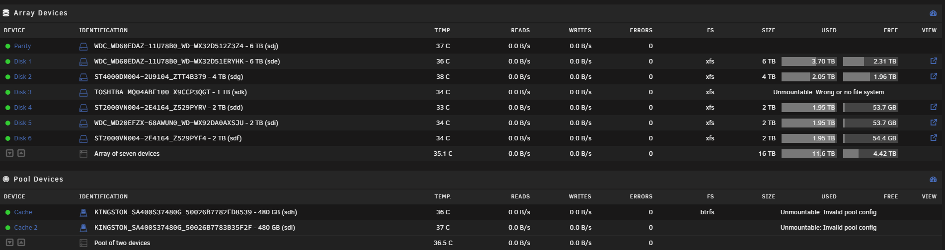

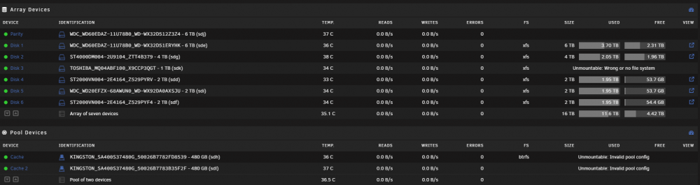

Now I tried stopping and restarting the array, and I've seen the cache disks appear in  format disk option and I can no longer access them as they appear unmountable with the message "Unmountable: Invalid pool config".
I've tried turning disk 3 to the xfs format but now i still see the disk3 and the cache ssds in the format option.
As I have some shares which are configured with cache yes or cache preffer I'm worried that a format may delete this data which includes appdata share which has a cache prefer option.
Can you please indicate what options I have to recover this data?

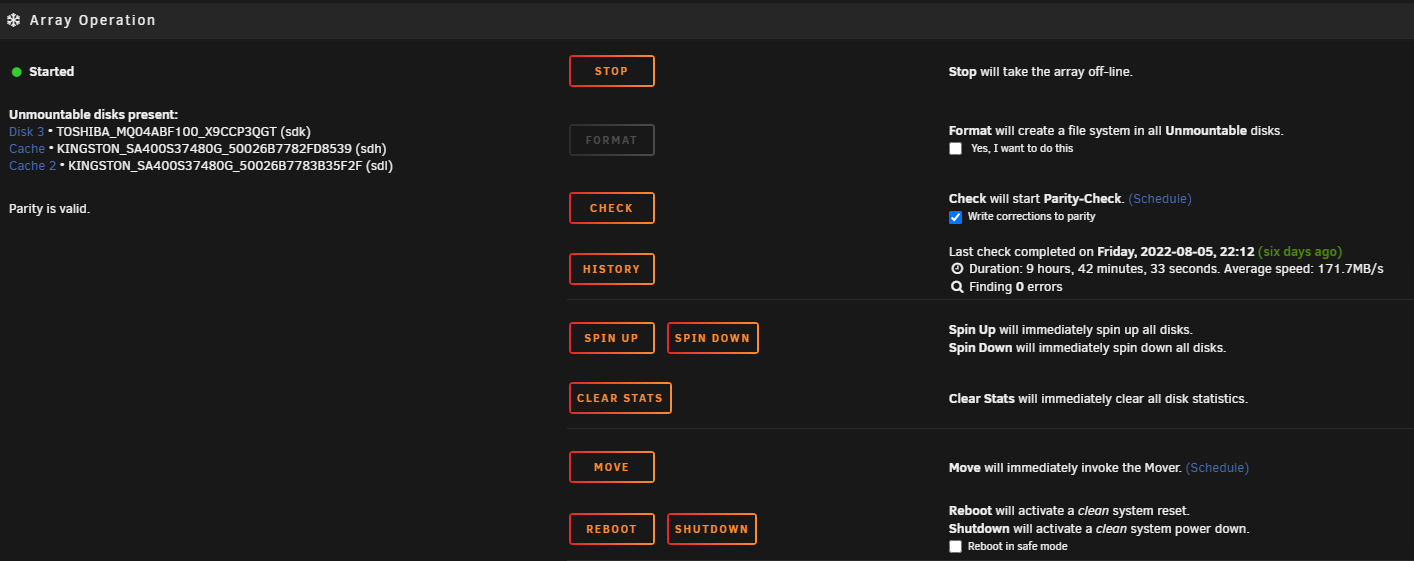

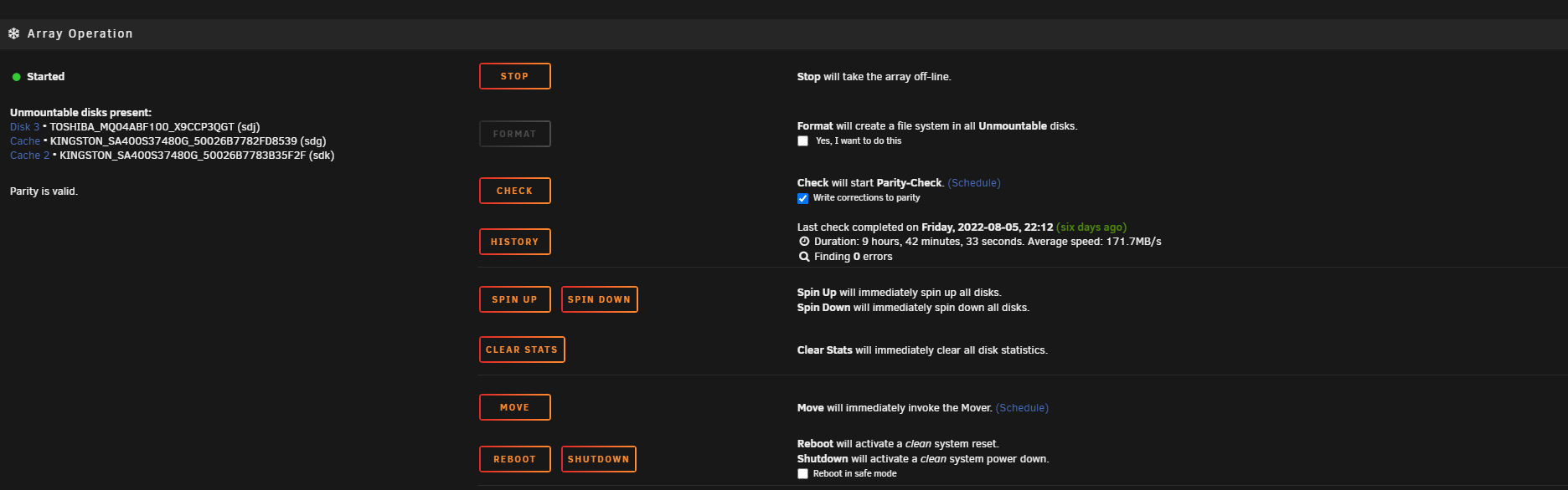

In the attached image, you can see the current array status with and the array operations

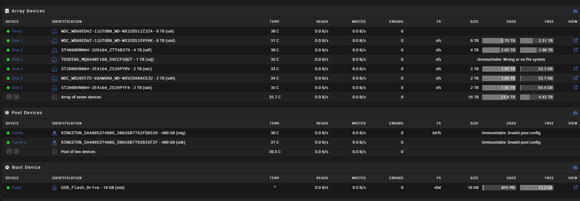

It's happening  because you had a single btrfs array drive, it's a known issue since it make parity appear to have an invalid btrfs filesystem, to fix:
-unassign both pool devices
-start array
-format disk3 using xfs
-stop array
-re-assign both cache devices
-start array, all should be good, if it isn't post new diags.

@JorgeB thank you very much
Now my cache is working, and I still have all my data
