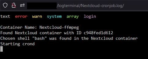

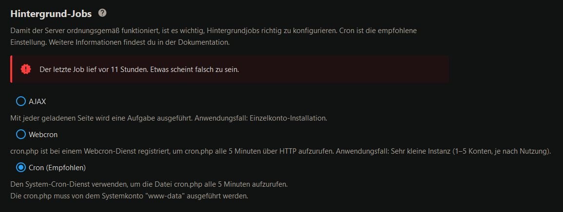

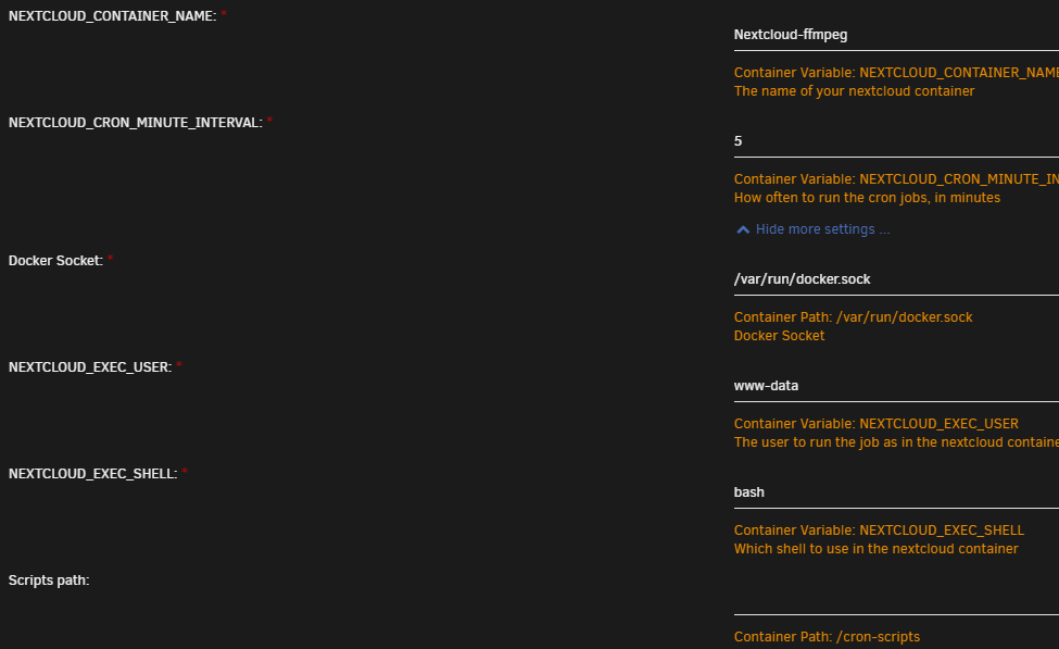

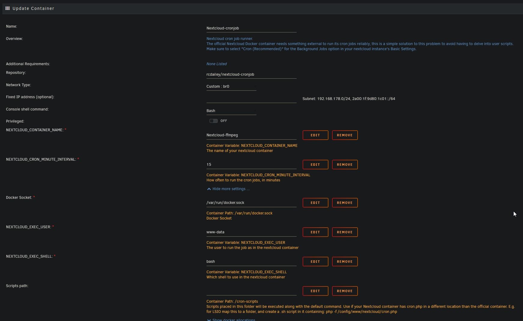

Kilrah Posted August 4 Author Share Posted August 4 (edited) 29 minutes ago, Gekko said: I installed the crontab using vanilla variables You still have the modified values, probably reinstalled form previous apps (which keeps your settings) instead of reinstalling from apps. Also check the logs of the cronjob container for pointers For the php values the container probably only handles what's needed. Upload size etc typically would not need being changed, if you have issues with those it's likely at the reverse proxy level. Edited August 4 by Kilrah Quote Link to comment
Gekko Posted August 4 Share Posted August 4 16 minutes ago, Kilrah said: You still have the modified values, probably reinstalled form previous apps (which keeps your settings) instead of reinstalling from apps. Thanks for pointing that out, i didn't expect there's a different behavior by doing that. Thanks! Regarding PHP, i'm sure, i can handle this involving the proxy, it was just an idea to place it with the extra parameters, but this is no crucial thing. So, i reinstalled the nextcloud-cronjob container with the parameters being *REALLY* fully vanilla, the log seems to be ok, still no luck at the backend. Quote Link to comment
Kilrah Posted August 4 Author Share Posted August 4 Did you wait 15 minutes after installing? Quote Link to comment

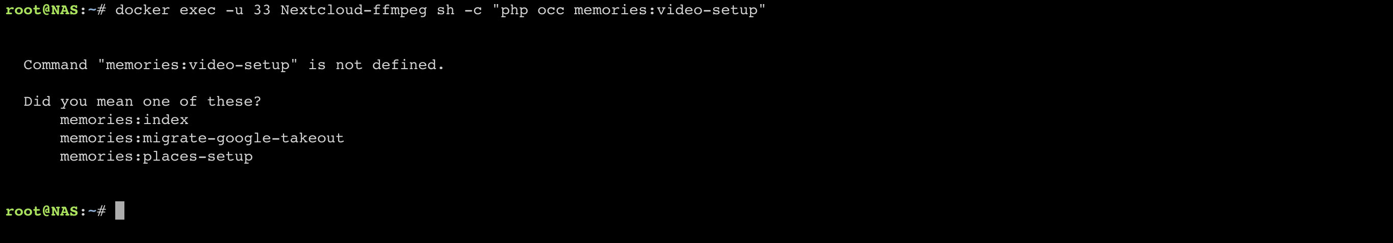

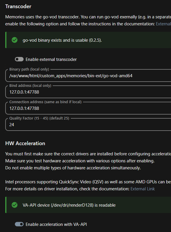

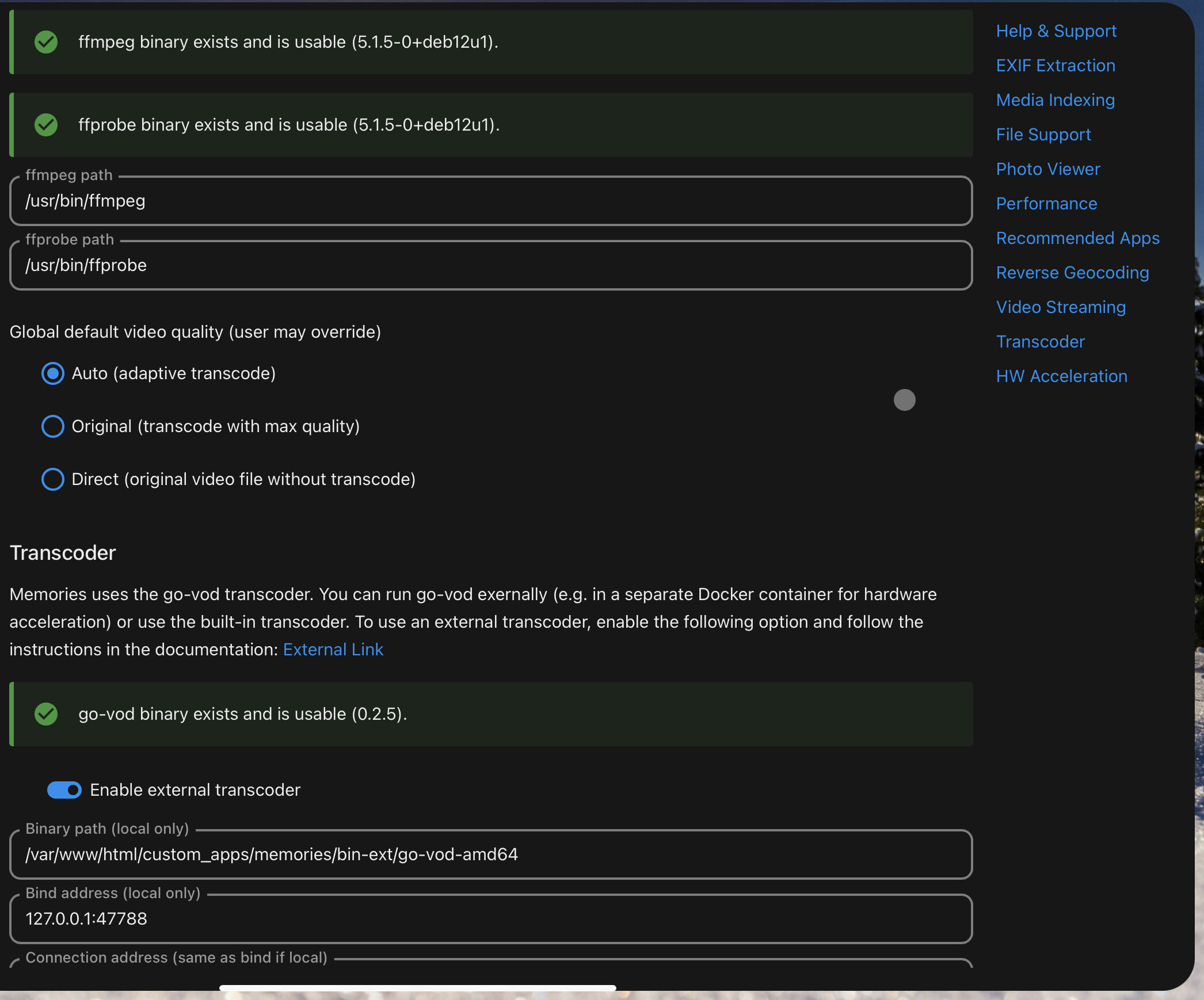

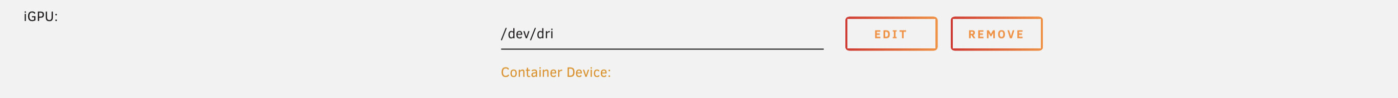

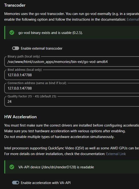

Connor19 Posted August 19 Share Posted August 19 I have sorted me previous issues out with transferring via WebDAV, the only issue I have currently is getting transcoding working on the memories app. I have Intel GPU TOP installed and have added /dev/dri as an extra device, this works great for Transcoding on Plex but I presume there’s some extra setup needed on memories, I have tried to type the video command in the terminal but it says its not defined so I am a bit stuck, do I need to edit anything on the memories setup page? Quote Link to comment
Kilrah Posted August 19 Author Share Posted August 19 Enable HW acceleration but NOT external transcoder (that would be if you have another container to do that) Quote Link to comment
Connor19 Posted August 19 Share Posted August 19 So I have done that and restarted the container, but when I click a video I just get a black screen with the swirling logo as if the video is loading but nothing happens Quote Link to comment
Kilrah Posted August 19 Author Share Posted August 19 And it shows HW accel being detected? What's in the logs? Quote Link to comment
Connor19 Posted August 20 Share Posted August 20 My Nextcloud logs just say “Transcode failed - Transcoder returned 408” Quote Link to comment
