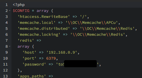

On 8/12/2022 at 4:00 AM, Kilrah said:
Performance tweaks
Using cache as appdata mountpoint
If you have an SSD cache and it is big enough to hold the appdata (up to about 2GB if you have the user data separate, depends on installed apps), it helps to set the Application data path to /mnt/cache/xxx instead of /mnt/user/xxx.
The template defaults to user for compatibility.
Using Redis
Using Redis for caching can improve browsing responsiveness pretty significantly.
I'm using the official container using the jj9987 template:
Install it, then add the following to your nextcloud config.php:
  'memcache.distributed' => '\\OC\\Memcache\\Redis',
  'memcache.locking' => '\\OC\\Memcache\\Redis',
  'redis' =>
  array (
    'host' => 'server_ip',
    'port' => 6379,
    'password' => 'redis_password',
substituting IP / password as necessary.

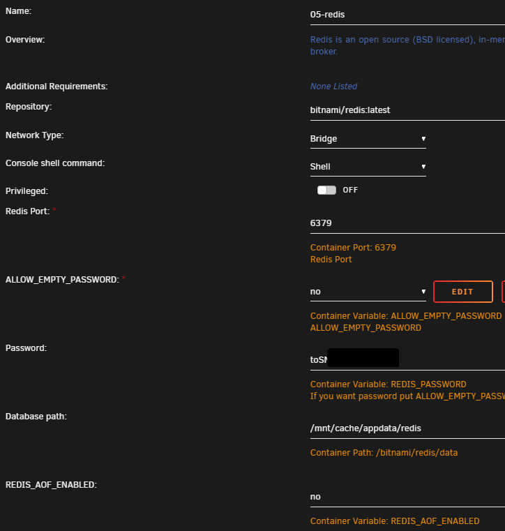

Hello again,
I have tried to install redis (docker) as you have i believe..
I installed the same container as you did here and didnt change anything, I pasted the text above and inserted my server address "192.186.0.5" for example and made up a password "Password01" for example.
Nextcloud would not start....
I then added  "redis-server --requirepass password" to the docker 'post arguments' as per suggestions in the quoted forum for redis...
Would you mind giving me a tip? what am i missing here...?
I just have the password set in the redis template and refer to that in nextcloud config, nothing special.
Interesting.. My Redis version does not have the same options as yours (i.e. Password) and i cant find bitnami/redis. where did you find this container?
Scratch the comment above.. I founf it by searching Bitnami and using the one that came up.
Im now going to try and follow instructions to on the below to install Chown............ gotta love the rabbit hole
Edited by Daver1
Nah im lost..... this is to far for me i think.
After installing redis i lose access to NC, I'm assuming this is because redis wont run, and I assume that is because i need to run chown -R 1001:1001
Did you have to follow that step? if so can you explain how?
No, my redis appdata has a single file owned by 1001 and it did that in its own AFAIK, never had to fiddle with it. If you changed container you may need to delete the redis appdata folder.
