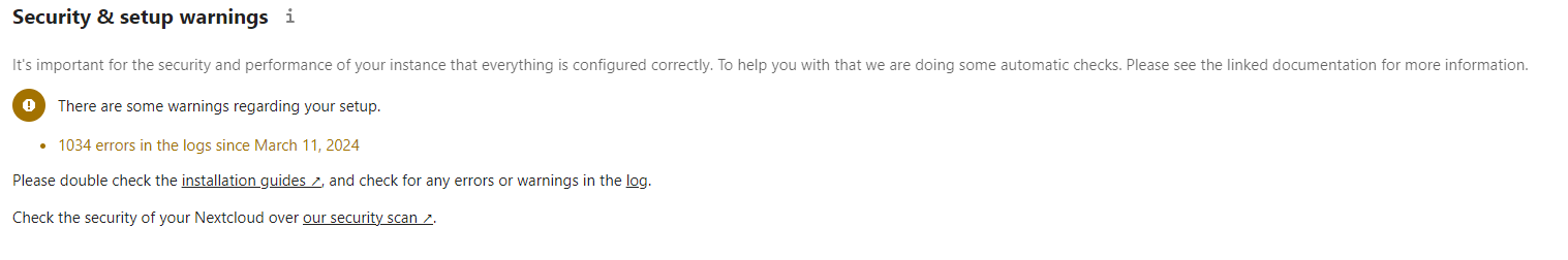

Ok, I have managed to get Redis working, clearly my lack of experience is slowing me down but with your pointers I am getting there...... Thank you.
Started fresh. Removed the latest install of redis + appdata. Cleaned up my nextcloud config (disabled maintenance mode)
1. Installed redis - bitnami repository.
2. Inside the docker container:
  a. Changed allow empty password to "NO"
  b. Changed the suggested password to "my_password"
  c. Applied changes to the docker container.
3. Opened unraid terminal and ran the below:
"chown -R 1001:1001 /mnt/user/appdata/redis/"
4. Started redis.
5. Added the below to my nextcloud config file:
  'memcache.distributed' => '\\OC\\Memcache\\Redis',
  'memcache.locking' => '\\OC\\Memcache\\Redis',
  'redis' =>
 array (
    'host' => '193.166.0.4',
    'port' => 6379,
    'password' => 'my_password',
6. Restarted nextcloud.
It would seem that my nextcloud had gone into maintenance mode while i was mucking about.. after disabling maint mode and performing the above all is well.
I also updated my NC instance as suggested recently, by running ( docker exec -u 33 Nextcloud-ffmpeg sh -c "php occ upgrade" )
During the upday there were some crazy logs hence the big number - otherise all my errors and warnings are gone! :dancing:
