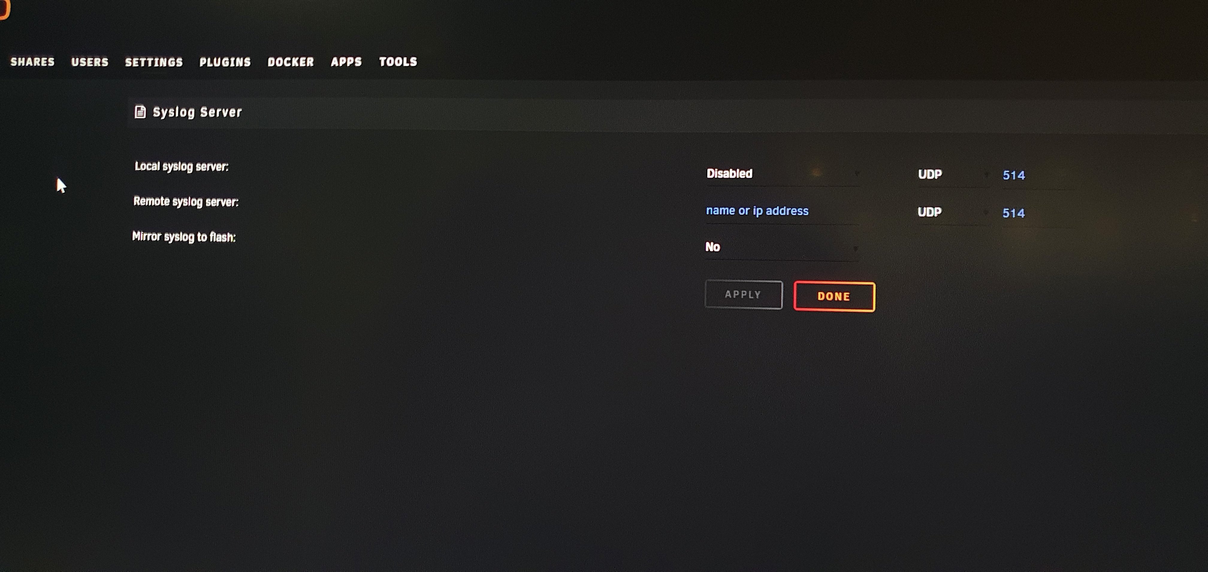

August 16, 20224 yr Community Expert You should also consider setting up the syslog server so you can get logs that persist across a reboot.

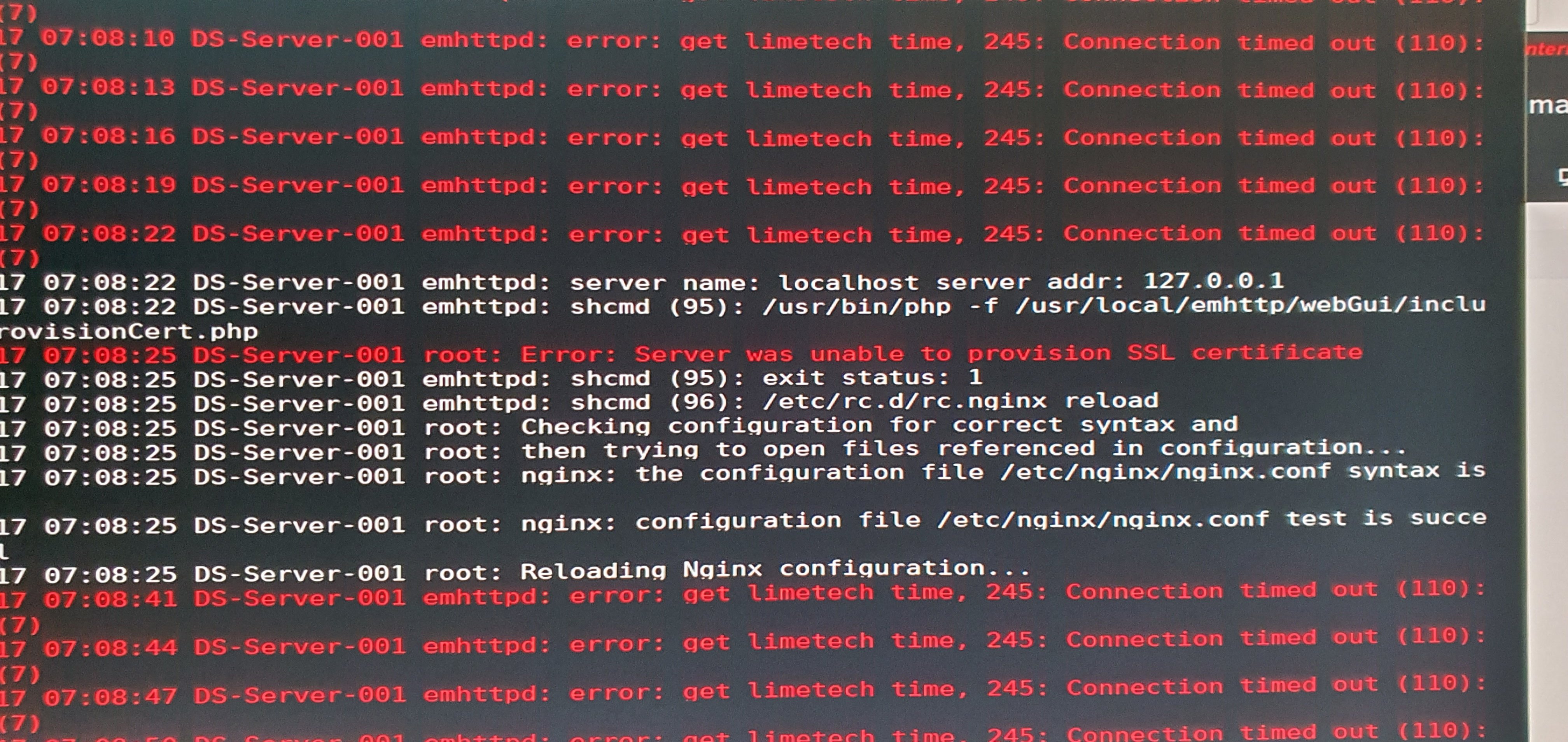

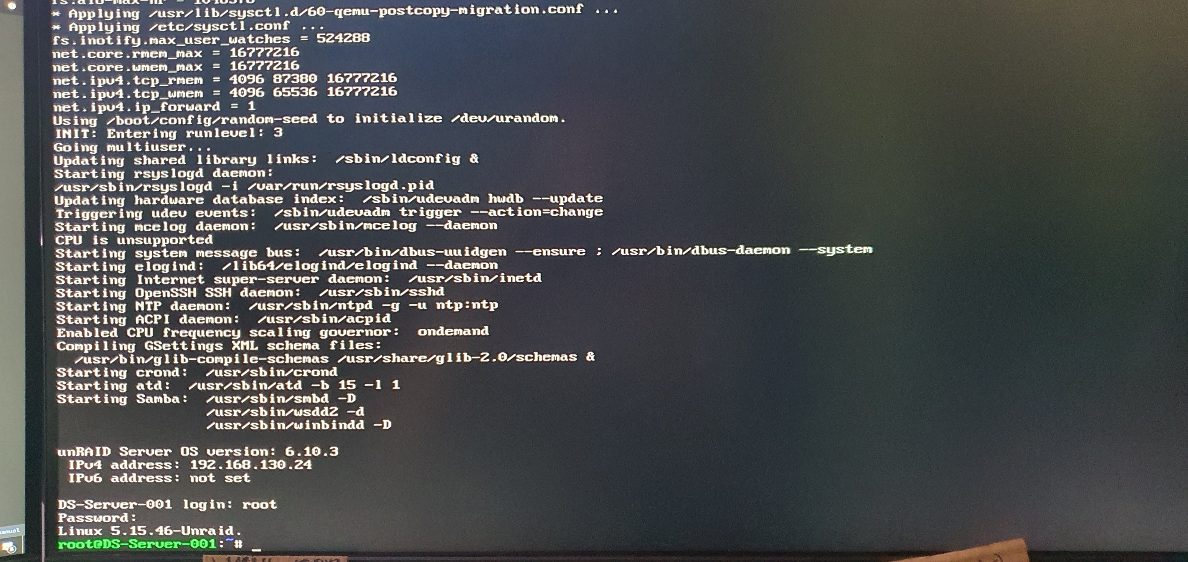

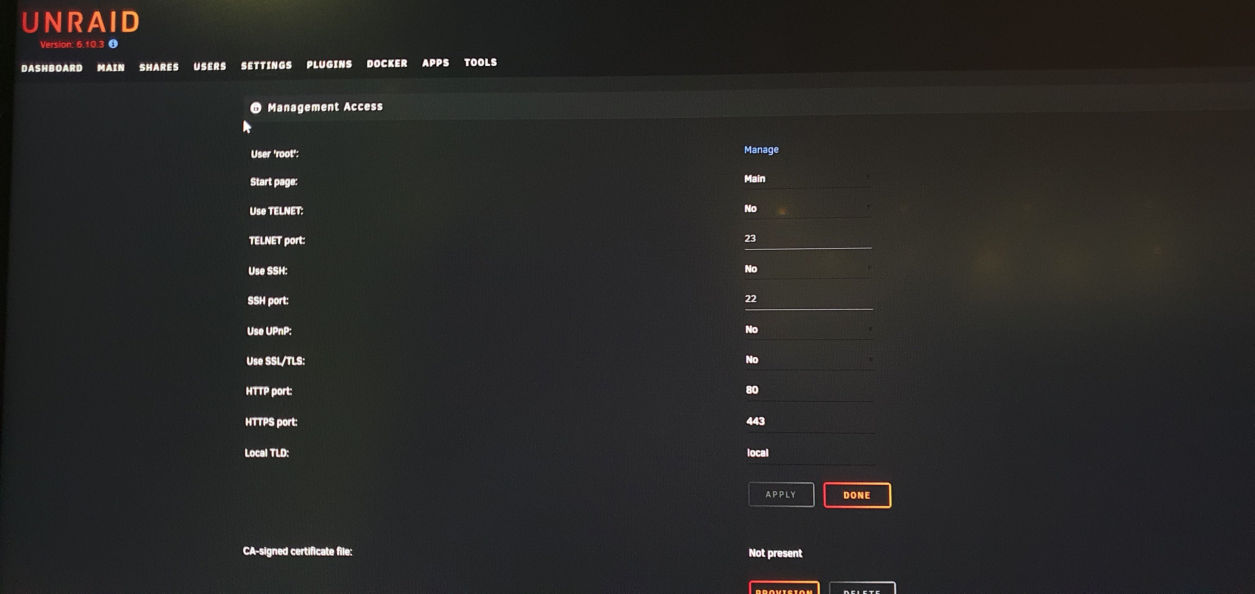

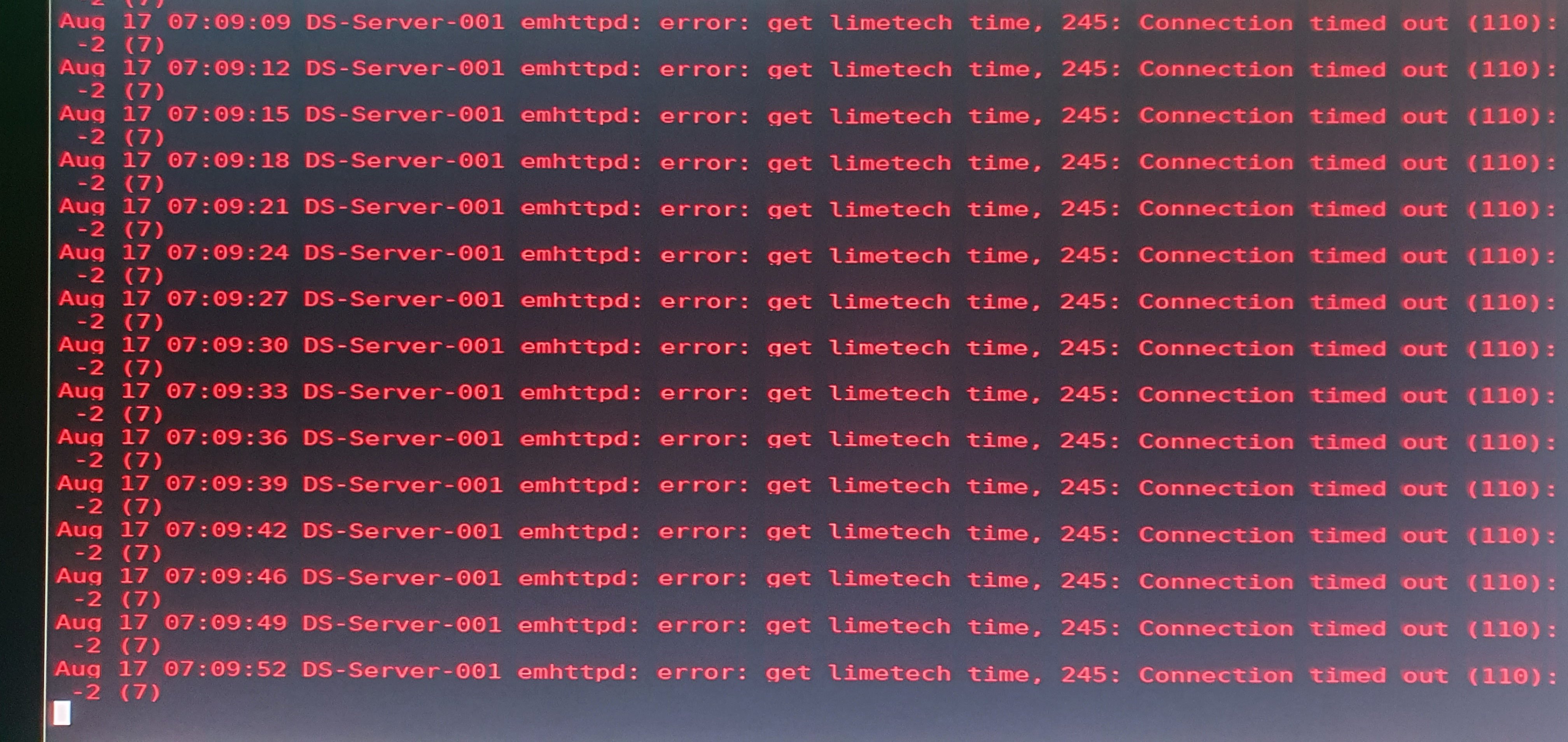

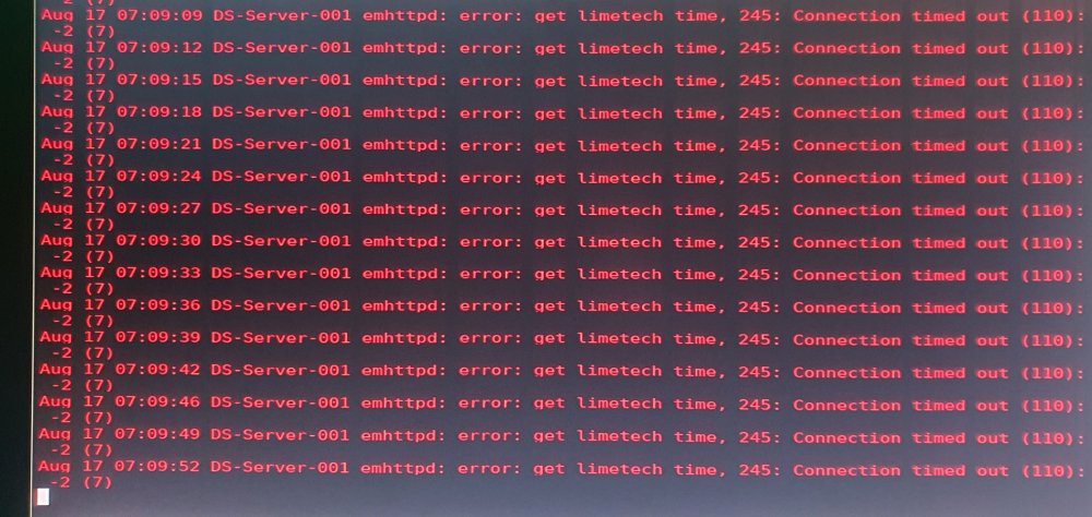

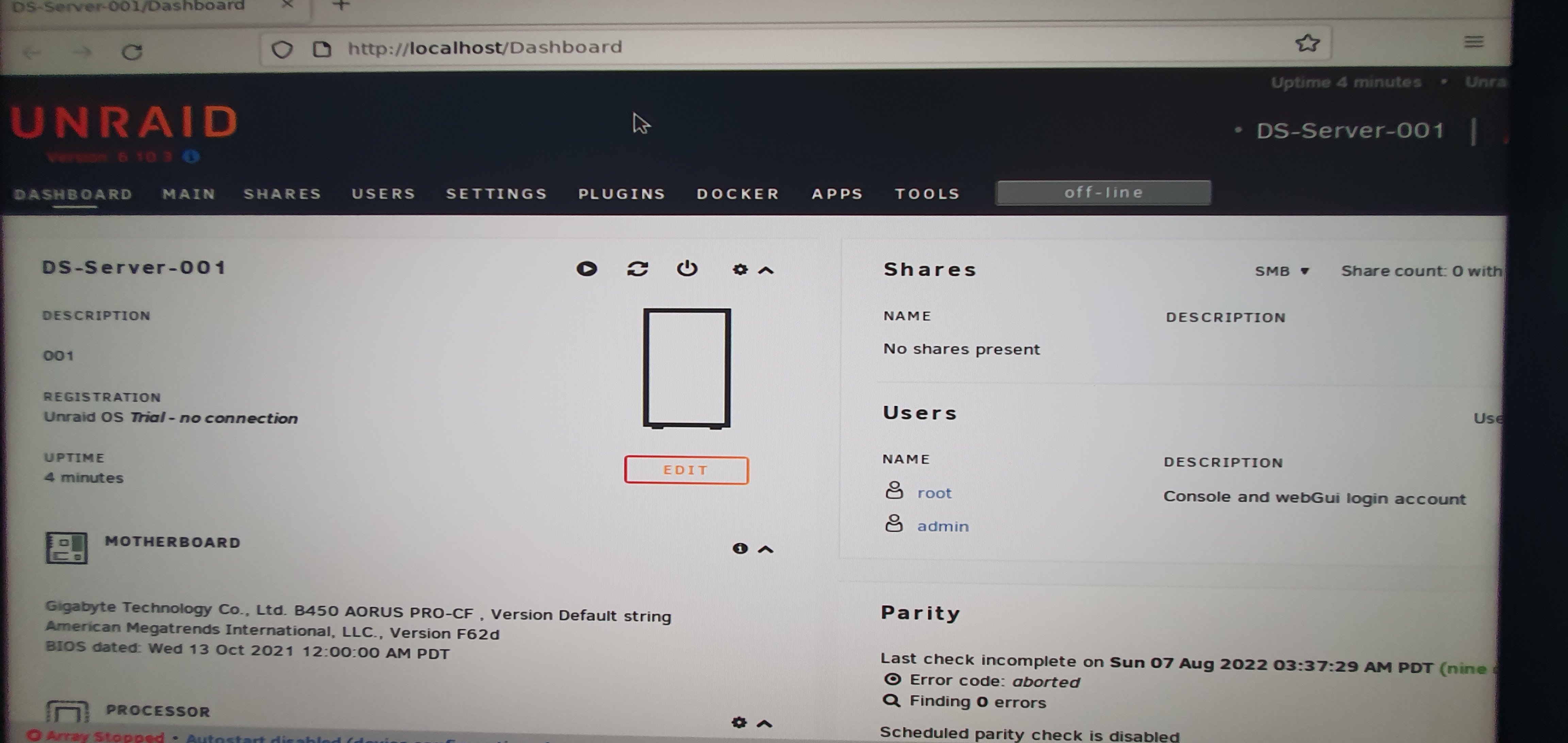

August 18, 20224 yr Author On 8/17/2022 at 1:50 AM, prostuff1 said: 2 things to check since this is a Ryzen system: 1. Disable global c-states in BIOS 2. If you have sleep enabled for the system disable that. Thank you! I ensured that C-States are disabled (seems like resets defaulted BIOS and turned C-Stated back on) and no restarts since. Fingers crossed. However I ran into another issue and decided to start everything all over with a new pendrive. Despite the computer having internet connection working. I couldn't get connection on my server (myserver worked) and start an array. Also noticed that it takes a few minutes to establish internet connection in the first place. Which was instant before. Here is captured what I saw; Is there a limitation about how many Unraid instances on a pendrive is allowed, using myserver and an online account, when using trial version? I can't get any connection with the Unraid now. Not even via myserver. Edited August 19, 20224 yr by Digital Shamans Adding more info.

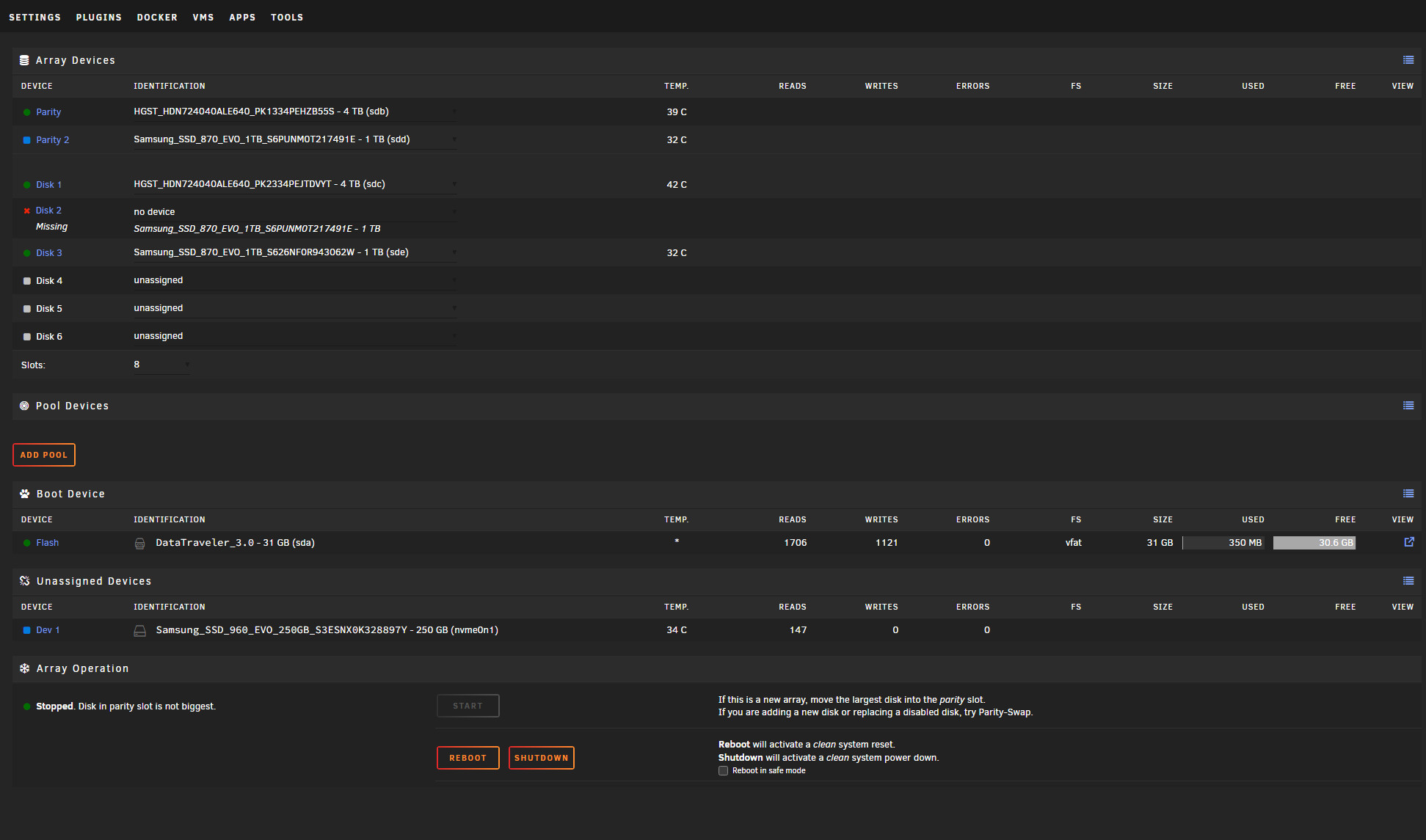

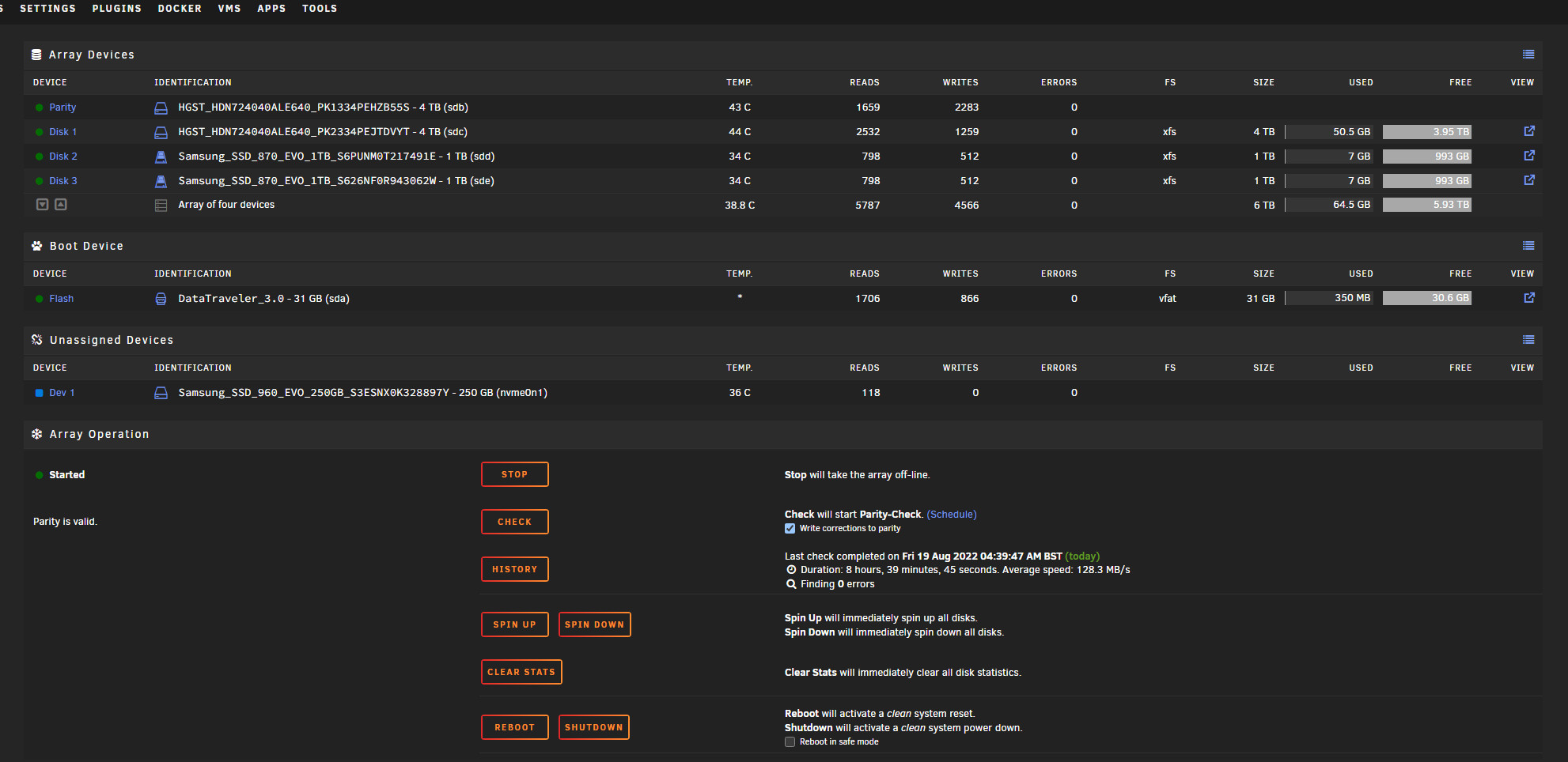

August 19, 20224 yr Author On the new instance of Unraid things work well. I can't login to webGUI, so I don't use it and control it via myservers. I try to figure out how should I configure my drives. Having two 4TB HDDs, two 1TB SSDs (and another M.2 SSD for cache coming soon), one of each (HDD and SSD) I would be used for parity. This may be called dual parity. I wonder if I shouldn't use one of the 1TB SSDs as second parity drive, to effectively have 5TB and control what goes on which physical drive via shares. How one can move a drive from disk to parity without having problem of missing drive? Edited August 19, 20224 yr by Digital Shamans
August 19, 20224 yr Community Expert 2 hours ago, Digital Shamans said: I wonder if I shouldn't use one of the 1TB SSDs as second parity drive, to effectively have 5TB and control what goes on which physical drive via shares. This is not possible. No parity drive can be smaller than the largest data drive. it is normally recommended to NOT have SSDs in the main array as when configured there they cannot be trimmed which means their performance may degrade over time. Depending on what you want to use the SSDs for you may be better having them in a (possibly redundant) pool external to the main array. This is not atypical if they are going to be used with VMs or Docker containers. it is probably worth getting to the bottom of why you cannot connect to your server locally. Have you tried via it’s IP address? Have you tried using http rather than https?
August 20, 20224 yr Author Thank You Itimpi for the reply. It reassured me about putting 4TB HDD as the parity drive, the other 4TB HDD as a disk in array and remaining two SSDs in Raid1 in cache pool. I dont know what caused connection issues. Looked like possibly something on your side. I could connect to the server in local network using myserver but there was no connection to the unraod server for my trial license to work. It doesnt matter now as I have made a fresh Unraid on a new pendrive. The previous one stopped working.
