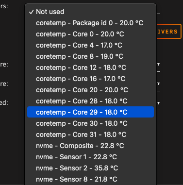

3 minutes ago, recreational-regulation8230 said:
Hi, i have got to the terminal commands posted above now trying this:
systemctl restart lm_sensors.service
displays command not found?
try  /etc/init.d/lm_sensors start or /etc/init.d/lm_sensors restart, or just reboot the system
rebooted but nothing changed. Will not detect driver
What happens if you open a terminal and just write sensors does it show anything?
Afterwards can you run sensors-detect and run through it and then reboot?

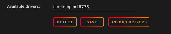

ok did sensors detect now in system temp i get this, still does not look correct
now just unloaded drivers the click on detect,load drivers and the above vanished now
Actually you saw the driver name now and that means it did load and its working. Now you need to start to configure Dynamix. Downside with this is that a motherboard and cards have a lot of temp sensors :( so it takes time and fiddling to get it just right.
In short: you did get it working!

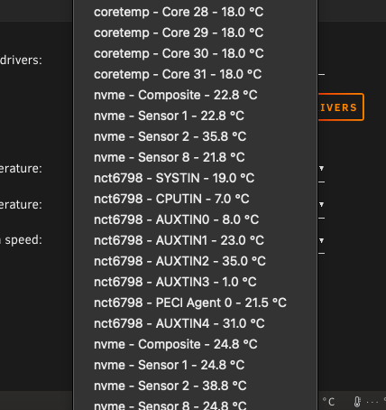

4 minutes ago, recreational-regulation8230 said:
Thank you for your help but how do you find which sensor to use?
nearly every sensor is between 10-12c seems low to me ok not doing anything
googling comes up with:
The nct6775 driver is associated with the Nuvoton NCT6798D Super IO Sensors chip, which is used on ASRock Z690 Extreme motherboards to control temperature sensors. The temp7 sensor is specifically mapped to the CPU temperature in the lm-sensors configuration.
i have no sensor 7 on the drop down list

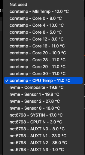

First some questions:
- Which CPU do you have?
- Can you run sensors and post here?
- Can you grab a screenshot again from the System Temp settings page with all the options in the drop-down menu?
Intel Core i5 12600K
coretemp-isa-0000
Adapter: ISA adapter
MB Temp:      +12.0°C  (high = +80.0°C, crit = +100.0°C)
Core 0:        +8.0°C  (high = +80.0°C, crit = +100.0°C)
Core 4:        +8.0°C  (high = +80.0°C, crit = +100.0°C)
Core 8:        +5.0°C  (high = +80.0°C, crit = +100.0°C)
Core 12:       +7.0°C  (high = +80.0°C, crit = +100.0°C)
Core 16:       +8.0°C  (high = +80.0°C, crit = +100.0°C)
Core 20:       +9.0°C  (high = +80.0°C, crit = +100.0°C)
Core 28:      +11.0°C  (high = +80.0°C, crit = +100.0°C)
Core 29:      +11.0°C  (high = +80.0°C, crit = +100.0°C)
Core 30:      +11.0°C  (high = +80.0°C, crit = +100.0°C)
CPU Temp:     +11.0°C  (high = +80.0°C, crit = +100.0°C)
As an update, i watched awhile ago a spaceinvaderone on youtube, he used the same motherboard i have, just a different cpu above mine. Be interested to know if he got it working, no idea how to get in touch.
First had time to check this now. However, looking through the https://github.com/petersulyok/asrock_z690_extreme/blob/main/Z690_Extreme.conf and the names you get from sensors command, it looks like the configuration file didn't get loaded because the command I gave didn't download the file, but the html page.
So what you need to do now is the following:
Hi again,
done the above and did the sensors detect also:

The drop down in system temp settings seems to be no different.
Did you try to do it without running sensors detect?
Yeah, then I think you need to maybe contact the GitHub maintainer, as a new/fixed conf file would be needed.
Only last thing I can think of is maybe rights on the file. You could copy the rights from the existing sensors file to the GitHub file using chmod --reference=sensors.conf Z690_Extreme.conf
