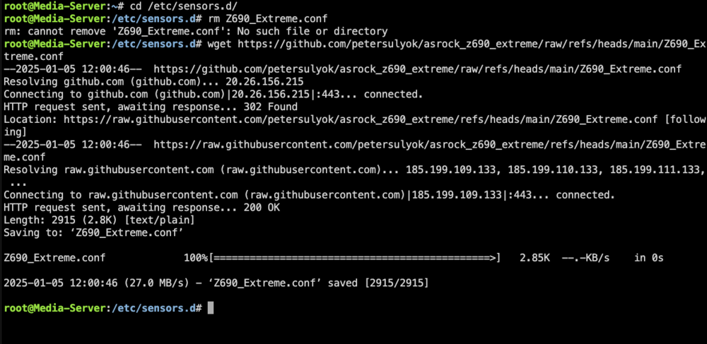

Okay, so it never go downloaded either.

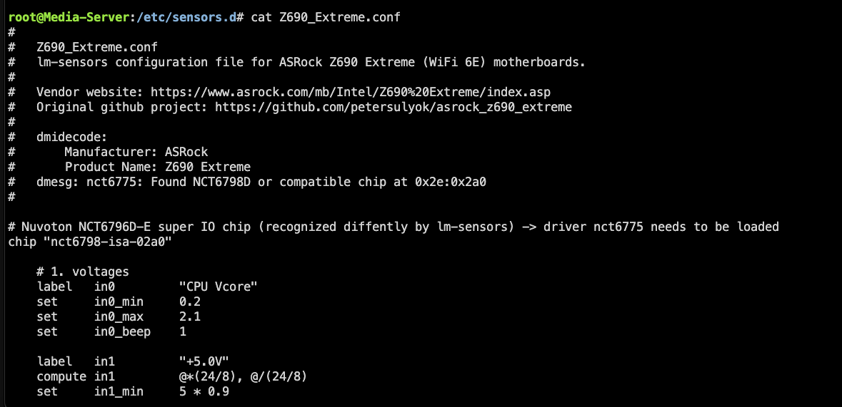

  • Open a Terminal
  • Type and run cd /etc/sensors.d/
  • Type and run rm Z690_Extreme.conf
  • Type ls to check that only the file sensors.conf is there
  • Type and run wget https://github.com/petersulyok/asrock_z690_extreme/raw/refs/heads/main/Z690_Extreme.conf
  • Type ls to check that only the file sensors.conf and Z690_Extreme.conf are there and grab a screenshot too
  • After type cat Z690_Extreme.conf and grab a screenshot again.
  • IF you see both files and if the cat command shows something like below, you should be okay and you can reboot, and test again.

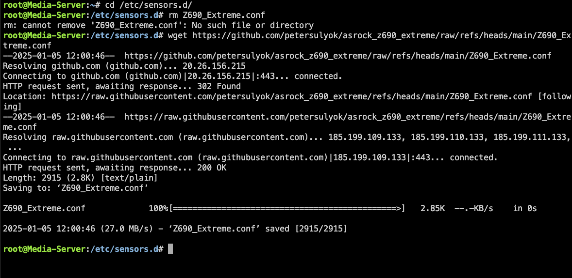

2 minutes ago, recreational-regulation8230 said:

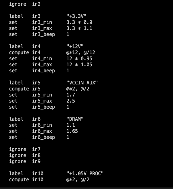

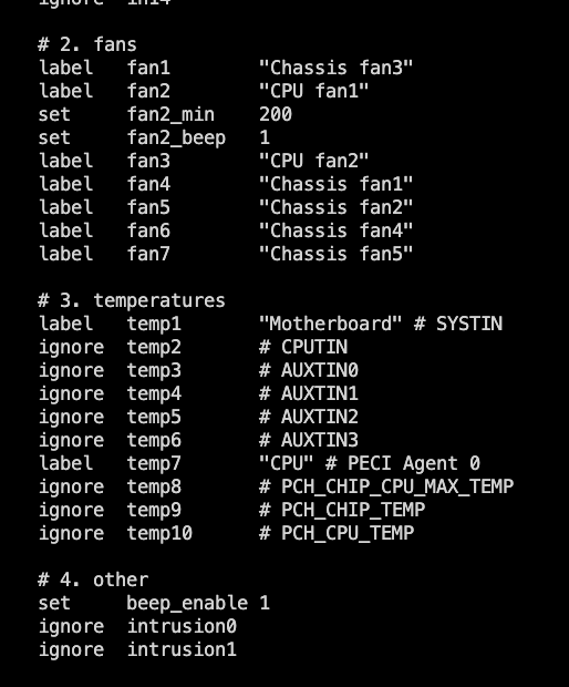

looks like it downloaded the file. now run the ls and cat commands to validate everything is there.
3 minutes ago, recreational-regulation8230 said:
ok this is the screenshot
looks like everything is downloaded
