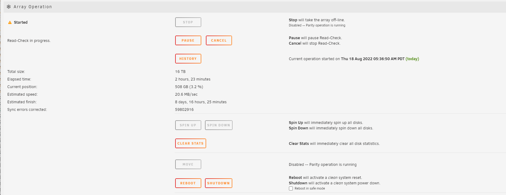

August 18, 20224 yr The OS USB stick went bad and took out disk 22. When I try to re-build disk 22 it eventually fails and starts a read-check. Read check is running and counter of sync errors corrected is in the millions and going up. Is my parity drive bad and I will lose whatever I had on disk 22? Any advice is more than welcomed oohwee-diagnostics-20220818-0745.zip
August 18, 20224 yr Community Expert Some of your description doesn't make sense. Post a complete screenshot of Main - Array Operation

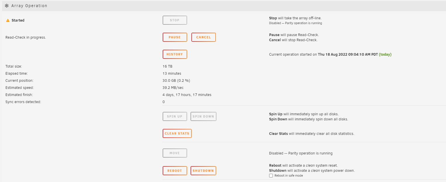

August 18, 20224 yr Author 2 minutes ago, trurl said: Some of your description doesn't make sense. Post a complete screenshot of Main - Array Operation

August 18, 20224 yr Community Expert 26 minutes ago, trurl said: Some of your description doesn't make sense. Why does screenshot say read-check was correcting sync errors?
August 18, 20224 yr Community Expert 1 minute ago, trurl said: Why does screenshot say read-check was correcting sync errors? It should say read errors.
