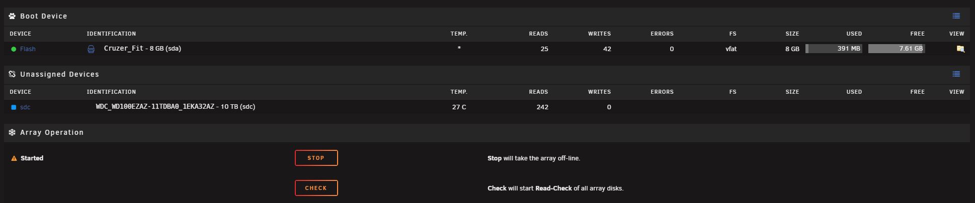

Set disk4 to not assigned, start the array, then post new diagnostics. And a screenshot of Main - Array Devices, be sure to include the full width

Emulated / missing disk4 is mounted but empty. All other disks are very full (not recommended).
Is it expected that disk4 is empty? Did you format it?
Is the disk that was assigned as disk4 in your earlier screenshot (serial ending 32AZ) the original disk4?
Waiting on a reply. Don't do anything without further advice

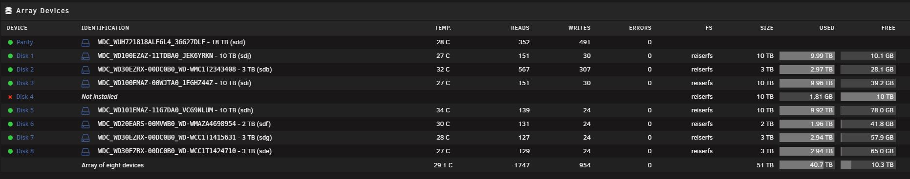

Post a screenshot of Array Devices
Since parity is invalid you'll need to do a new config to re-enable disk3 and re-sync parity.
